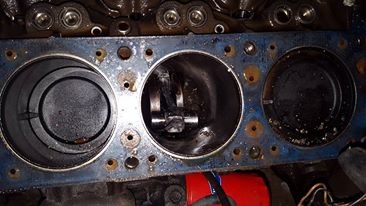

Well to start the year out i made a pass of 11.32@123mph. Which was amazing btw. But after that i was just idleing the car and there it went. I literly shattered a piston like glass. So that killed my 3.1/3100 engine.
So now im on my way to go E85 and have a high compression engine with low boost. The heads are 3400s gen3, the block is a 3.4L gen 1 block. The pistons are 3.4L gen1 pistons, Moly rings, I did open up the ring gap a touch as the prevous owner had them tight, i assumed for a NA build. Doing all the math over and over Im going to have a good .042 quench, but thats important because the Static Comp Ratio will be 12.68:1 Not too bad when your running E85 but im also going to toss some boost at it. Not the normal 15psi like I was but lower such as 8-12psi or basically what ever it can run and stay away from KR.
The block I have was from a member on here, and it was put together very well. All new bearings all arround and freshly honed out with new rings, but i tossed molys in there and rehoned it again as i wanted to be sure we were good to go as he said the motor sat for quite some time.
I still need to do a good test to see the P2V clearance. That is very important.

carnage
carnage
