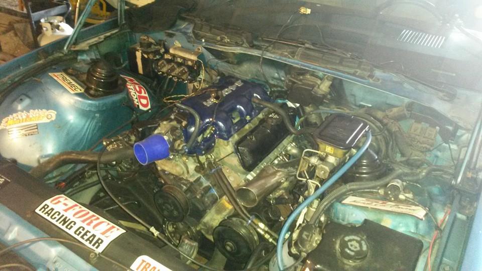

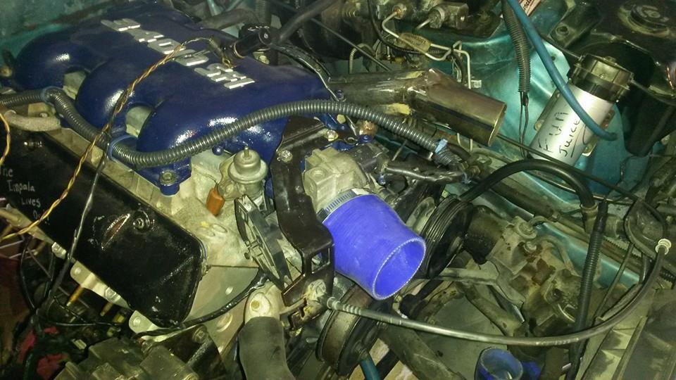

    Updates. I got a throttle cable, works good, almost too long like you guys said but the pull is nice and smooth from in the car.
    Got a radiator over the weekend that has the correct in and out positions and mounted that and the external trans cooler.

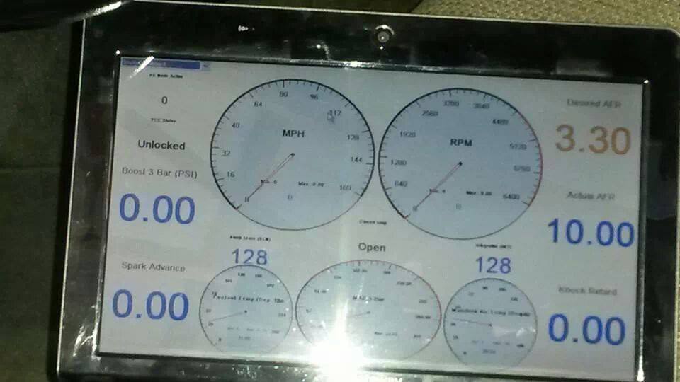

    I hooked up the fuel lines and checked for leaks while the fuel pump was primed. No leaks and held good pressure. I also checked to make sure each one of the sensors i extended worked on tunerpro and they do.
    Im still unsure if the tv cable will reach or not. Tad cold out to crawl under the car for that task over the past weekend. I have a nice big garage but its got a stone floor and is uninsulated... Anyone run a 7004 with this set up and have any insite on what i may run into?
    Heres my list of things to do still:
    Finish the merge pipe and weld in the wastegate flange
    Notch my reluctor wheel/mount the cps
    Hook up the vac lines and block off the egr.
    Get the alt mounted and make a bracket for it so that it can be adjusted to the proper tention.
    Toss the trans and hopefully that cable will fit.
    And also tap that hole next to the T stat housing for my single wire coolent sensor for my stock guage. For some reason I dont have a 1/2 inch tap. Have the bushing though.... Just my luck.

            Stock TV cable isn't going to work for sure with that cable bracket. I don't know of one that's long enough.
            I used a LS1 75mm TB on mine which was set up to pull to the rear, even then i had to make a custom bracket for the throttle and TV cable to work. I also had to make my own arm and weld it to the TB to get the correct pull on the TV cable, then use parts from a throttle cable kit. Was a pain in the ass.. lol
