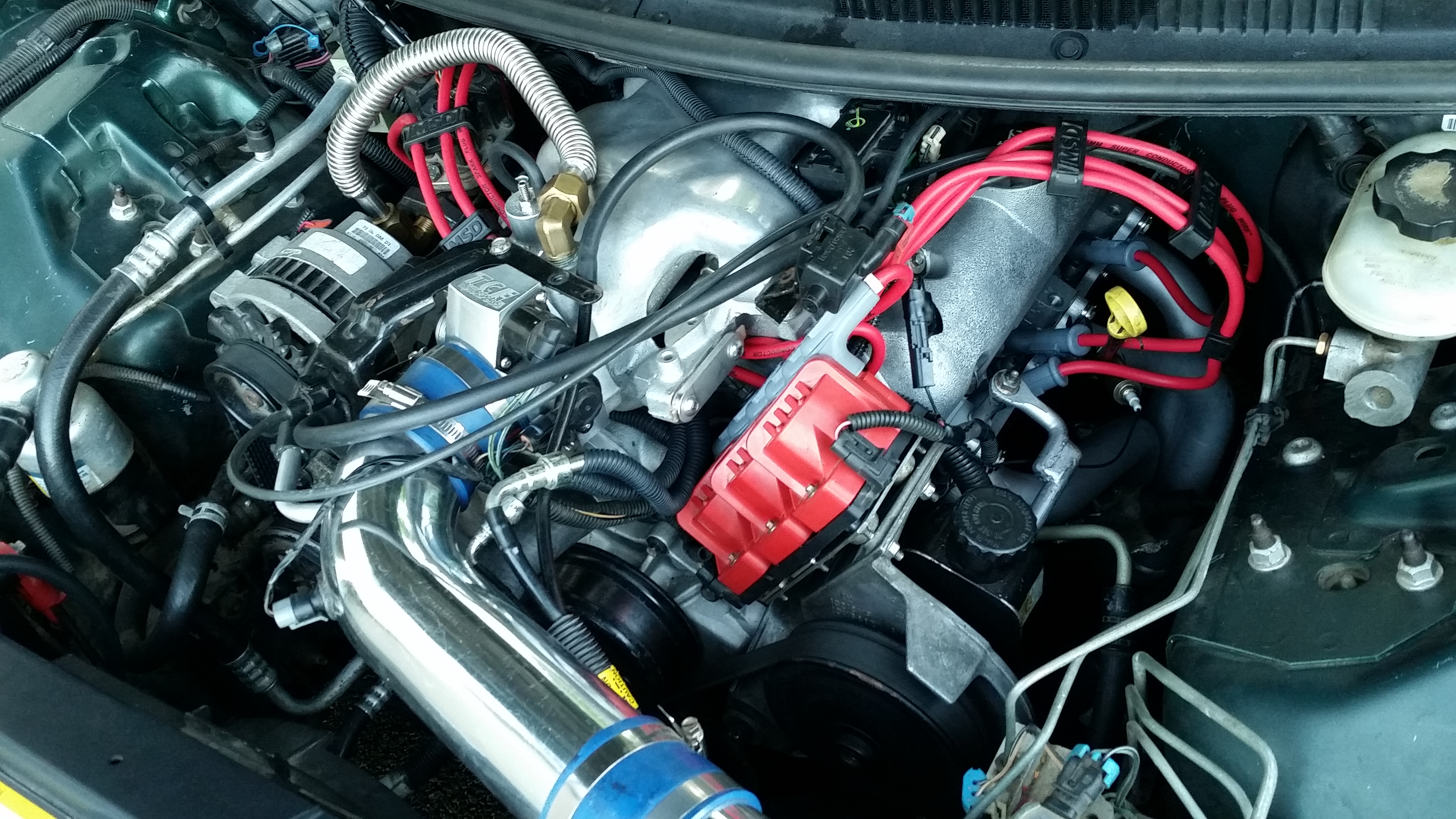

After all these years I finally have a successful 3.4/3500 hybrid setup. The first time I did this was with the 3.4 Camaro pistons, 11.5 compression, and megasquirt. I never could get that engine to run right as it would cough, stumble, and stop running. It could have been incorrect sized pushrods, too much compression, bad tune, or maybe even an electrical issue, but we will never know.

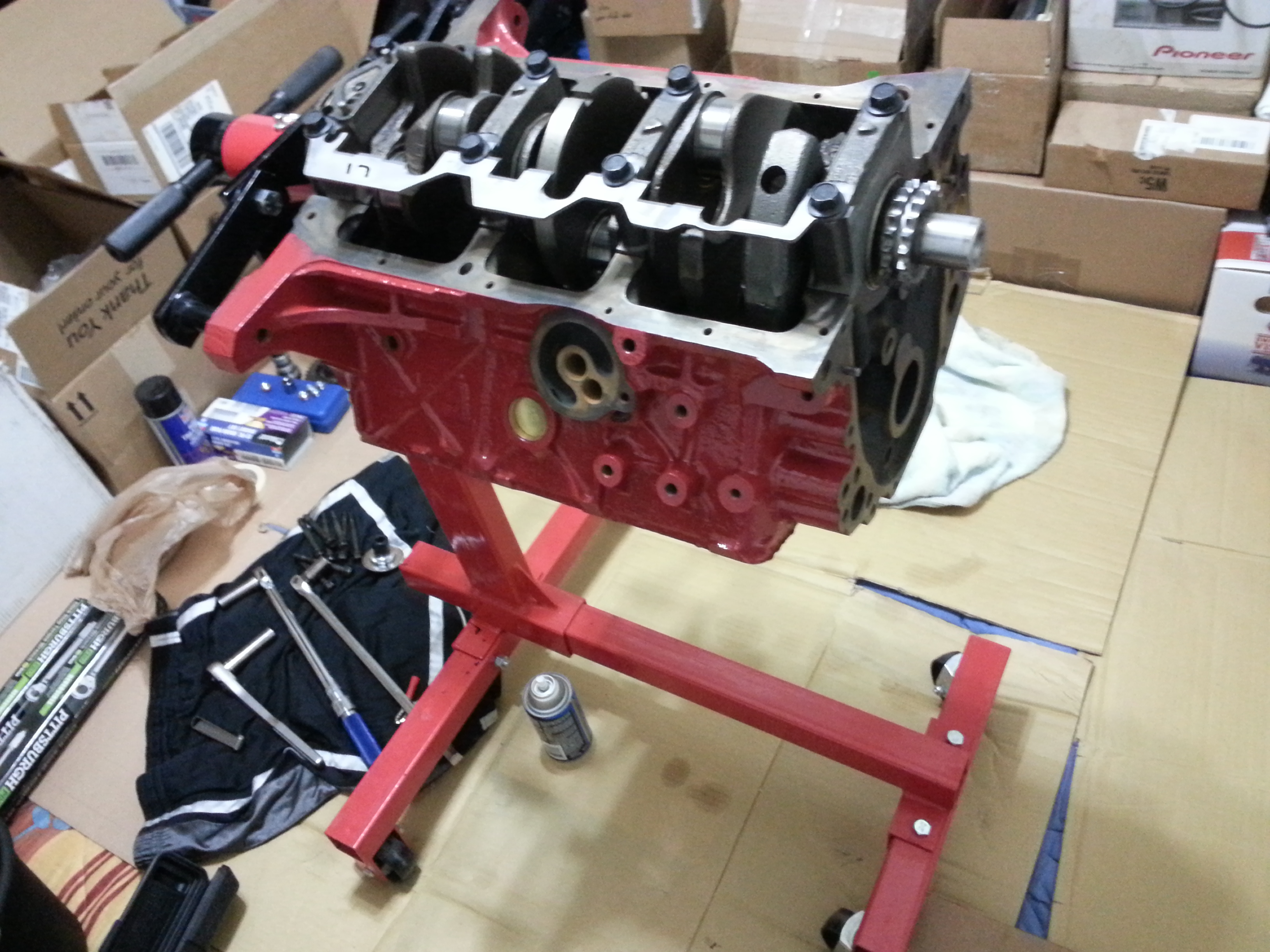

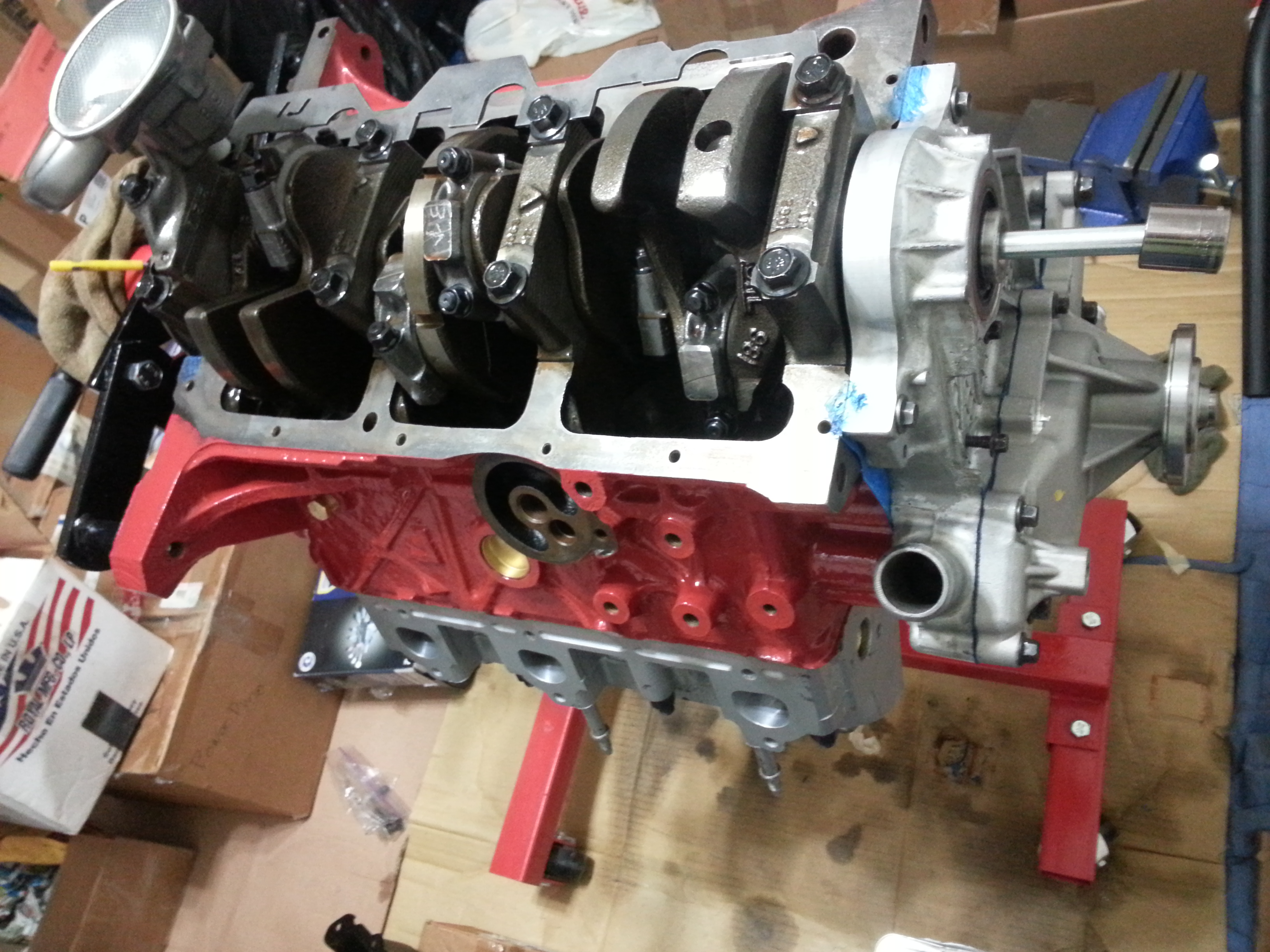

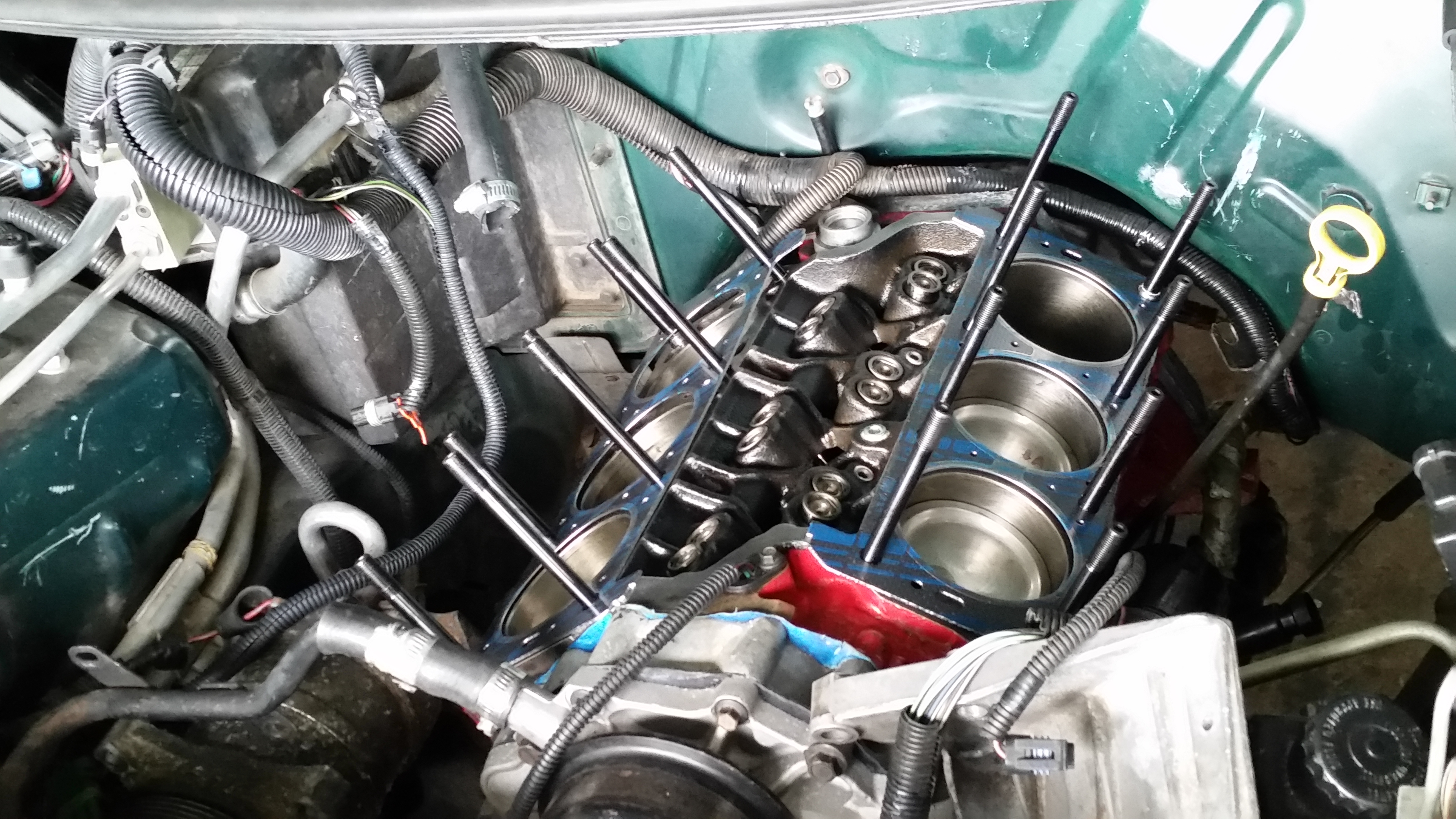

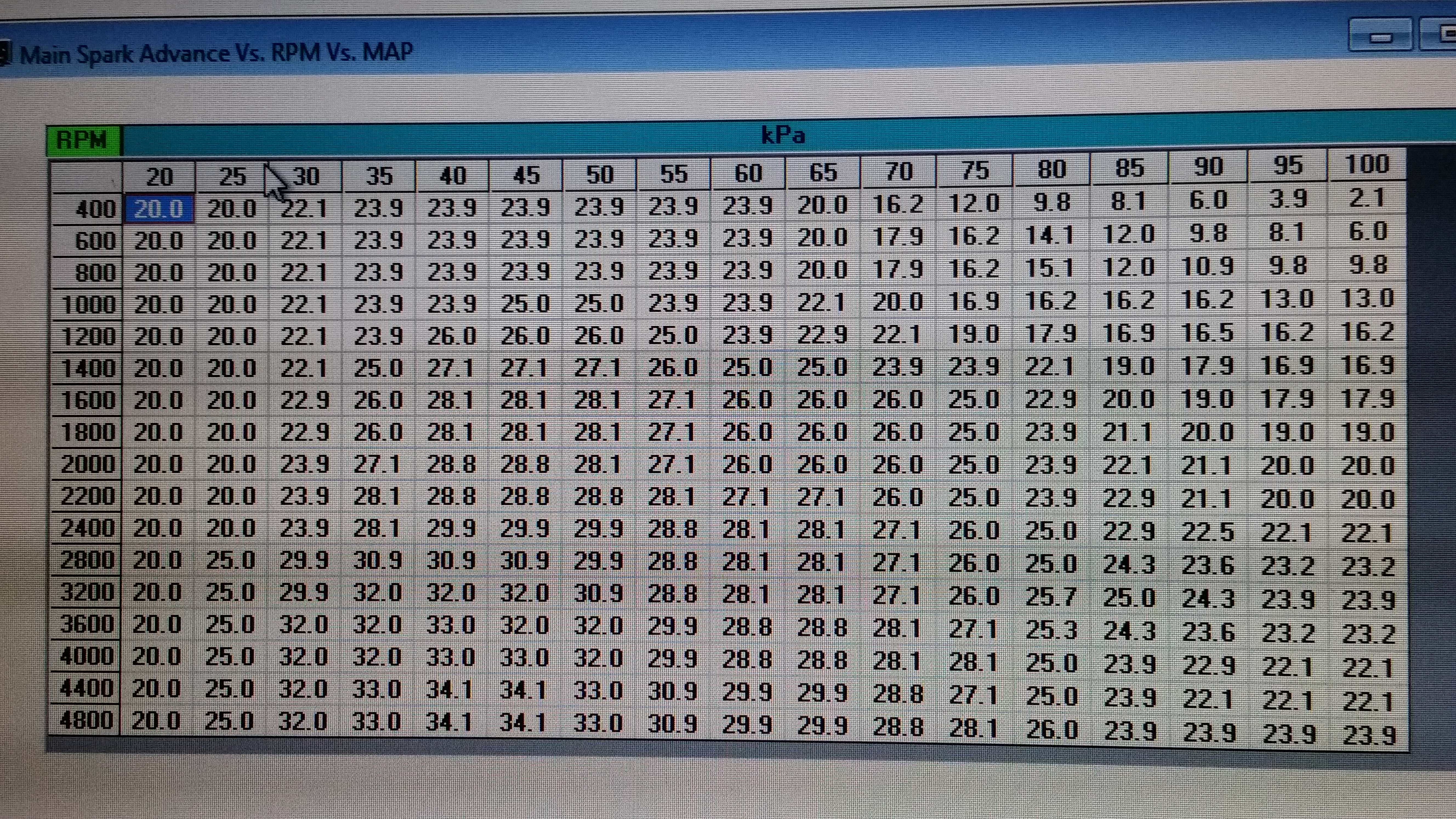

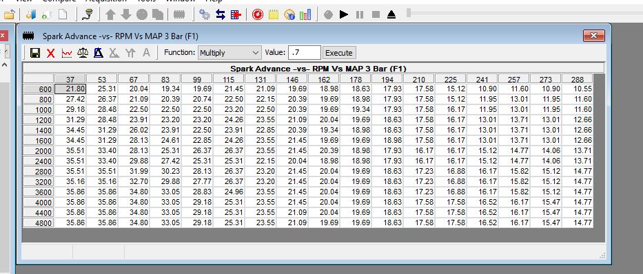

This time around I did a complete engine rebuild with 3400 pistons. Engine runs well, but I need some help with tuning. Is there anyone that's already been tuning an NA 3.4/3500 that wouldn't mind sharing their spark tables?

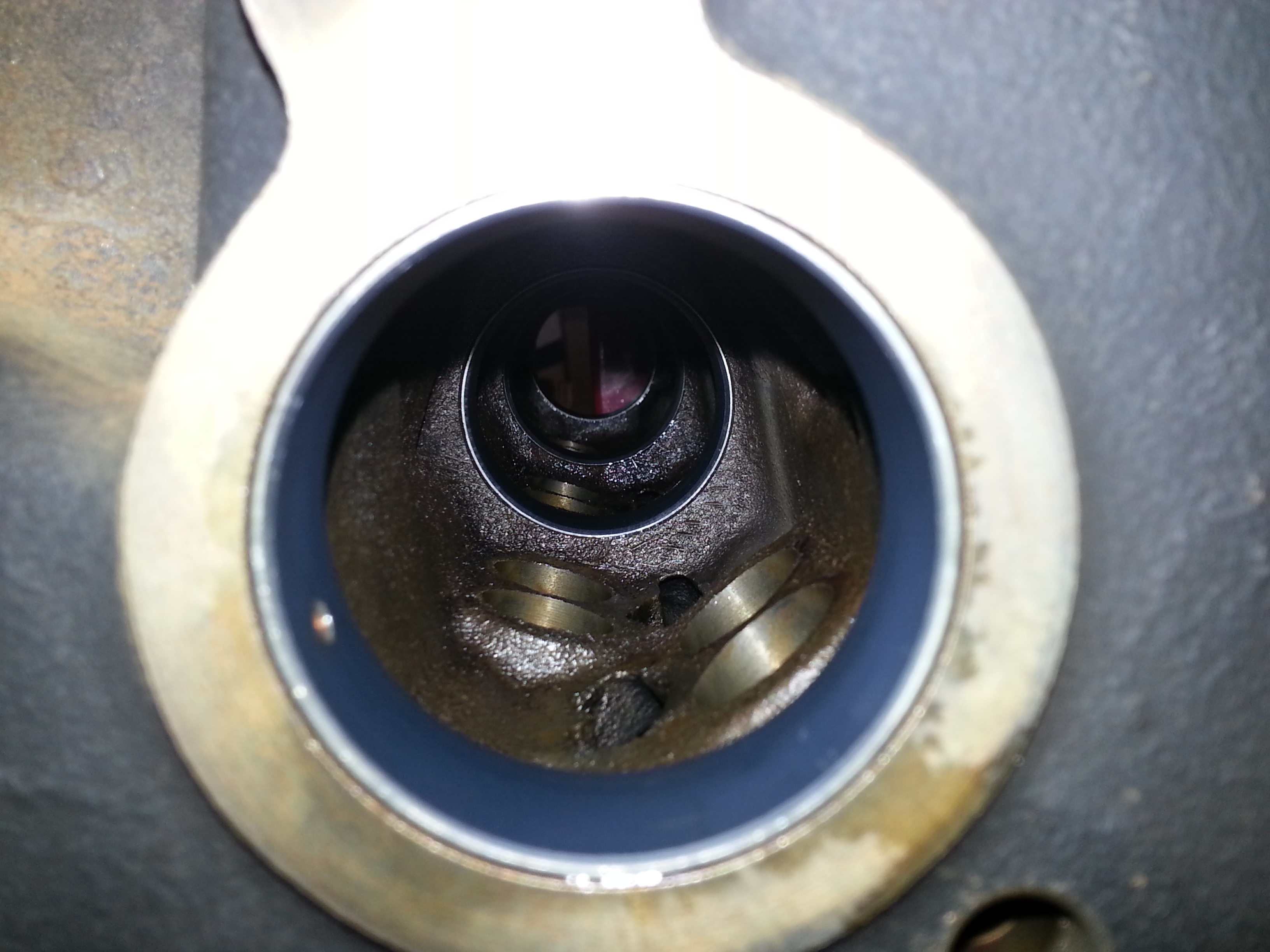

I'm using TunerCat to tune my 95 Camaro 3.4(manual transmission). Below is a list of my engine mods:

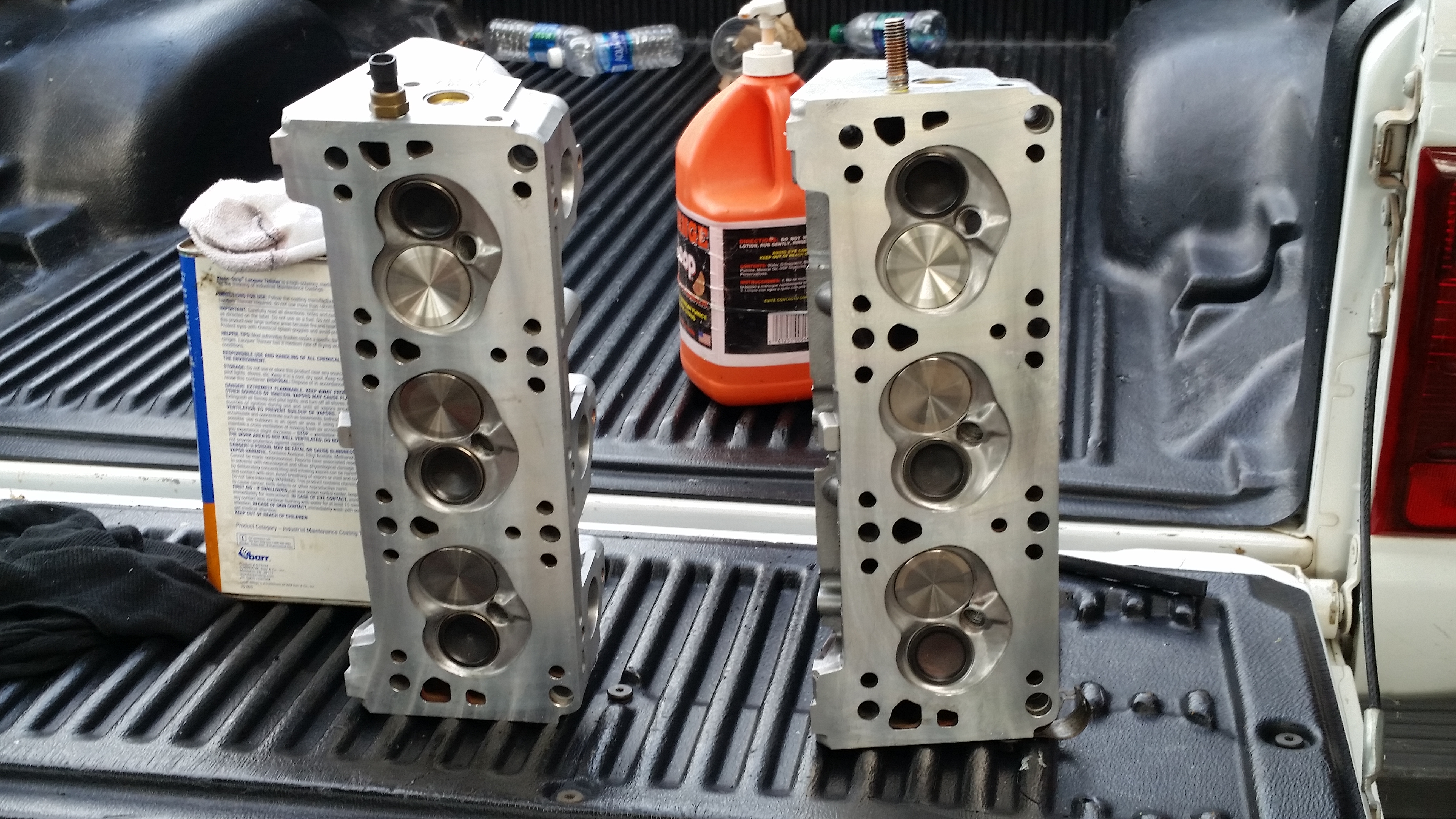

Fully ported/polished 3500 heads, 3500 LIM, 3400 UIM
TCE 65MM Throttle Body
TCE Adjustabe fuel pressure regulator with stock 22# 3400 fuel injectors
Manley SS intake valves, stock exhaust valves(sigh), LS6 valvesprings, manely retainers/keepers
Mild 260 Comp Cam, lifters, custom pushrods, Cloyes Double roller timing set, and 3500 1.6 roller rocker arms
New GM Main bolts, ARP rod bolts(lined/honed), ARP cam bolts, ARP flywheel bolts, ARP clutch bolts, ARP head studs, and stage 8 locking header bolts

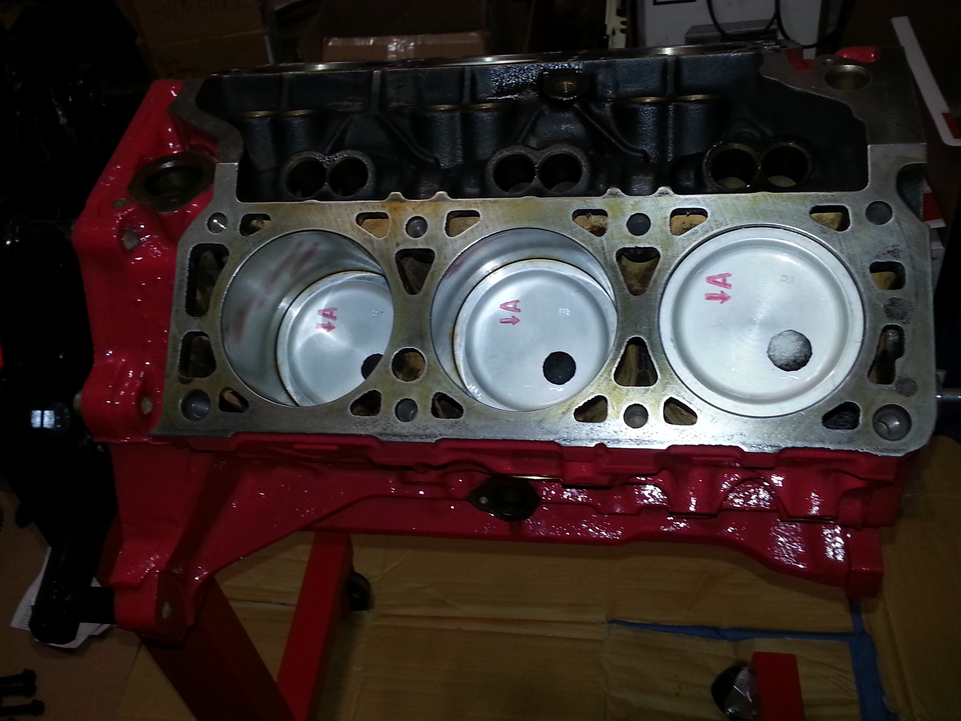

Stock crank, stock rods, and Mahle cast 3400 pistons with Total Seal conventional rings
Clevite main bearings, clevite rod bearing, and durabond teflon coated sbc wide cam bearings
RK sport headers with 3500 header flanges welded in place( thanks John!)
MSD coils, MSD plug wires, and NGK TR6 spark plugs
ASP underdrive pulley system
180 degree thermostat
cheap ebay CAI
