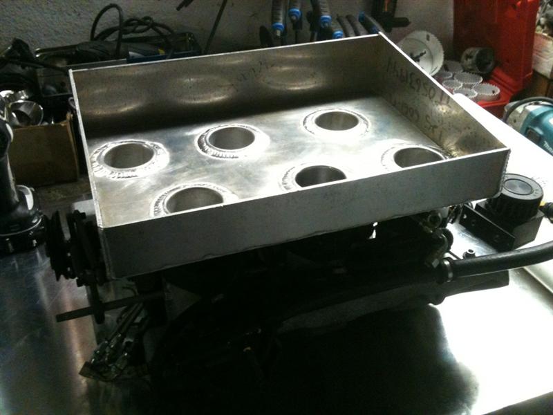

Intake
Custom cast ITB setup modified for EFI
Custom sheet metal aluminum plenum (350ish ci)
