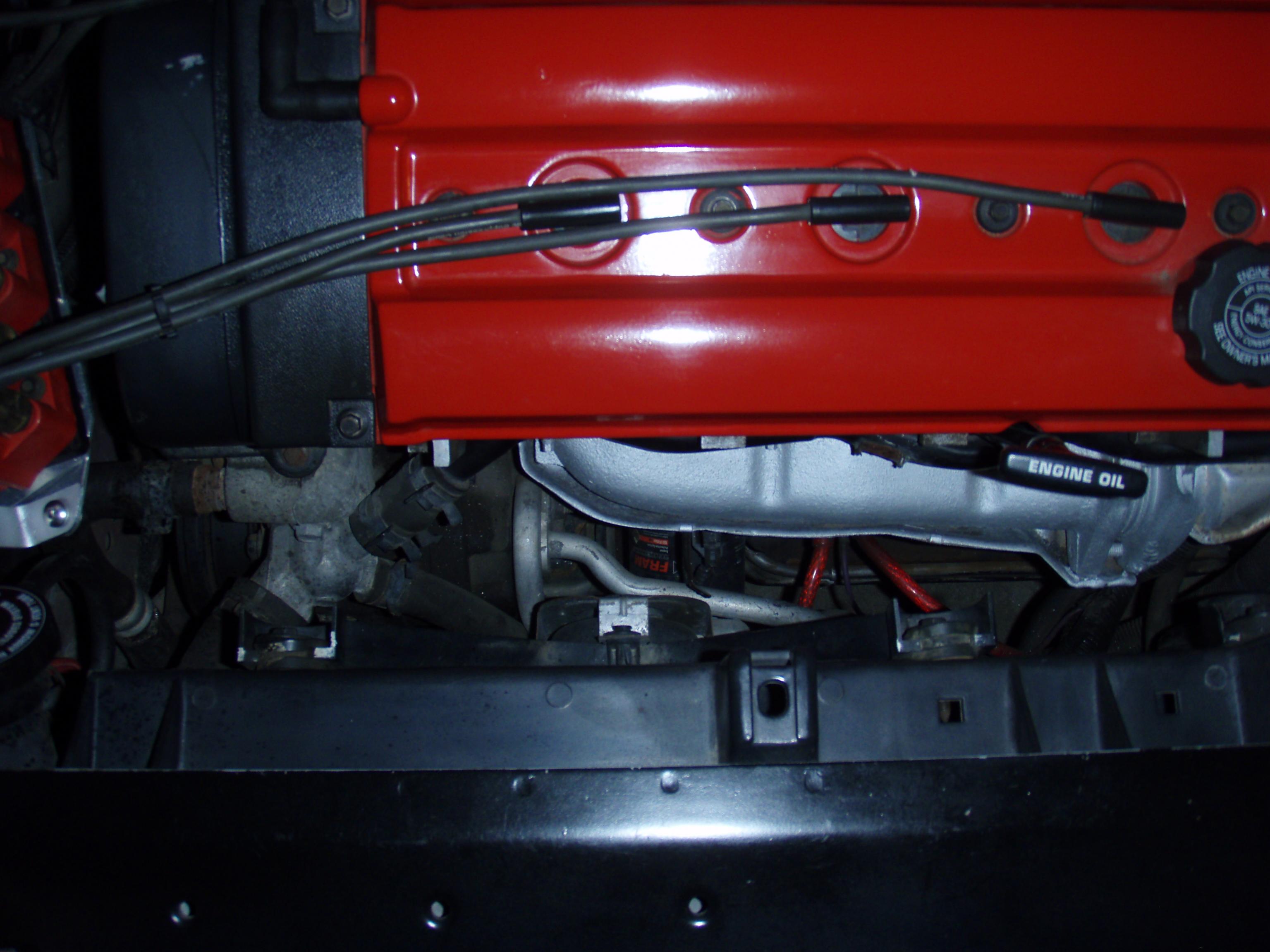

    Does anybody have any good recommendations for Aluminum cleaner?? I want to clean my water pump and a few other engine parts. Engine degreaser doesn't sound like it will restore the aluminum. Something that will take off oxidation and wont eat rubber paint or plastic would be ideal.

            Thanks for all the tips. I'll keep an eye out for the formula88 and maybe use steel wool with it. I'd like to polish it but don't want to pull the pump to do this; not just yet anyway. I'll let you know when I complete the job.
            1991 Pontiac Grand Prix GTP / 3.4 DOHC
              dont pull it to polish it. buy a new one to put in and polish that one. and the lower rad hose housing too. that little three nippled thing there with all the coolant lines comming from it could use some shine too if you ask me. your valve covers look pretty badass though if you ask me
