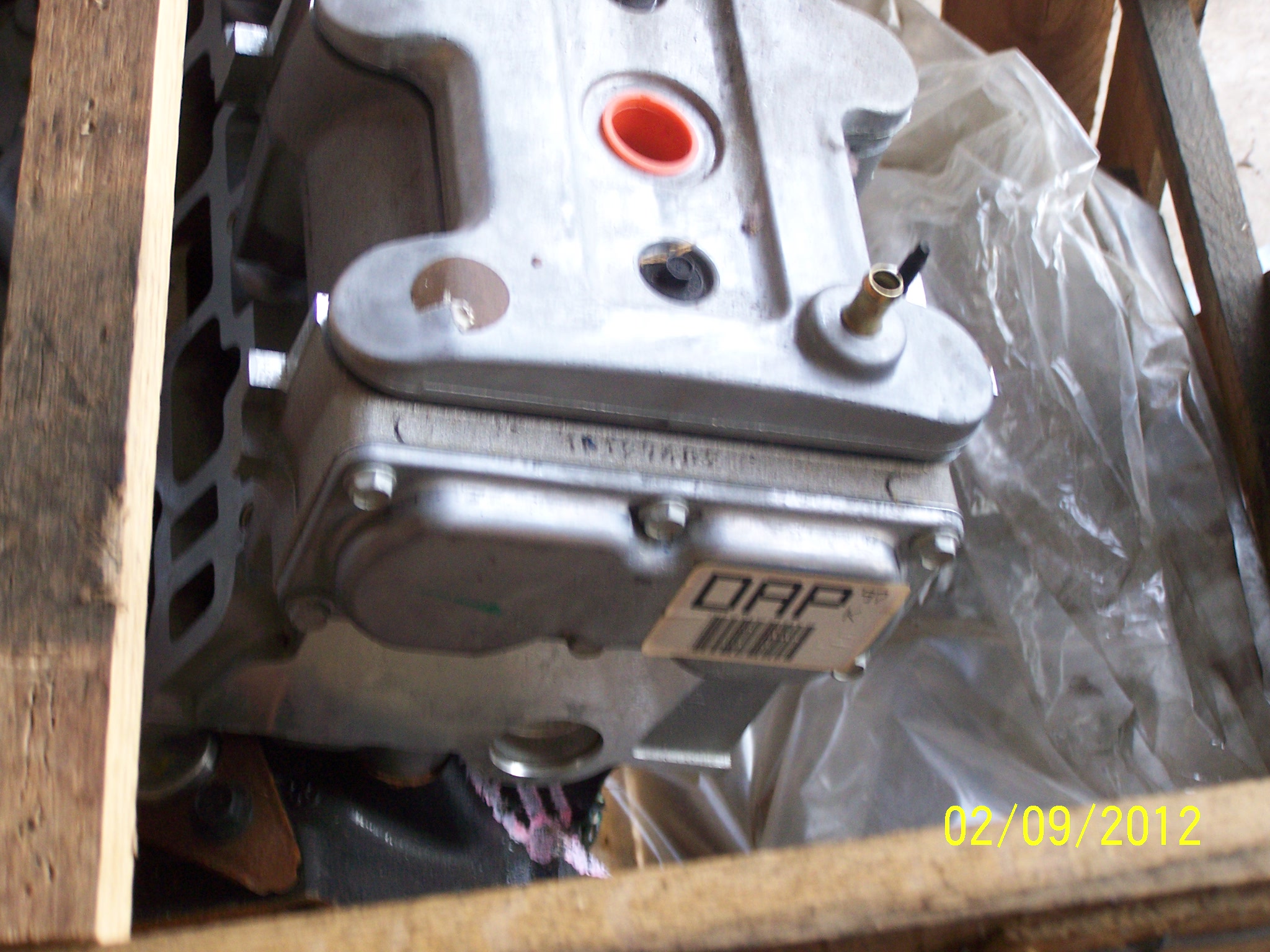

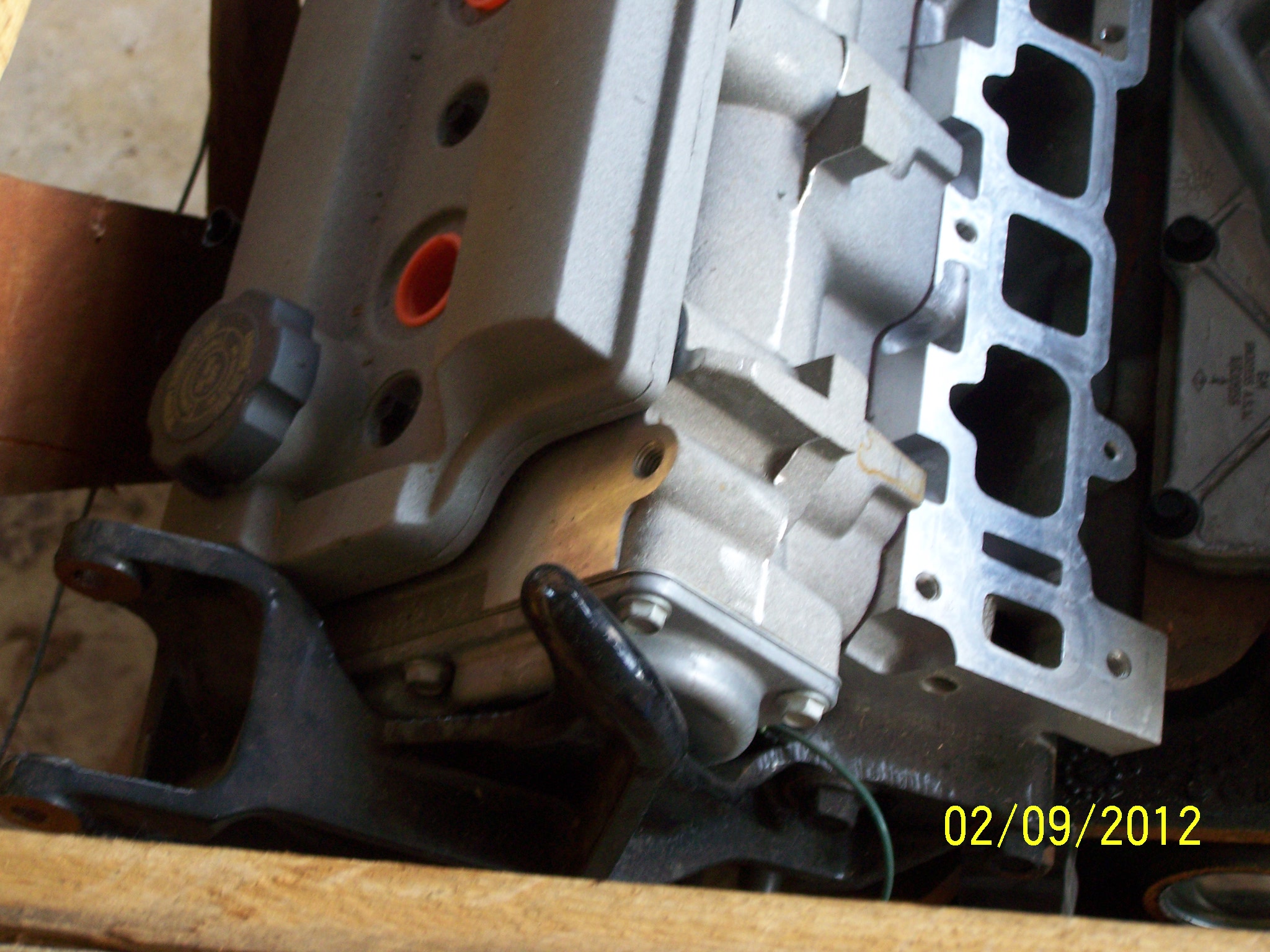

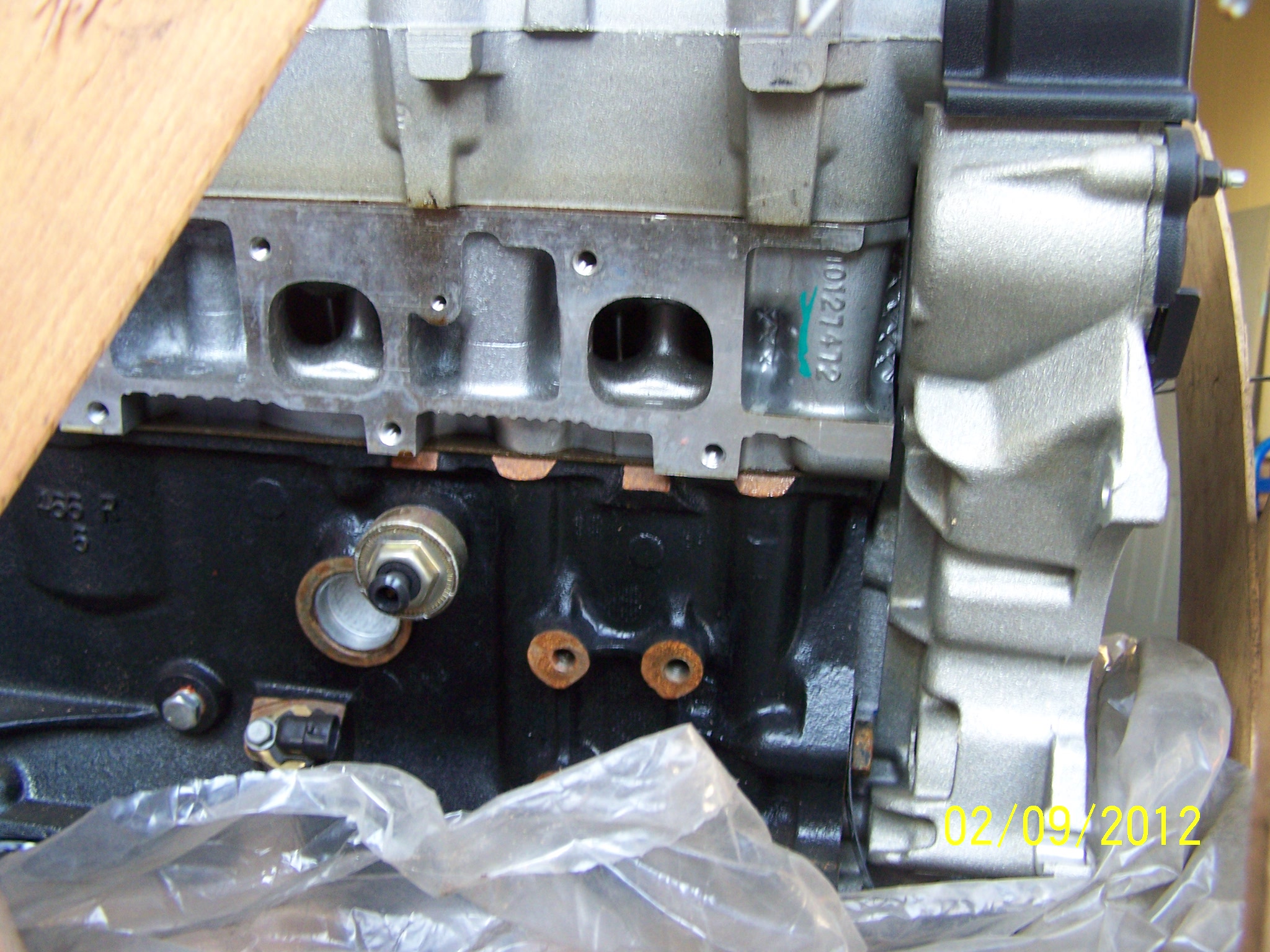

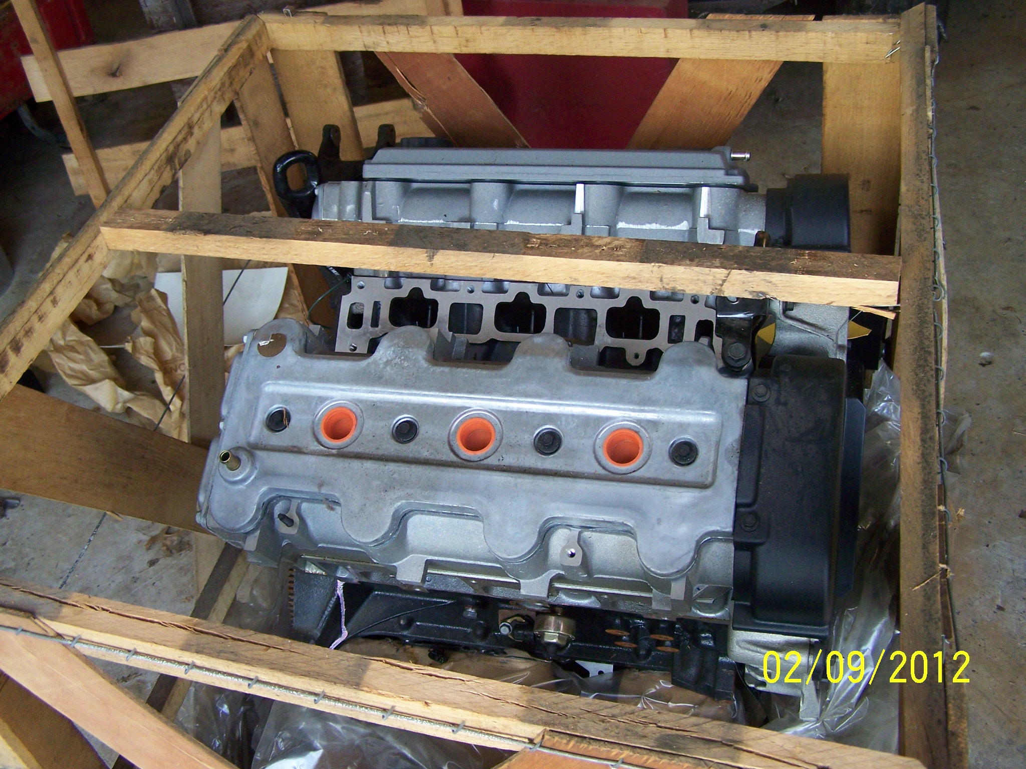

Took top off crate, here are some pics. Tell me where to take more. Only # I can find on block is 466. # on side of head is 10127472, on end of head it is 10127482.
Looks like a 91-95 with the D shaped exhaust ports.

You have a 91-93 it has no cam position sensor. Does it have a flex plate on the back for an automatic or a fly wheel for a manual? That would be the hit of what cams it has in it.Last edited by Dave96z34; 02-10-2012, 03:11 PM.
