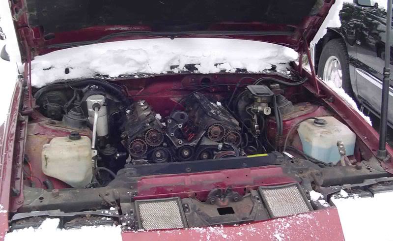

    As far as bolting up, I think you are good, except the starter on the FWD engines is on the opposite side vs the RWD engines. You would also need to figure out custom engine mounts and oil pan. I know there was a guy years ago that put a DOHC in a Camaro but I have no clue how far he got with it. I saw pics of it in the car but that was the last I heard of his project. Hope this helps.

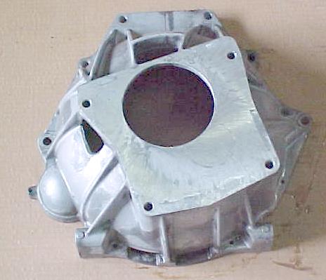

              I found this bellhousing. It's supposed to be from 95-97 3800 f-body. It looks like you can mount it straight or angled. Is there any specific pros or cons to either mounting position?
                That actually looks like it can be angled to one direction or angled to the other... odd...
                  I can tell the holes were never drilled and taped also that's a push type clutch

                        You can mount a 3.4 TDC engine on a T-5, but you will have to use a 93-4 2.2 S-10 bell housing. It has the starter clearance on the FWD side. The shifter stalk would have to be modified to put the shifter back in the same place it started out in the F-body. The TDC does have the same mount points as the F-Body 2.8/3.1/3.4 engines, but they are covered up by the accessories (alternator and AC if I remember correctly). If you were to fab up new mount points for the accessories this could be overcome. It is a difficult swap, and I do not think that the intake will fit under the hood without modification. I would recommend using a 96-98 intake because it is reversible (so it will have the TB on the front of the engine).

                              I have seen that pic a few times over the years. Really wish someone would finish one
