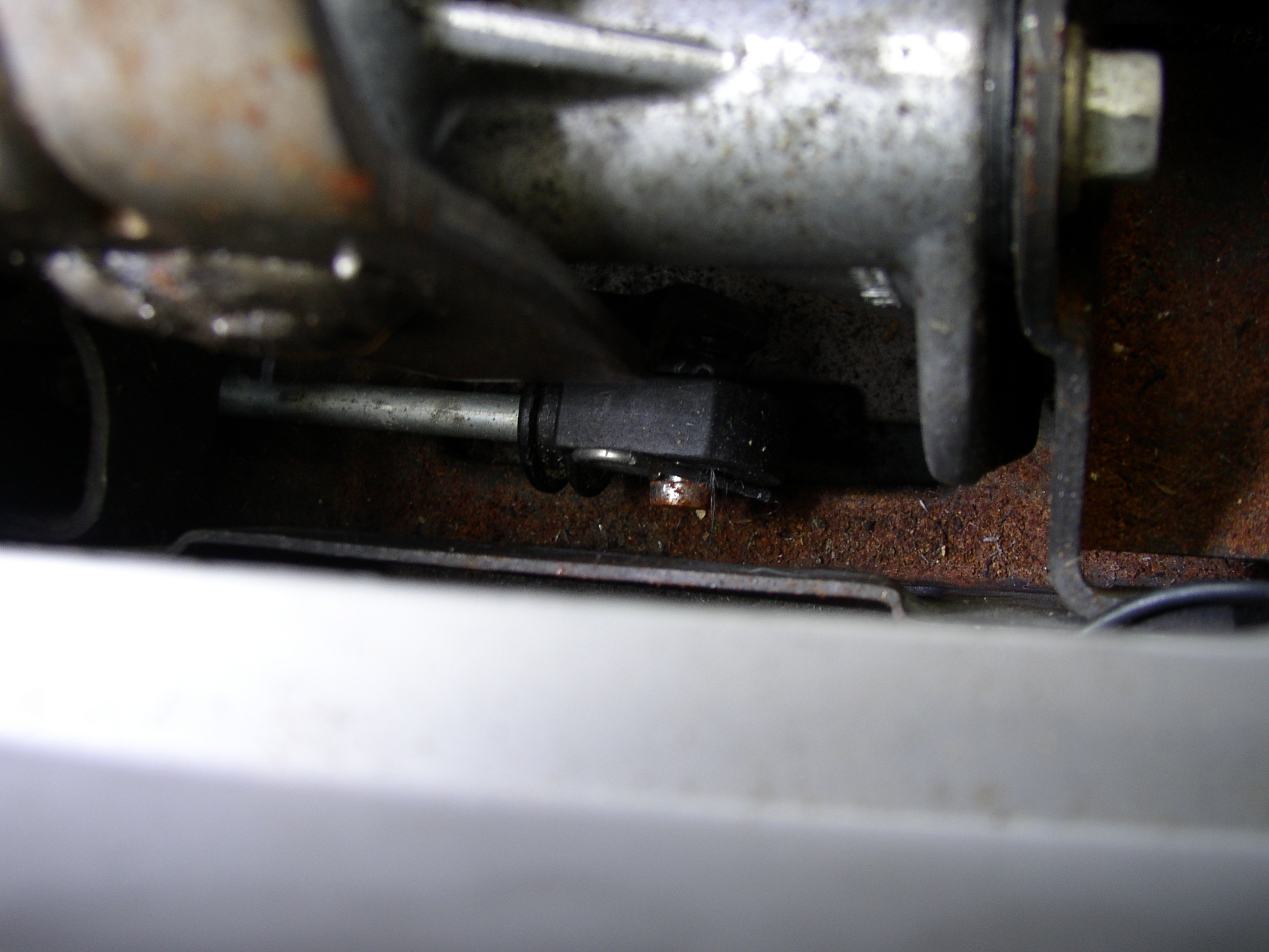

          Do you have pics of your "fix". My problem is trying to get a clip or cotter pin to stay put. What size did you use for those?
          Tom
            Not sure what size. I will try to get outside and snap a pic for you tomorrow.
              Here you go man! I didn't measure the pin, but it looked to be about 1 1/4" on the strait side. Hope this helps. You can see one of the threads coming out of the piece of hose in there since it has been forgotten about and is getting old, lol. Thanks for helping me remember about it
