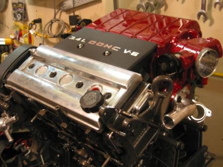

    Hey Everyone,
    I've had some requests to post pics of my 3.4 DOHC, so I thought I'd post some that I have from when I was finishing building it.
    I'll add more soon..........

    Looks very nice.
    Tim
    325 whp 350 lb-ft
      BEAUTIFUL! but neeeds obd2
        These pics dont do the car justice. Have seen it in person and he had made me get all pumped up.
        Dave great work but I dont know I think you are going to have to do better to beat me out. LOL
        I dont know what this means but "ASS HATS" is funny
          91-95 plenums make jesus cry. Looks shiny though. Bling Bling.
            Pretty, looks sweet.

              Very nice. I love powdecoat.
                David you now know that I have started working on my underhood cause of you.

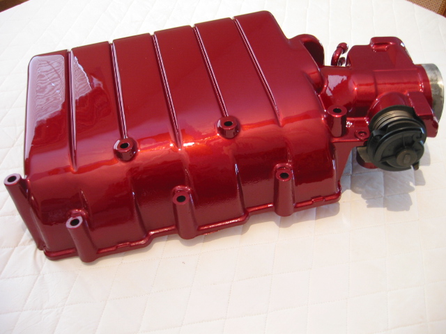

                  That isn't powder coat.
                  I painted it, etc but with special prep work, it took weeks to do!!!

                    No shit, that 2 stage paint? Looks like you ground it down, then shot base and the 40 gallons of clear. Looks great.
                      I ground the WHOLE intake till it was smooth as glass, preped it with with a special zinc self-etching primer that is made for aluminum, then put down 4 coats of base, with 5 coats of Very High Temp. gloss.
                      It was a ton of work.....

                        Wow, thats pretty sick. Can you do that for members? I would love to have some stuff done thats super glossy. PM me.
                          Yes I can.....
                          That is what we do.
                          The biggest factor is what the surface of the product is like before a person starts....
