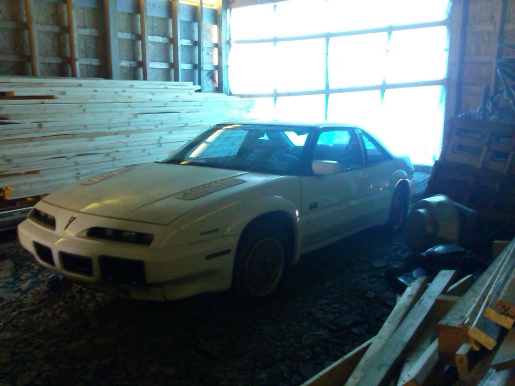

    Hello. I have had this 1993 Grand Prix GTP in storage for a few years now. Naturally the 3.4 DOHC in this car is blown up. I have always liked this body style. Been wanting to make a drag car out of it. Car is not going to be street legal. So I don't have to worry about all of the emissions that NY state requires. I do have in a wrecked Buick Reagle a NA 3800 with a tranny. Motor and Trany run and work good. Is this something worth messing with? I also have a 3100 in a 02 Grand Prix with low miles. Tranny is also good. What do you guys think? What's the better route? Or is there better motor tranny combos?

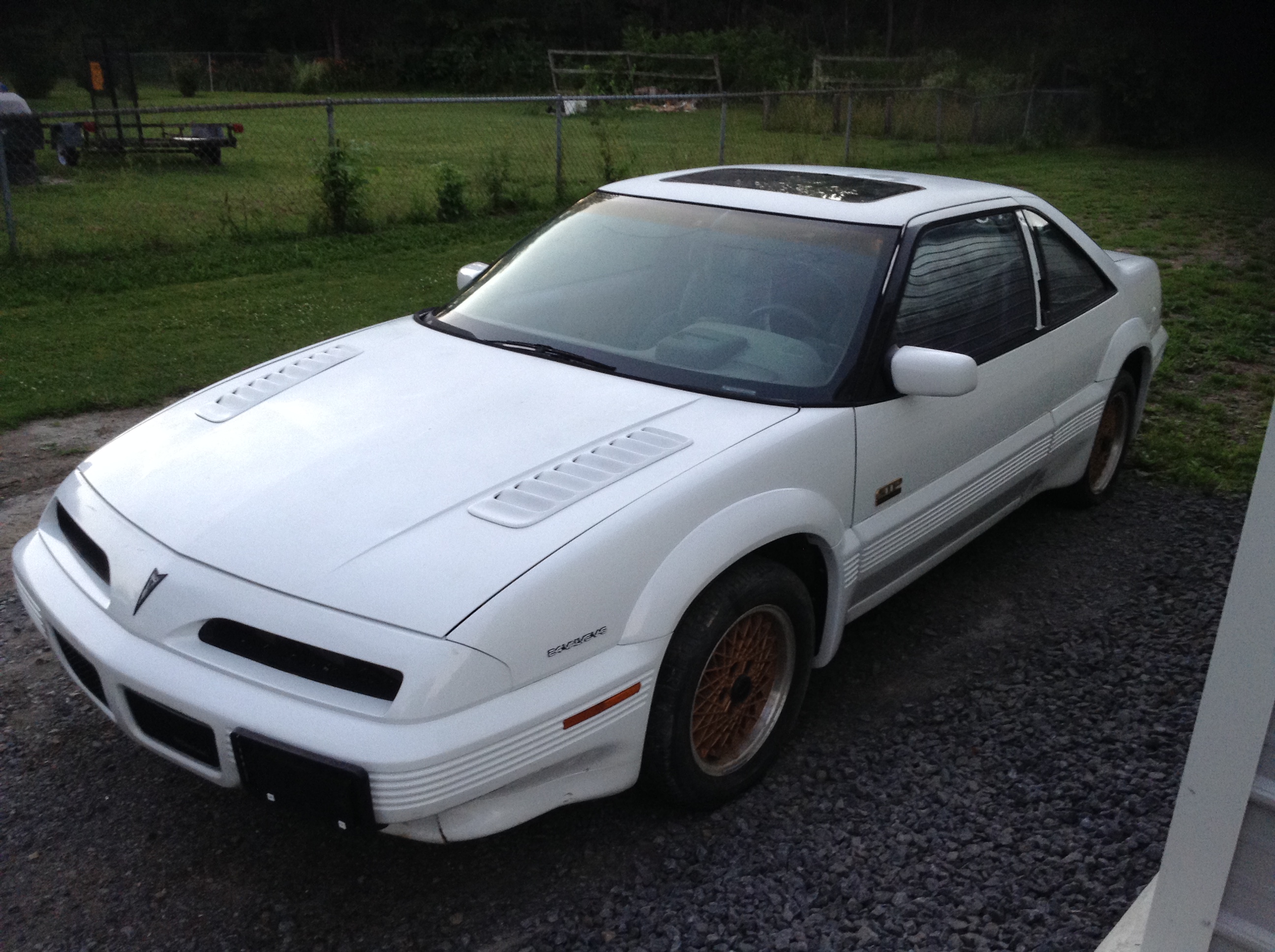

                  The car has finally made it to my house.
                    Wow! It looks great!
