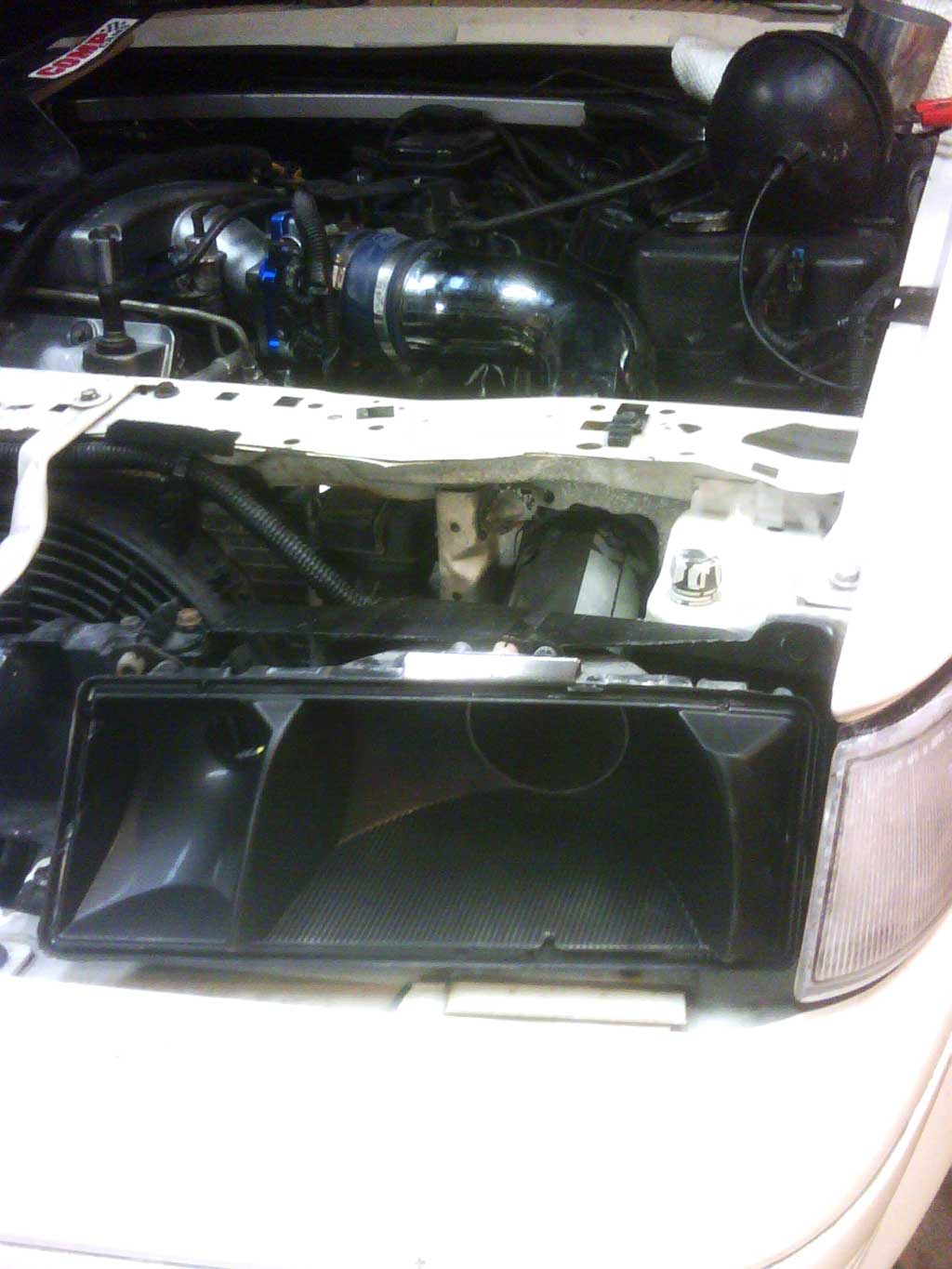

              Here you go... lol
              I ran it at the track all day like that, at 100+ MPH you could tell it was working. If the DA was better I might have been able to get my 12.99, traps were up in the 108 MPH range all day.
              Modified headlight and radiator support, 3.5" pipe directly to a 75mm TB. I did a before and after test, I can't remember the specific numbers from the MAP sensor but it went from low 90's Kpa to maxed out at 99.9 ish. Wish I had a 2 bar in there at the time.
              Wasn't worth the effort though.

                I would say that is worth it to simply get FRESH cool air... I know when I'm sitting in the staging lines if my fan happens to come on the air blows from the radiator down to where my filter is... Some of my logs from this past weekend I had IAT temps of 121* before leaving the line. I need to find a way to move or isolate the intake to prevent that hot air from getting in there.
                  Thanks Dave. I hadn't looked back at this post in a while. Kinda cool just to hear about it being applied. You said it wasn't worth the effort, though? What did you notice since you said you could tell it was working?
                    The datalogs showed that the MAP sensor maxing out vs being lower without it. You could also tell at high speeds that air was being forced into the TB, the throttle didn't feel the same as it did with a normal CAI. Kind of a delayed response.
                    It didn't net any noticeable gains in trap speeds but I'm sure intake air temps were lower. That would be the reason to do something like this, just nice fresh air right into the engine.
