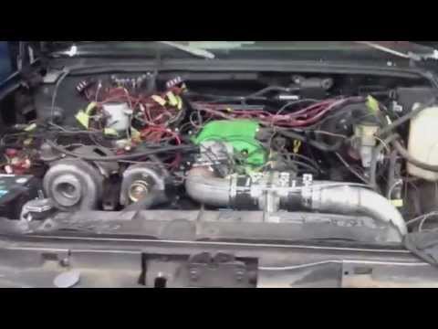

      little update
      wiring sucks!
      I wanted to control the trans with the GA pcm but after studying the wiring diagrams noticed that 4l60e has an extra solenoid over the 4t45e. So I am going to try controlling the trans with the factory ECM from the truck like every one dose when they swap from TBI to Carb!
      Finally got it fired up last sunday night!
      this week I will be doing more wiring, then exhaust/ cold side piping and maybe a test drive the week after!

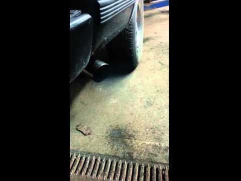

            getting closer to a road test, still have some wiring to do/ clean up and other small time consuming things.
            got the exhaust pretty much finished for now. left the cat off for now until it gets tuned better, right now it is very rich!

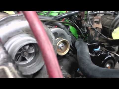

                well the 3100 has about 1500-2000 kms on it now in the truck, best fuel millage of 13.7L/100km so far over the winter (17.2mpg). I had a problem with the factory wastegate actuator from the 6.5 turbo not building any boost. found out that on the diesel it is controlled by a vacuum pump and the ecm (no spring in the actuator).
                picked up a new actuator for a t3 turbo on ebay and made it work on my set up! sofar it makes 7psi on the gate and moves pretty good for a 3.1L pulling 5000lbs! I still have to swap the l67 injectors back in, the 3.4 dohc injectors are hitting around 115-120% duty cycle at 7psi.
