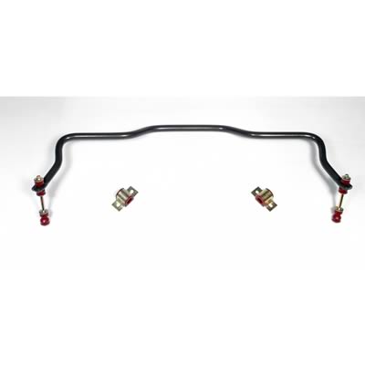

    REAR;
    (stock is 12-14mm)
    Addco 7/8" Sway Bar Part #474
    (All 1st Gen. W-body except 95-99 Monte Carlo and Lumina)
    Addco 7/8" Sway Bar Part #639
    (1995-99 Monte Carlo and Lumina)

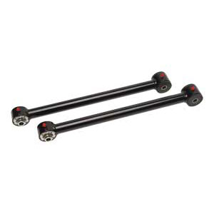

    Trailing Arms:
    GM Tubular Trailing Arms #12498649
    (Comes as a pair, complete with bushings)
    (Fit 1st and 2nd Gen. W-bodies)

    BMR lateral bars work in the rear of the 95-99 Monte Carlos

                      I want to put bigger swaybars but have FE3 already.
                      do they make bigger that 34mm for front and 14mm for the rear?
                        Just a note about Sway Bars for Luminas. The Addco Sway Bar part #639 listed for 95-99 Luminas will NOT fit the Lumina chassis. I know this because I ordered one of them from Addco, and when it arrived, it was not even close to the configuration of the bar on the car. I called Addco and told them about it and emailed them pics of the bar. They checked with their engineering department and said that I was right, the bar would not fit a Lumina chassis. They had assumed that all the W-bodies used the same chassis, and they don't. The Lumina is different from the Pontiac, Buick, and Olds chassis, and the sway bar design is completely different also. The only heavy-duty rear sway bar that will fit a 95-99 Lumina is the factory one from the Ride and Handling package used on the LTZ and Police suspensions, Chevy part # 10242079. Hope this saves somebody else from making the same mistake I did.

                            will it fit a 1988 first gen?
                              cutlass supreme FE3, the addco bar 7/8" listed on the first page works for first gens like ours. Also, do you already purchase the 34mm front? FE3 in 88 only had a 30mm bar IIRC.
