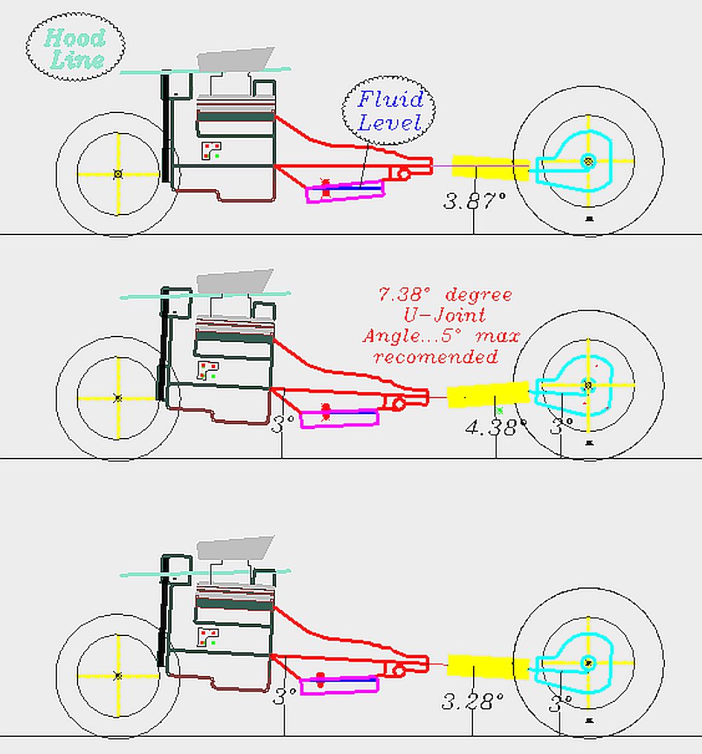

              The car I'm building is going to be very low. With the engine/transmission level, the low points of the pans would be about 6" off the ground. Tilted 3 degrees, with the transmission mount as the focal point, results in the transmission yoke below the differential toke...and bad universal/driveshaft angles. To fix that the whole engine/transmission package needs to be raised over 3"...putting the top of the distributor higher than the cowl, and cutting into already tight pedal room in the interior.
              My uneducated worry with setting the package level, is the angle of the transmission pan. With a three degree package angle, the transmission pan is still tilted low end to the front...with the package level, the angle looks like it would be about double...around 5-6 degrees.

                    I figured an illustration might help...
                      Is not manipulating the pickup tube and filter attaching points not an option?
                        To be honest, I have no clue. I've never seen the inside of an automatic transmission.
