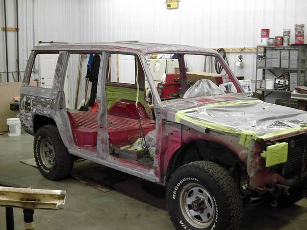

              Here is my hack job, hoist on it when I was replacing the clutch and tranny:

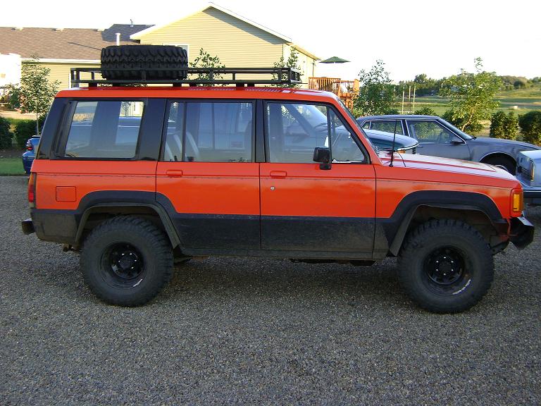

                After reading a few posts on here by you canyon I had to join. I am currently researching swaps for my 90 troop I think you and I need to chat haha. I am going to try to attach some pics of my "PUMPKIN"
                    Nice to see a 1st Gen cleaned up like that. Mine is totally stock except for the engine and the 31x10.5s on snowflakes (factory option though).
