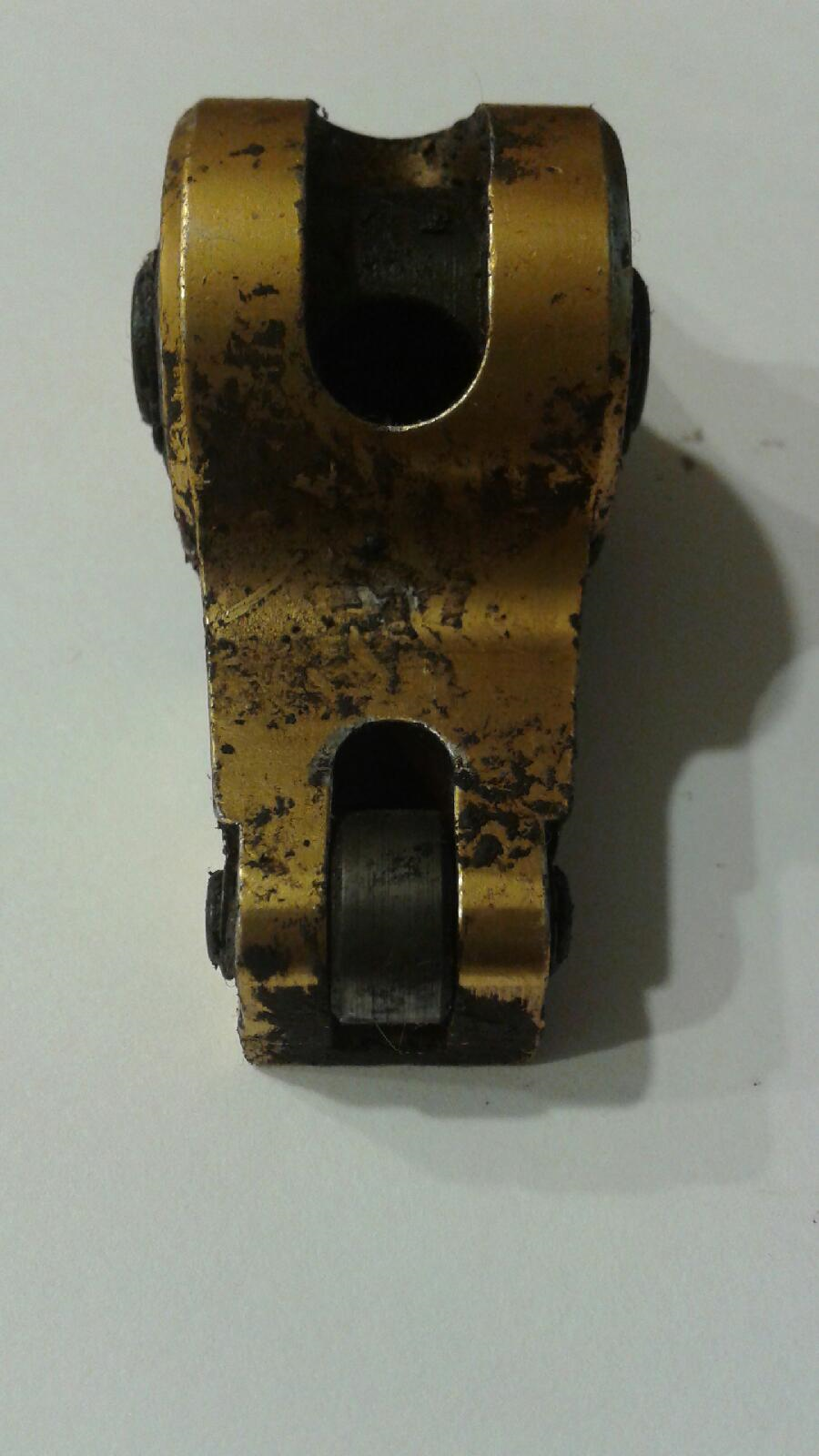

roller 1.pngroller 2.pngI'm looking for a couple of the narrow Crane roller rockers for my iron head 3.1, anybody have a couple lying around?
