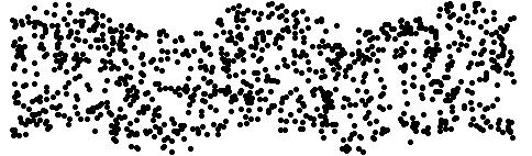

      An acoustic wave is a propagation of a pressure difference through a medium. A longitudinal wave, transverse waves are like ocean waves.
      To answer your question, yes. Sound is a repeating pressure wave. For fun, I ask people if space is a vacuum, then how does light retain frequency as a wave through space from the Sun to Earth? There MUST be a medium to carry that wave form to us. So what is that medium in space?
      Longitudinal
      Transverse
      I love science, physics, engineering, etc. Can't get enough of it.
            Longitudinal
            [ATTACH=CONFIG]7429[/ATTACH]
            Transverse
            [ATTACH=CONFIG]7430[/ATTACH]
            Dark matter is the answer.
