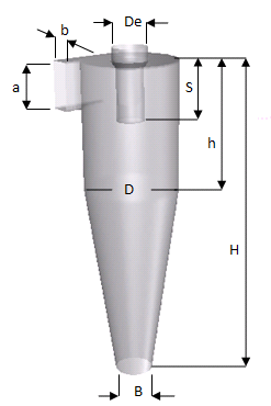

Some types of dirt/air separators spin up the air and dumps the heavy material out while ejecting clean air, no moving parts and really simple design. I am building one myself. Might do well to seperate the crap out of the gases.
A: Blow-by IN
B: Oil to catch can OUT
De: Clean air OUT
