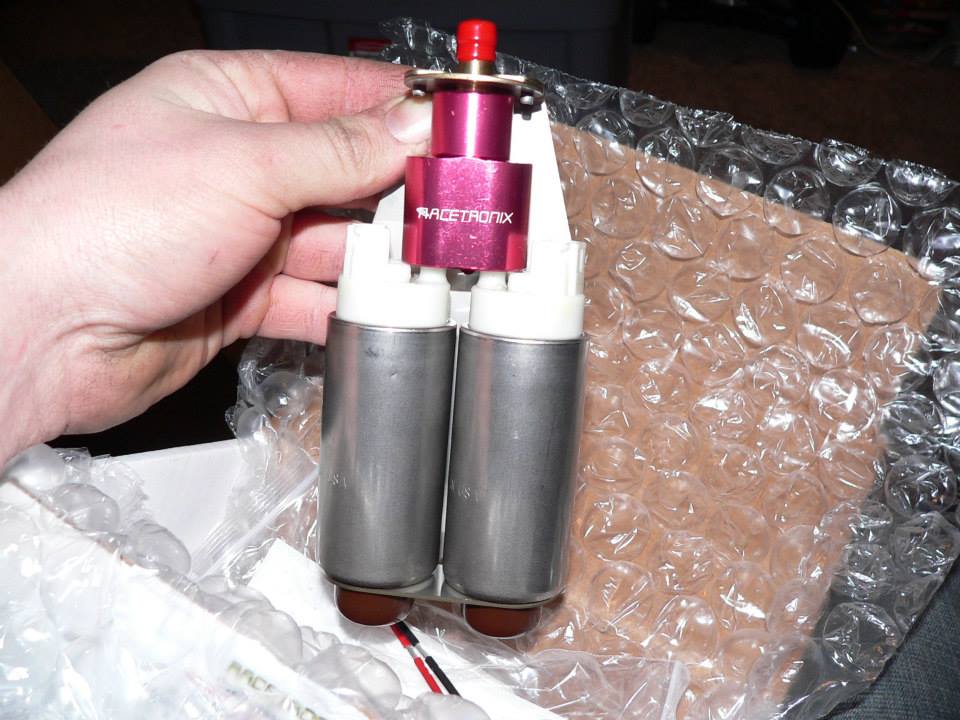

    A single walbro 450 will support your hp goal as well. No need for two pumps

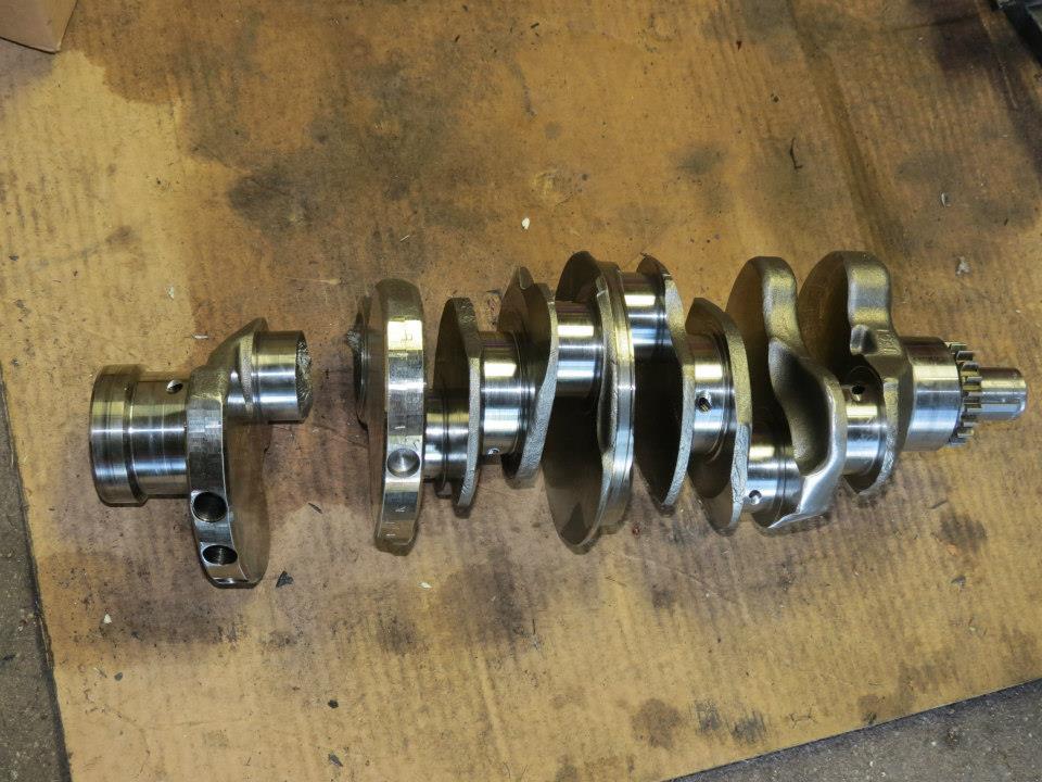

            im rarely ever on here. usually on w-body. LG5 3.1 w/ a 3500 crank, roller cam, and a gt3076r.. journals were cut down to fit h beams. the second crank just broke the other day..ugg the first crank had a relatively small radius the second one had an 1/8" radius and we chamfered the rod and bearing to suit..

              How much was cut from the cranks? I would look at using larger journal rods before cutting down a crank, to keep the strength. There have been reports of people making that much power and more on stock crank LX9s without issue. I know of an LZ9 making somewhere around 125HP more without any reported crank issues.
                it was cut down to a 2" journal size. I would have rather had 2.100 journals but I already had the h beams and I bent the 981 stock LG5 crank so at the time that was my best option. The shop I deal with and myself called around to try getting it hardened and a few companies said it wasn't worth the cost. I don't have much history on here but I have a 1990 McLaren and an 89 gp se. I was building this motor for the 90 tgp but due to this crank problem and my funds running lower than id like Im cutting my losses and moving on all in to this project which will go in to the 1989 TGP SE. That car mans a lot to me as it has been in the family fr a very long time. It was the car that picked me up form the hospital when I was born as well as my first car. My mother passed away in 2012 and this being her car many memories road trips etc.. so Im keeping the 89 and selling the 90 to hopefully my friend unless that idea backfires then Ill just keep it around.. Anyways enough with my tangent...

                  modifying the crank to fit your rods is not the correct way to do things. Buy the rods to fit your crank. I could have sworn the lx9 crank had 2.0 inch rod journals to begin with so why was machining necessary? Im confused.
                  I made 370 whp and 460 tq using a cast 3.1 crank. Thats over 400 crank hp and 500 tq. The steel one should do 500hp easy without a sweat.
                  Yes a 3582 can push 75 lb/min but I was merely correcting you when you said its at max efficiency there. its not. It can make that power but it is maxed out and to make 750ish crank hp, will depend more on overall efficiency of your engine, and the aggressiveness of the tune.
                  lz4 crank can be turned down to 2.1
                    The LX9 has larger journals than 2.0". I believe they are 2.1", I'll have to measure one of my LX9 cranks to know for sure.
                      Its a 2.250" journal.

                        I never dynod it on the 23psi I used to run, only at 16psi when it had headers and it made 321hp 408tq @ 17psi with ported TGP logs. the 981 cranks actually twisted and bent for me quite a few times before I finally had the 3500 crank machined to fit the block. The journals were always ok on the 3500 crank just that it broke at the radius. I know it wasn't right but at the time I didn't have all the funds to swap rods and such. It worked for 16k miles so whatever Im not happy but it was a lesson learned.. Either way this thread isn't about that engine.. Its about the latest project. I already have most of the parts and Im all about building a gen 2 3.1 block since that's what my car came with.

                          The large-journal cranks are 2.25", shared with the 4.3l engine.
