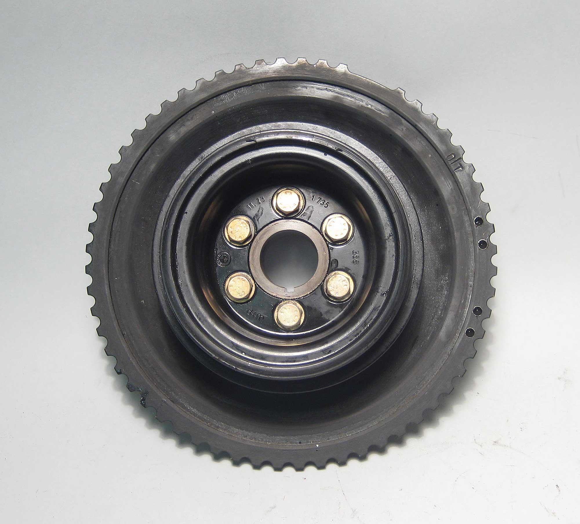

      Just because TCE does it, does not make it a good idea. You will NEVER see anyone else do this, OEMs, or major aftermarket manufacturers.
      Learn what an harmonic balancer is and how it works and then you might see why it's a bad idea and can cause unstable timing issues. I'll give you a hint: the outer ring moves differently than the the inner part of the harmonic balancer, and absorbs the shocks to the crankshaft that are created by each cylinder firing event. Ok, that was more than just a hint, but using notches on an harmonic balancer is a really bad idea. The other issue is the outer ring ever slips, which is not uncommon, the timing will then be off, causing the car to not even be able to limp home. With a proper trigger wheel the car can at least be driven home or to a repair shop.
      BMW has always had the 60-2 wheel on the outside of the damper...
      • Originally posted by ForcedFirebird View Post
        I find that hard to believe.

          • Originally posted by The_Raven View Post
            I am 100% sure. We have tons of Bavarian in the shop.
