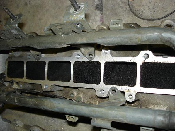

I picked up a 96 intake the other day but left the fuel rail because I didn't want to pay another $20. So does the old style rail have enough clearence to work?
Will the 95 Fuel rail fit around the 96 intake?

i am thinking no. besides the fact you have to hack and re-bend the mounting brackets, i think the fpr and line placement interferes with the 96 intake.

Simply put, yah, DOHCfiend had it right on the money. You can see it for yourself. If the fuel rail was modified to mount properly, you could fit the upper plenum on, but you could NOT fit the "arm" with the throttle body on, it hits the fuel pressure regulator, just like DOHCfiend said.

Thank you both. Fierobsessed that was awesome of you to post pictures!Getaway cars:
