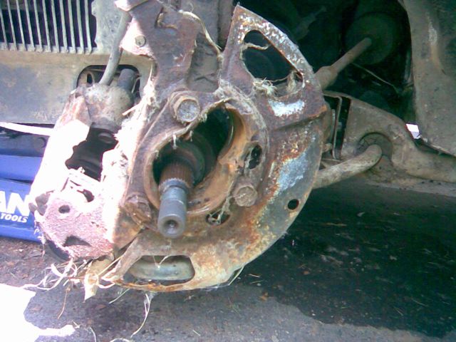

Here's a few more pics of the car. It had a tough life, check out the pics of the wheel bearings/spindle (the before and after). They drove it until it almost ground another hole in the spindle, it kinda looked like a figure 8 hole from the back side. I saved those pieces for the wall of shame and for whenever I finally get to take it to a car show. It does look a lot cleaner using the serpentine belt setup as opposed to it would've originally came with the long water pump/v belt front accessory drive. I had to rescue it after finding out they only made 696 of these Sport Omegas. It has its own unique piece of GM history as thevery first GM vehicle to use plastic body panels, the front fenders and rear flares are made of it. It's going to take a little reconstruction to repair the rear flare it's missing a section on the bottom.
Looks like you already have good progress
And good god @ the hole in the spindle!
