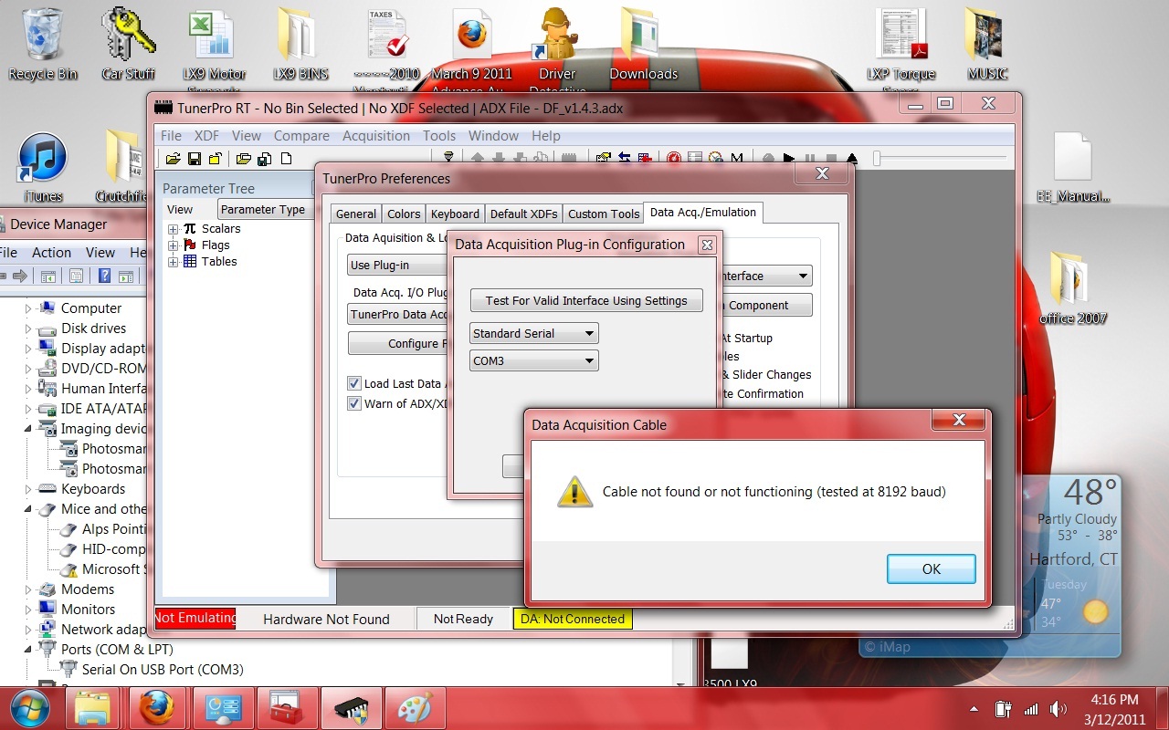

I have a bunch of codes and I need to see what my swapped motor is doing.
I'm using TunerPro RT, a moates cable and a serial to usb adapter. I've used all this stuff successfully in the past. But now my new laptop is windows 7 and it wont connect.
I'm using DF.ecu (DF_v1.4.3.adx, by Sil) that I've used in the past, so I don't think its that.
When I configure the plug-in component the cable tests OK.
But when I try to auto-detect the hardware it fails that test.
I think I've got the com port stuff right.
If I click the edit ADX button what should I see for values?
Default baud = 8192
Parity = None
RS232 echo is checked.
Stop Bits = 1
Byte Size = 8
Connection = Mode 1 ALDL Dump Request Send
Monitor = None
Disconnect = None
My cable is plugged into the cigarette lighter and it is powered.
I just can't connect and I really need it to so I can see what my ECM is doing.
Default baud = 8192
Parity = None
Stop Bits = 1
Byte Size = 8
Monitor = None
Disconnect = None

My targus usb/serial adapter woudlnt work at all. I ended up using an old bulky belkin adapter and a windows xp driver (running windows 7) and finally it works. How do I make TunerProRT (v5.x) refresh faster? It seems laggy, like if I stab the throttle there is a 1 second lag before the TPS % change is reflected.
