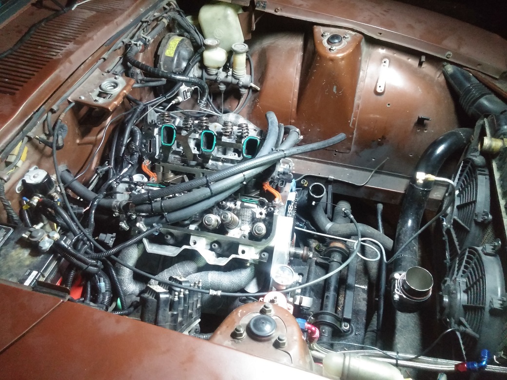

Guest repliedSo, finally have one of these:
But...
my car currently looks like this:
No idea what happened, but I saw over 30 PSIG on my boost gauge, and the engine sounded like a diesel, with the AFR showing straight air (99.99 AFR) at 1000 RPM as I was coming to a stop. It wouldn't re-fire, and now had a definite new knock when being turned over. It also backfired a few times through the intake. I have a suspicion that the engine might have actually started rotating in reverse with the symptoms.
At first I suspected a broken dowel pin on the cam, since it's not uncommon for them to break on these engines, but nope, that checked out fine.
So then I suspected a broken cam, but so far that doesn't seem to be the case.
A mechanic friend of mine suggested that the ignition module took a dump on me and either started firing the wrong cylinders or all of the cylinders at the same time. He said he's seen that before. Without finding any mechanical failures so far I might have to agree with him.
So out with this engine and will be rebuilding my previous short block to go back in.
