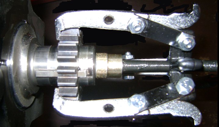

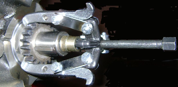

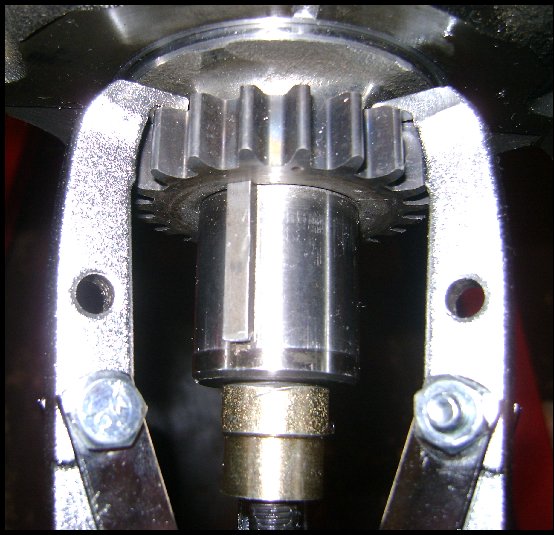

                    You'll need a Harmonic Balancer Puller, a Three Prong Puller with Flat Tangs on the adjustable arms to remove the small gear from the nose of the crank and a Crankshaft Gear installation tool which might be available for loan or purchase from your local Autozone or the like...and of course ...removing whatever is in the way on the front of the engine to do the pull and re-installation with the necessary room to do this replacement along with a new gasket kit, leak sealers and you might as well spend a few more bux and get a sleeve kit for your Harmonic Balancer and a new Timing Case Cover Seal as well to do the complete job properly. Don't wait too long...and...

                            Hammering on any crankshaft can de-tune it at best ...and at the worst, ruin it completely for the need to get the harmonic damper/balancer back on and center bolt re-installed. The attached images show an easier way to get the hard-2-remove timing gear off. Please visit my Photo Bucket site below for more images on Timing Set replacement and installation data on the GM L-32 3.4L 207 CID engine. The clacking noise could be the stretched-worn out timing chain clattering on the slack side of the timing set rotation and be involved in the hesitation from the mis-reads on the timing gear sensors to the ECM. Your description of the poor engine condition indicates the 144,000 miles on it may have been very hard ones. Putting the super-high viscosity motor oil in the engine is reminiscent of that old trick of dumping saw dust into gear boxes to quiet them down and make selling used cars with them less suspicious.
