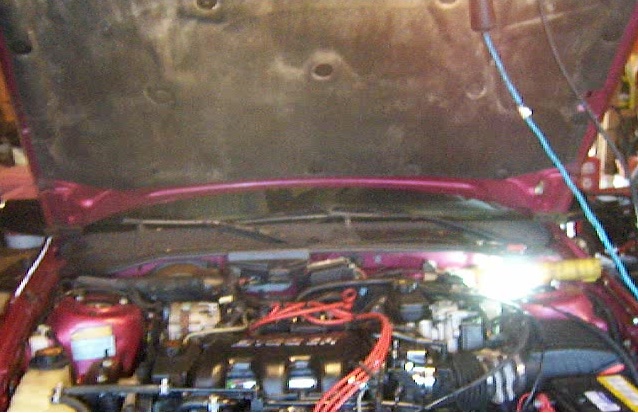

Well i did a little work.
Dropped frame rails, cut off exhaust, replaced inner tierod bushings... Yes I do use my own products
and then installed the transmission.
PICS...
Since I forgot to get a Belt, I can't really install the motor since the side motor mount would be in the way later, so yeah that will wait till tomorrow. I'll just go get the other fluids I need for tomorrow now.

another quality job by jon, cant wait to hear this run at bfest as vids dont do it much justice in my opinion.
hey, them frame rails look lil dirty there in the engine bay thats not acceptable after the way u made the tranny and motor look

Well its friken loud and lopey... cant judge its power now because well its open headers so it sounds like its reving to shit at 4k to my ears so I didn't romp on it, and its raining so I have no traction... Oh and I definitely need to add washers to my shift accumulators or bump up my modulator pressure... shifted wicked soft, and the torque converter is very bearable I'm suprised... way better than the PDQ one I tried a long time ago.
Oh and the radiator is cracked... so yeah gotta wait till monday for one of those... FUK!
Vid is uploading so hang in there.
A little teaser pic while it uploads...Last edited by 3400-95-Modified; 03-08-2008, 04:16 PM.
