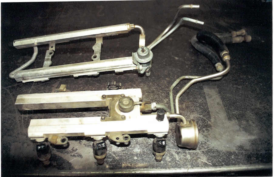

the old Gen2 rail is the problem, the regulator is an integral part of the rail...
you could fabricate something to work but the other problem is that the regulator sits Under the upper intake manifold on the gen2 engines, which for adjustment purposes makes it quite a bit tricky....
gen3 rail at the top. gen2 at the bottom..Colin

Yes thats a Caspers Electronics regulator in the Ebay auction, but its for a 3100/3400 rail...Originally posted by cutlassconvertibleHey i dont know if youre still looking or not but you can check out lmperformance.com they have adjustable regulators, but im not sure about the aplications. also check out this ebay link! http://cgi.ebay.com/ebaymotors/ws/eB...tem=2474692571
this guy was asking about regulators for the 3.1L mpfi engine. completely different.Colin
