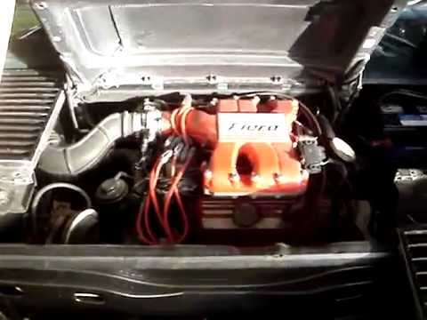

Hey guys,
I have a Fiero 2.8 that I installed a 3.1 crank and rods, along with a .040 overbore piston size. I did this a few years ago, and the motor actually ran quite well for a little while.
After a few months, the car really started to be down on power. It started making this noise:
Now, I know what you guys are thinking. That rattling is completely intermittent. It only happens when the engine RPMs really start to drop (like around 600-700). It'll make that noise, almost stall, and then shoot back up.
However, when I would take it out on the road, it really had no power over 4,000 rpms... where as before it actually pulled quite hard (respectively...). I just want to make it clear that it's not a main bearing, or crank bearing. The bottom end is solid. I can rev the motor and drive it around normally and there's absolutely no ratling. I've had a spun main bearing, and it's nothing like that.
So, a few years later (only uploaded the video last march though), I've undergone a complete restoration of the car. Entire front-end is rebuilt. Interior, front compartment, you name it. I'm at the point where I'm going to pull the motor, and replace my automatic with a Getrag.
Here's my question, I have a brand new H272 cam kit, along with a set of crane cam lifters. My engine only had 105k miles on it when I rebuilt it, and the machine shop said that the springs were still good. What he did was add a shim under each spring to increase the tension for the increased duration of the ARI Racing "Phase 2" cam that I was using. The shop seems to know what they're doing.
I really have no idea what's wrong with my motor, but I'm assuming I've either wiped out a cam lobe on that old cam, or perhaps there's something wrong with my distrbutor (cheap rebuilt distributor failing already?).

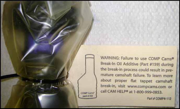

So I want to make everything right this time... and my biggest concern now is making sure that I don't damage the cam. When I first ran the V6 after the rebuild, I ran it for 20 minutes with increased idle (like 2,000 rpms or something). I used REGULAR motor oil, and swapped it out for synthetic after 500 miles. Probably not the best thing.
This time I plan to use break-in oil, even though the pistons and crank are already broken in.
I know I'm rambling here (sorry), but I guess what I'm asking is:
1 - Can you guys guess from my crappy video what could have been wrong with my Fiero? (note, the exhuast is not hitting anything, and I didn't have a cat on it at the time)
2 - How can I tell if there was something wrong with my cam. Do I need to replace the cam sprocket when I install my new H272 cam?
3 - What is the proper break-in procedure for the cam, what fluids do I need, and am I OK using the springs that I have... do I have to worry about flattening the cam lobes with these springs?
Just thought I should mention too that the car got progressively worse over the span of 6-7 years, but I only drove it maybe 1,000 miles during that time. I also left the same gas in there that's essentially been in there since the major hurricane we had here in South Florida (Wilma). So... I know that doesn't help. But as I said, everything is getting replaced. Every line, hose, whatever... I even bought an NOS fuel block w/ fuel regulator. I do plan to re-use my 17# Accel injectors which only have 1,000 miles on them.
Thanks guys!!!
