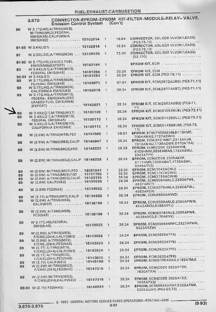

      Well sorta. My 93 GTP (9/92 prod) had a BCFA but the June 93 P&A shows the BBUK as the service replacement. I do not have the TSBs but there is a difference and am curious what it is.
      Have seen this before in 3800s (e.g. 88 ANCX increased the start fuel pump duty cycle as a response to reports of cold weather hard starting).
      Am a newbie to the LQ1 but have been studying GM ECMs & "fixing" programs since the Computer Command Control.
      Note the different part number
