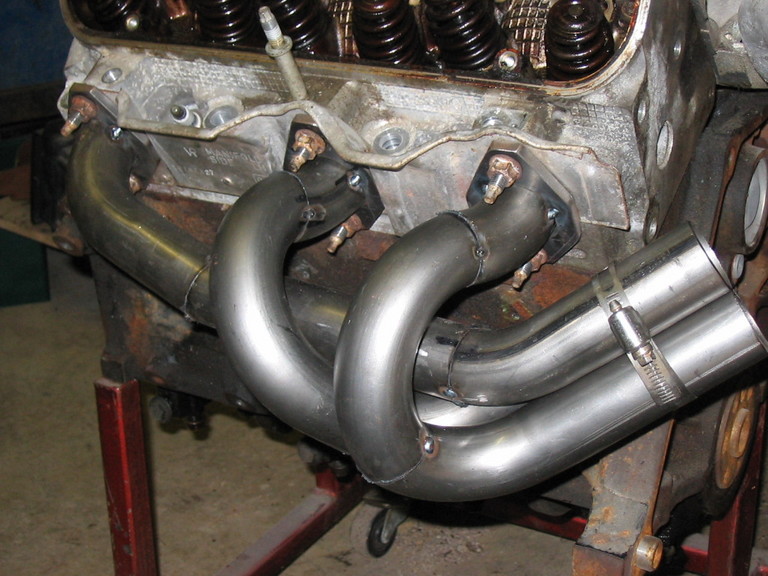

Just a couple pictures of the headers in the build stage for the Franken60

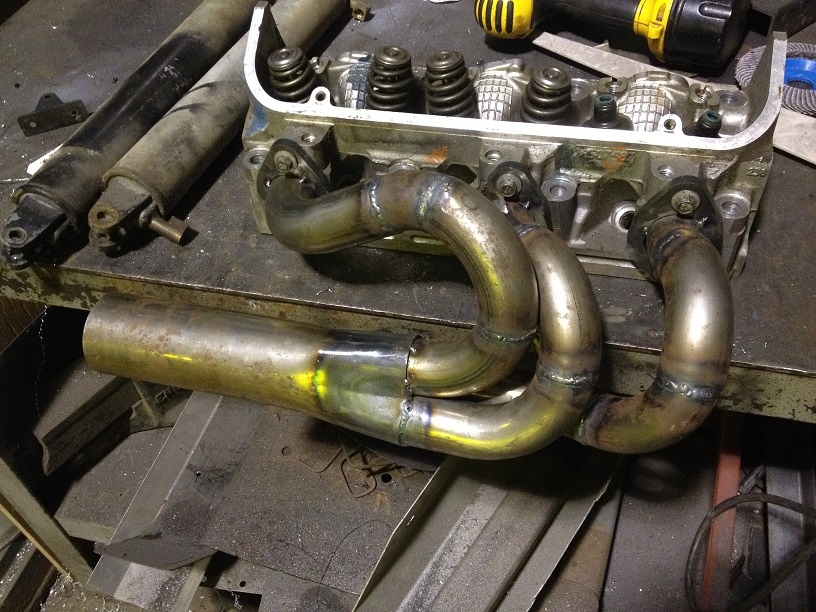

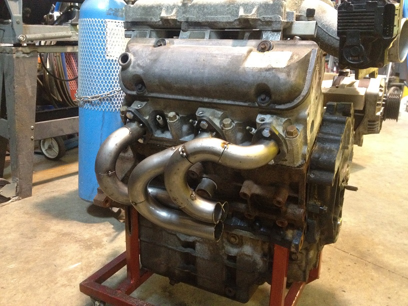

A couple pictures of the build stage of the headers for the LX9

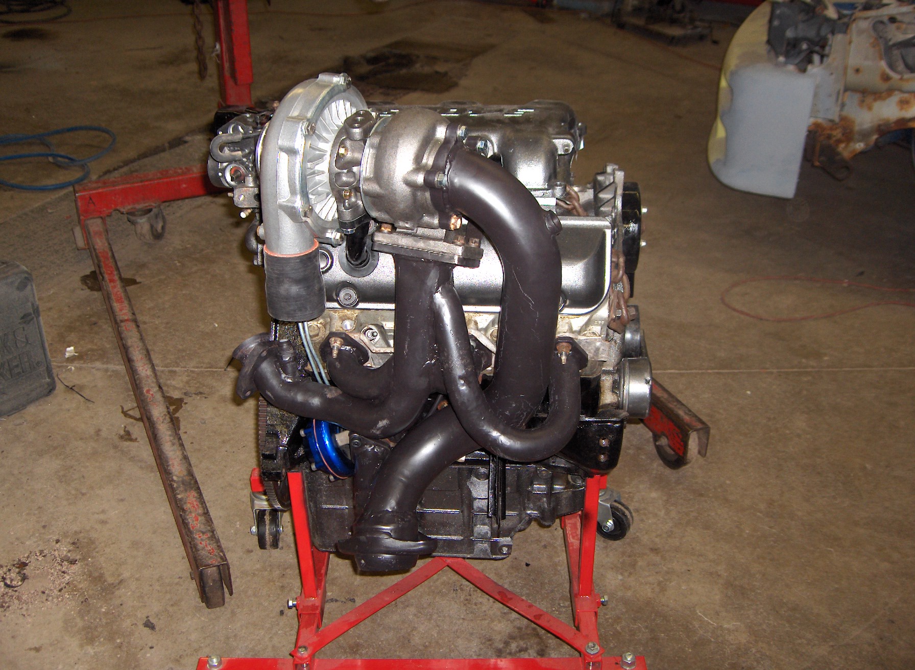

Here's a picture of the front header I built for a turbo Cavalier, this is one of my favorites.

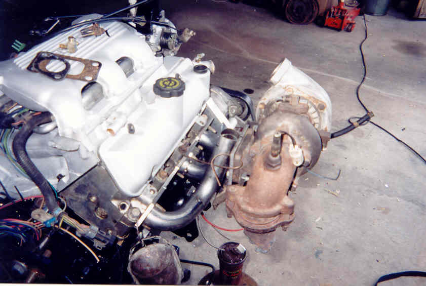

And the very convoluted rear header:
