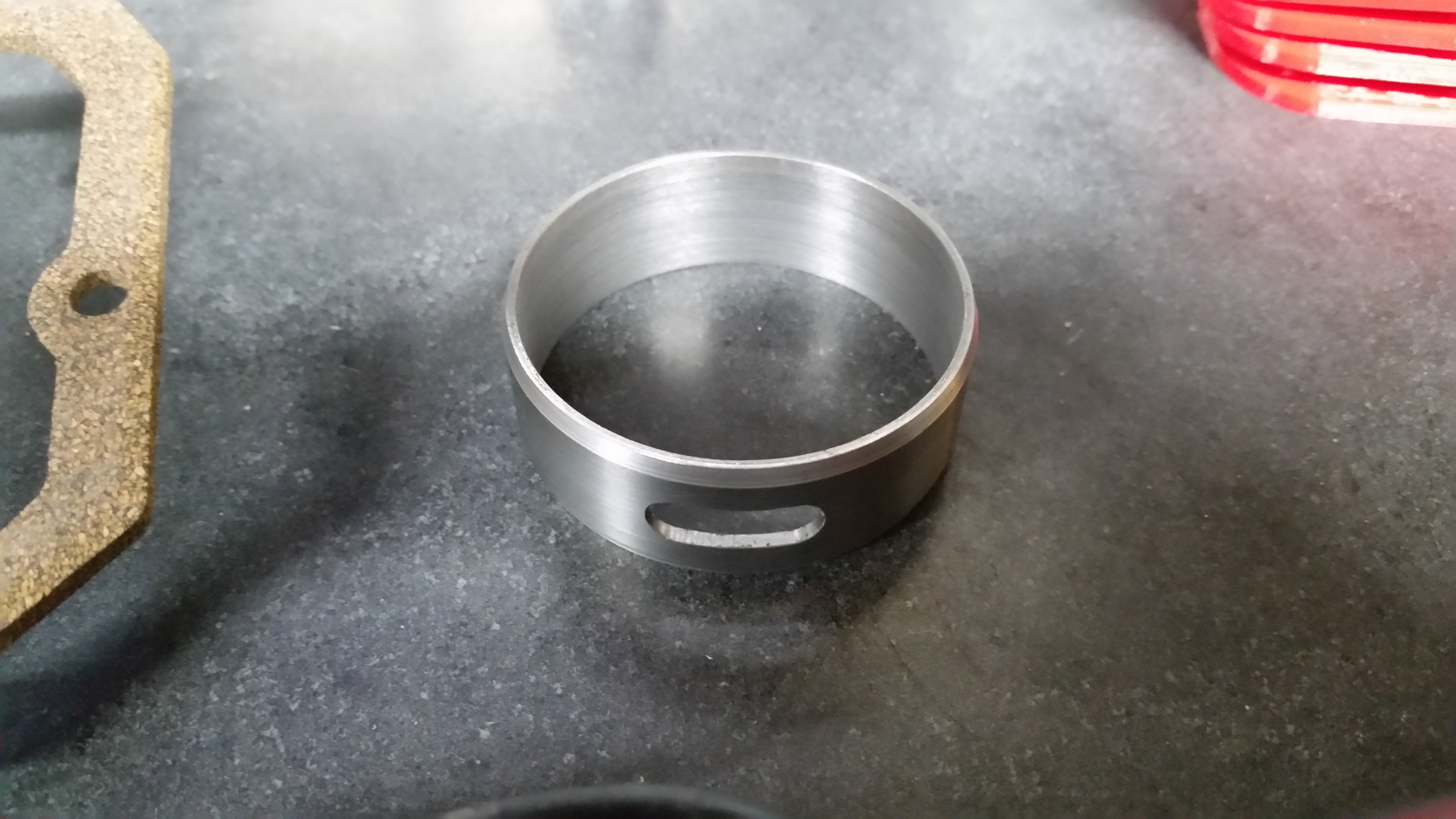

    Several people have had them made, but I don't know what cam/journal clearance they end up with after the spacers are installed and the bearings installed. ID and OD measurements basically, for the spacer. This was the first one I had made. The 2nd is still in the block as I need to get it on a table to knock it back out. ID was wrong on that one so I couldn't test fit a bearing. Should I get a 3900 cam bearing set and use those measurements for the OD? I don't know the compression rate, from press fitting them into the block vs the new ID vs old ID.

          I have a place that will make them in quantity, but I want to have 2 more test spacers made. The set I had made, because I thought I had it down, feels loose. I want to see what it takes to not fit the cam so I know the clearances. Money has been pretty tight since race season isn't happening, cams aren't available, ARP studs just got restocked, etc. Its picked up a little this month and now that I have a great source for making them, its back on track.
