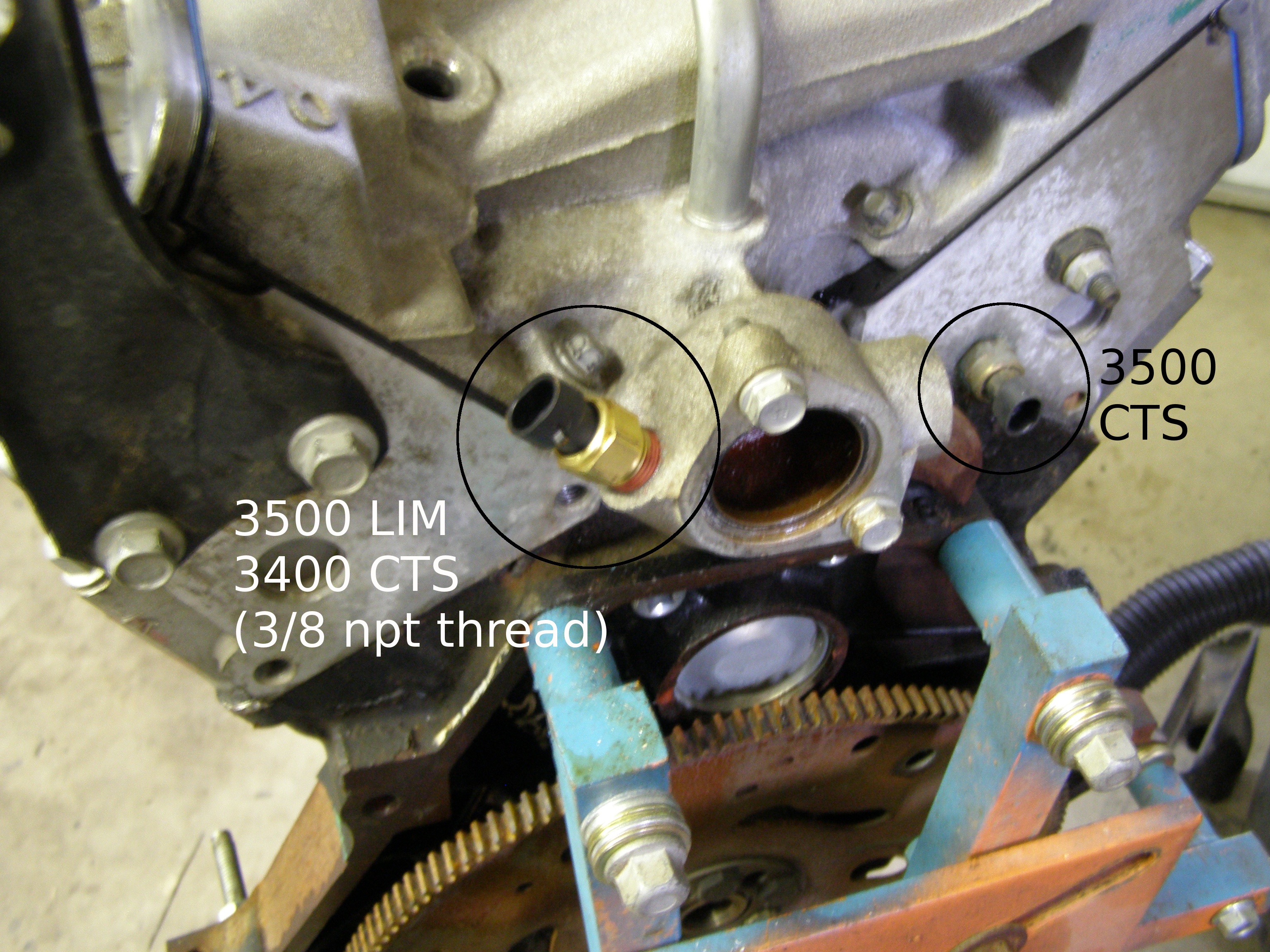

I need an external crank trigger, going to swap my 3400 intake onto the 3500 for now (am going to buy adapter later). I either need to get a wire extension for the CTS (I know that WOT-Tech has an extension for this but both it and the crank trigger have been out of stock lately. I know I can buy the crank trigger from TCE but I haven't been able to find the extension anywhere else) or tap a hole in the 3500 LIM and use my 3400 CTS. I need to swap the oil pans because the 3400 has a sensor that the 3500 does not. I also read somewhere about a mounting bracket not lining up right and only two of the three bolts being able to be used? I also read that someone swapped the coil packs and ingnition control module over from the 3400. Is it neccesary to do so? Or is the 3500's sufficient?

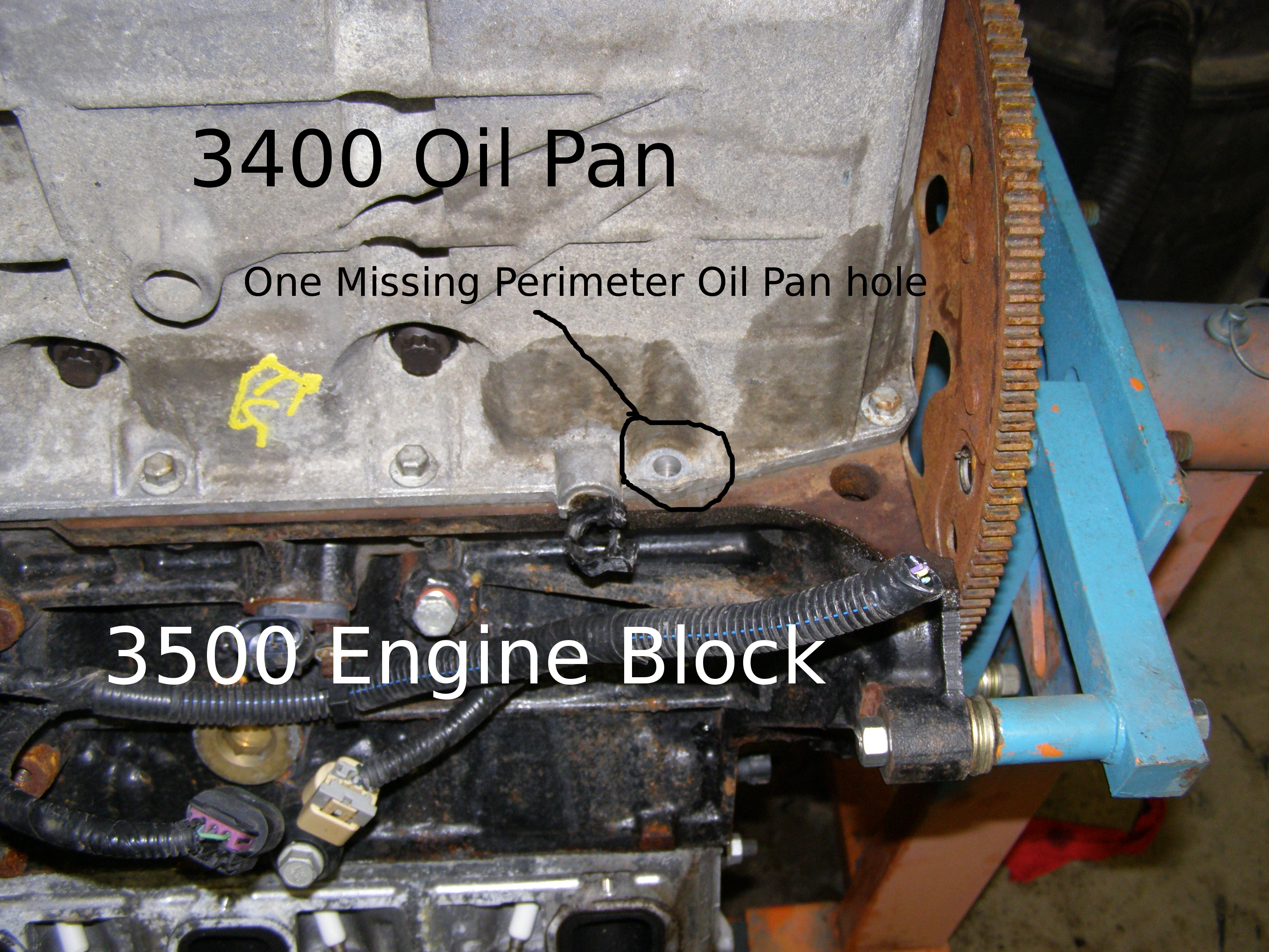

Pretty sure you have to swap the ICM and coil packs over from the 3400, as the ICM is what gets the 7x signal from the crank trigger, and sends it off to the PCM. And even though 1 person says he has been successful in swapping the 3400 oil pan onto the 3500, I personally wouldn't do it. GM clearanced the oil pan (as well as the block) for the connecting rods for a reason. I would much rather either leave the oil level sensor out (do you really need to know if your oil level is that low? I think you'd have other issues before it got to that point), or tap the 3500 oil pan for the sensor.-Brad-
That makes sense about the ICM, otherwise the crank trigger is useless. And I wasn't sure if the sensor in the oil pan was the oil level sensor or not. And no, I don't need it. I just read somewhere that someone had swapped the pans. I thought maybe if the level sensor wasn't plugged in that it would throw a code or a check engine light. I won't worry about tapping it then. Now I don't have to worry about buying an oil pan gasket.Originally posted by bszopi View PostPretty sure you have to swap the ICM and coil packs over from the 3400, as the ICM is what gets the 7x signal from the crank trigger, and sends it off to the PCM. And even though 1 person says he has been successful in swapping the 3400 oil pan onto the 3500, I personally wouldn't do it. GM clearanced the oil pan (as well as the block) for the connecting rods for a reason. I would much rather either leave the oil level sensor out (do you really need to know if your oil level is that low? I think you'd have other issues before it got to that point), or tap the 3500 oil pan for the sensor.
I *think* it still needs to be plugged in, or possibly shorted across. Can't really remember. I know people have talked about it somewhere. Try it out with it unplugged and see if you get a light. If not, then you are good. If so, short across the terminals and the light should go off.-Brad-

2) CTS - I tapped my 3500 lim for a 3400 sensor
3) Oil Pan - As you said. not necessary to swap if you dont want the sensor, looking back I probably would not do it again, but its too late

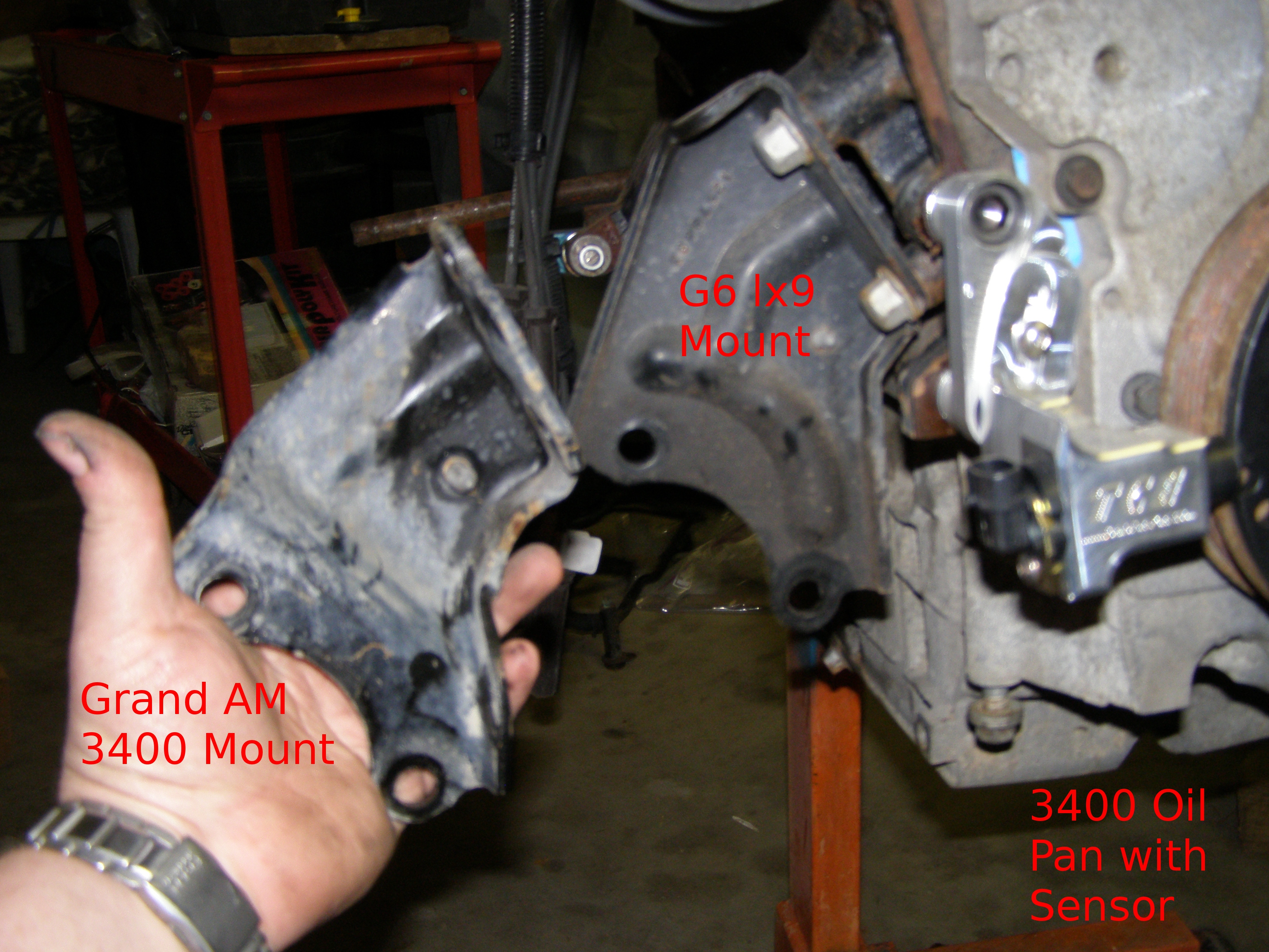

4) Engine mounts - You have to use the rear upper mount from a G6 and the lower one from your grand am works fine with no drilling

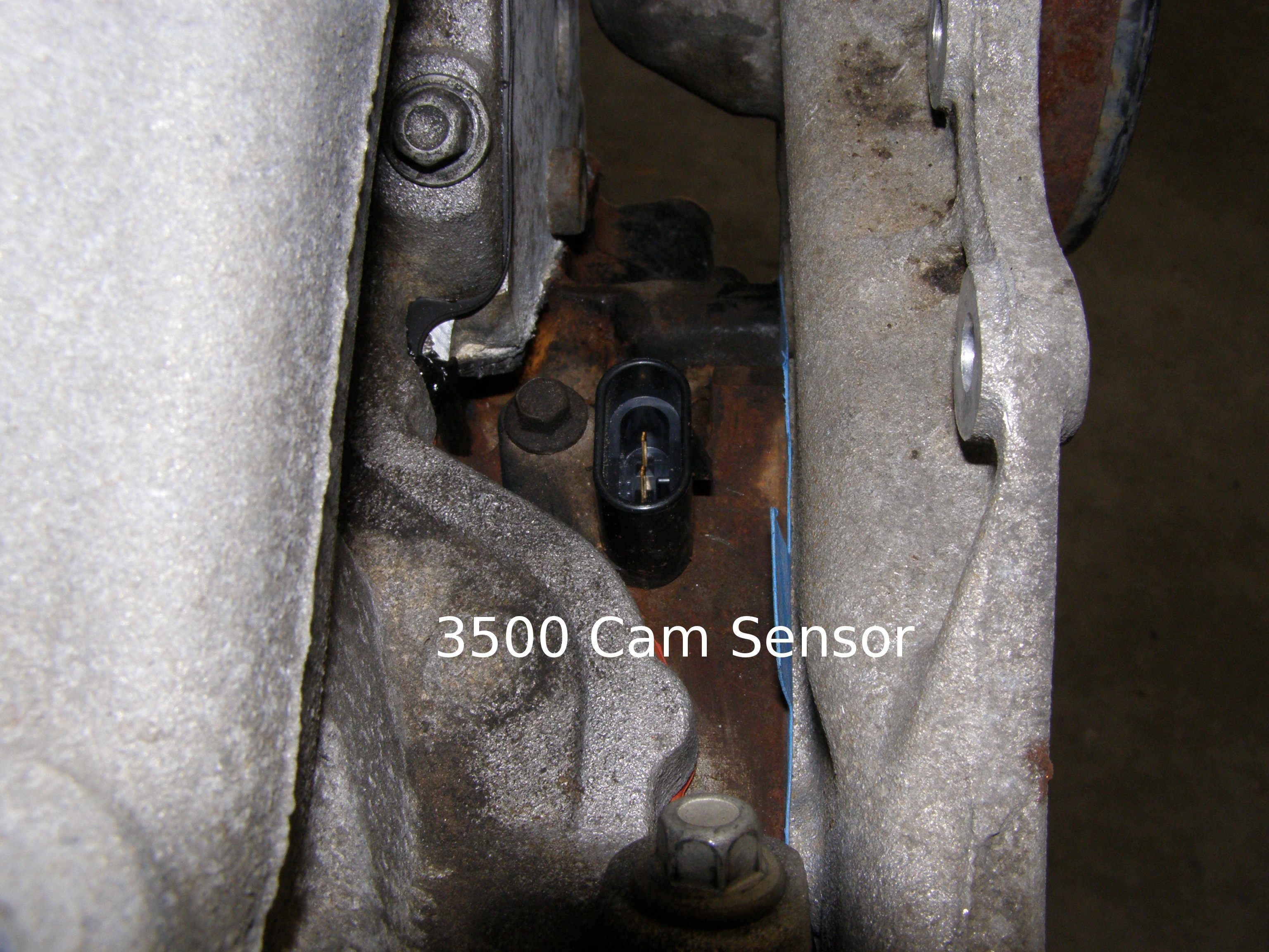

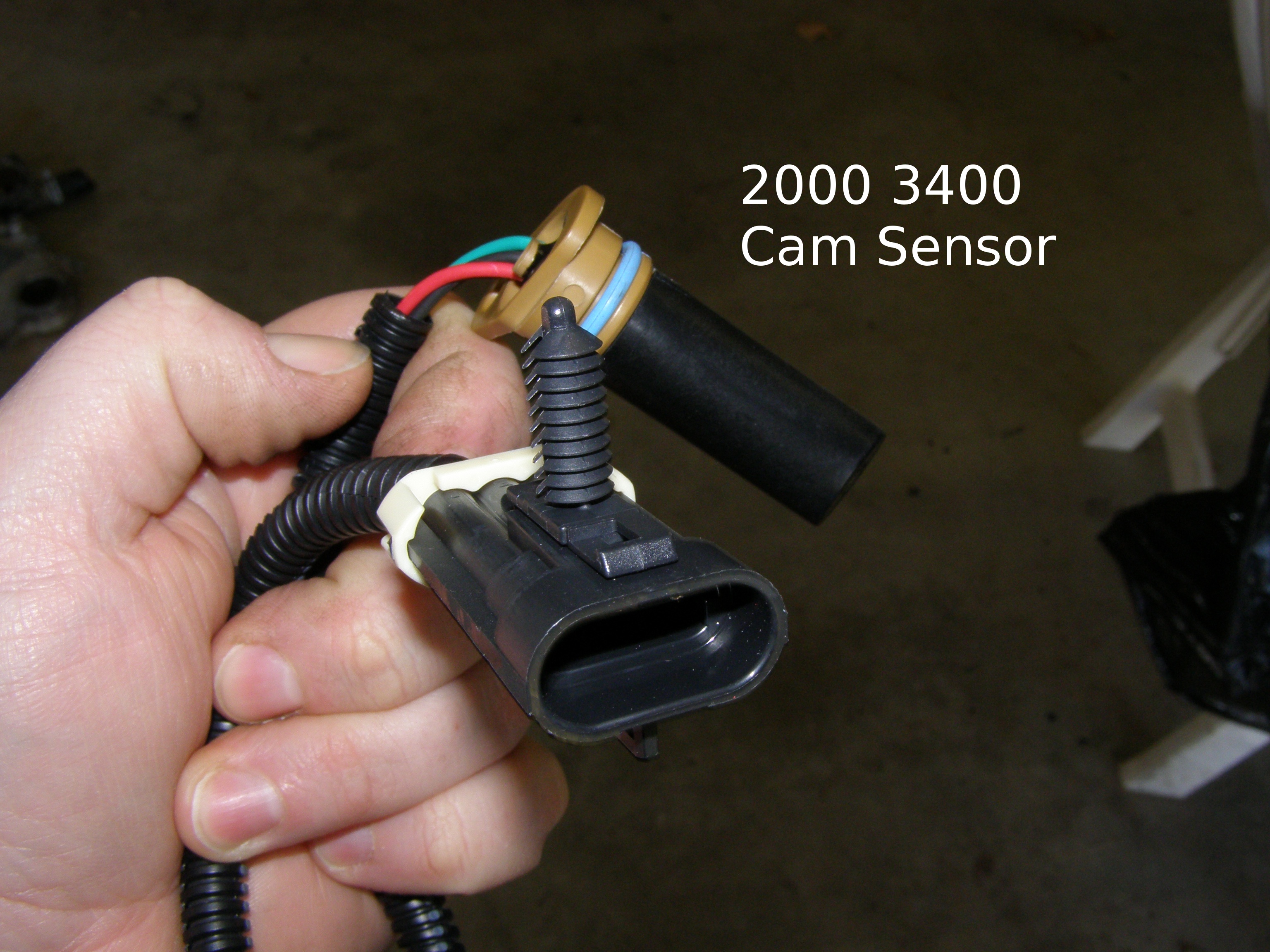

7) Cam Sensor - if you have a 2000 GA your cam sensor needs to be on a pigtail. the 3500 sensor just pulls right out. take out the retaining bolt and pull it out. Plug the new 3400 one in with the pigtail and bolt it down.

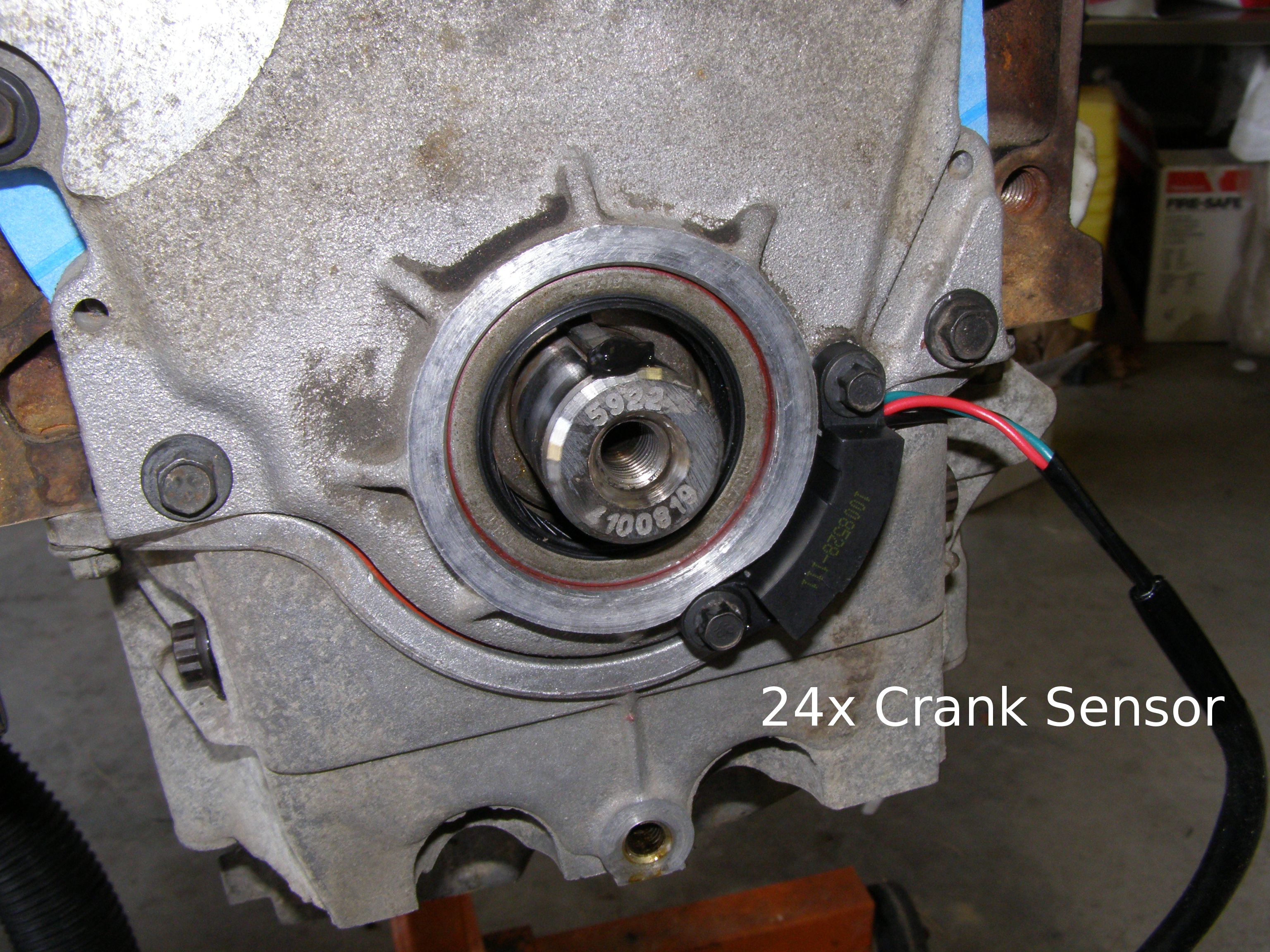

9) Timing cover - the timing covers are nearly identical but your accessory arrangement is different. you also will have to install a 24x crank sensor on your timing cover behind the crank pulley. You MAY also have to do a CASE relearn with this. I lucked out this time. It runs perfect, but I'm gonna do one eventually when I have the tools just in case.

I've attatched some pictures.

Ok, I just need to clear a few things up:
In regards to the cam sensor. Are you saying I need to GET a pigtail or just use my cam sensor from the 3400 that has a pigtail?
Since there are different accessories, do I need to swap timing covers then? And will I have to purchase the 24x crank sensor or does one of the engines already have this and all I need to do is swap them? Also, does the case relearn have something to do with the PCM?

Also, I don't have the 3500 yet, its on its way. I am not sure if it will have the G6 bracket on it or not. If not, can the slight angle difference be modified slightly to make to make it work?
Swap the cam sensor from your 3400 or buy a new one meant for a GA.
Its worth it to swap the timing cover IMHO. The 3500 does not have a 24x sensor on the timing cover.
You can modify the bracket from the GA to fit the 3500 block if your good at welding or know somebody who is.
the holes are allready there to swap the 24x sensor. so swapping the cover is kinda useless.Originally posted by HOYS View PostSwap the cam sensor from your 3400 or buy a new one meant for a GA.

Exactly. The hole are already there. I never said to swap timing covers, just said the accessory arrangement was different haha. But I did swap timing covers, but only because mine was broke at the water pump.Originally posted by mickaz View Postthe holes are allready there to swap the 24x sensor. so swapping the cover is kinda useless.
