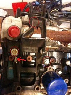

    Now the other good news, I got the a/c bracket to bolt up. I had to cut out a spot from it where it hit a mounting boss on the block meant for the stock 3500 a/c compressor. Also had to bend up the heat shield on the manifold. 3 bolts hold it (circled in red), one into the head, and two into the block. This will be sufficiently strong to hold the a/c compressor but will it be strong enough to use the dogbone mount? I also need to consult my factory service manuals for the 91 to make sure that this bracket is correct for my a/c compressor. The last pic shows the "C" shaped part of the bracket where the compressor would bolt up.
Name:	aircon bracket.JPG
ID:	376488 Click image for larger version
ID:	376489 Click image for larger version
Name:	ac compressor bolt up.JPG

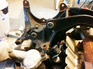

    1st pic - That looks like the automatic trans mount on the drivers side of a W body.

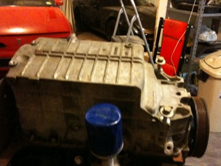

    2nd pic - I can't help you with the A/C but I think that the only A/C you can use is the one that came on the 3500. I never installed the a/c compressor or the passenger side upper mount. I just have one upper mount on the driver side.

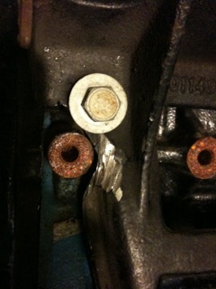

    3rd pic - the holes are in slightly different positions. You will have to open up the holes your bracket to make it fit.

    started a topic 3500 Swap Finally Underway, a few questions
    After a year of delays I am finally getting started.
    I collected most of the parts over a year ago. I believe I have all the major items to make this work in my 91 Grand Prix:
    LX9 engine
    3x00 alternator and 3x00 alternator bracket
    3x00 power steering pump
    3x00 ICM and coils
    3400 balancer
    3400 injectors and rail
    lower engine mount and bracket from a 3100 w car
    a/c bracket from a 3x00
    TCE crank trigger setup
    new gasket set (metal lowers)
    spare getrag 284 that shifts perfectly and a new clutch set
    I'm sure there is more I am forgetting
    I think I want to get a set of 3400 exhaust manifold. I was initially going to use the LX9 manifolds and weld up a crossover to make it work but I think I want to go for simplicity here.
    Before I pull the 3.4dohc out I want the LX9 basically ready to go right in. This means replacing the lower intake gaskets, installing the crank trigger, balancer, and the necessary brackets.
    This evening I removed the 3500 wire harness and began to mock up some of the parts. One thing that bothers me a lot is the a/c bracket. This thing doesn't want to line up at all. It even seems like it will hit the exhaust manifold. What needs to be done here? I think the bracket I have is from a 3x00 w car but its been so long since I got it that I can't remember. What is the solution here? I want this to work with the a/c compressor from my 91 3.4dohc.
    There is an oil filter adapter on the LX9 that drops the filter lower. This won't work on a w car, it wont clear the subframe. What can I expect to find under there when I pull the adapter off? I need to be able to mount an oil filter without that drop down adapter.
    Left Side Pic- the 3100 lower mount bracket. Not exactly sure how this mount without interfering with the crank pulley, am I holding it wrong?
    Middle Pic- the a/c bracket against the LX9, not even close? wrong part? oriented incorrectly?
    Right Side Pic-, will the bearing mount for my getrag 284 intermediate shaft bolt up correctly to the side of the block?
