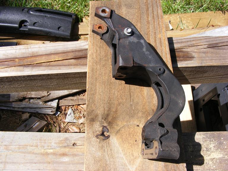

If I had all the remaining parts on hand and the physical ability, it is a Saturdays worth of work to get it in a driveable state. I guess I can be a little more optimistic that I can finish it in time since it really isnt much work left. If I could get the mechanical stuff done in the next 2 weeks that should still leave me some time to get a decent tune that will pass the sniffer test. Even if I can't find the dogbone bracket for the drivers side I'm sure it could be driven gently with just the passenger side one, also keep in mind that I used the pushrod lower mount that is beneath the balancer and the DOHC rear mount so it is already a little stiffer than a normal pushrod engine would be. I didn't use the DOHC front mount though, thats what lets the dohc get away with only 1 dogbone on the drivers side. I wanted to take out the lowering springs in the front and put the stock height springs back but that can wait.
