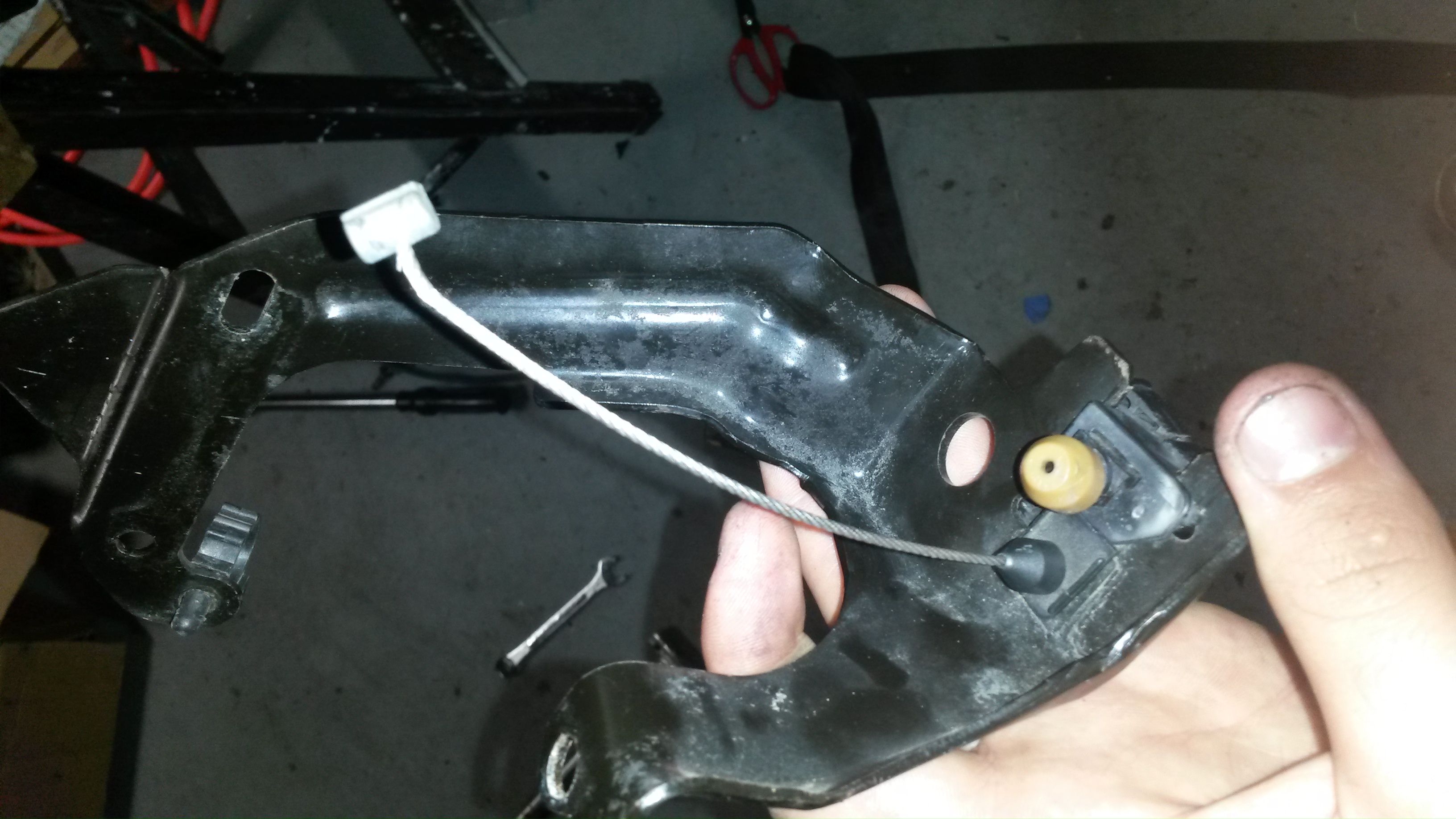

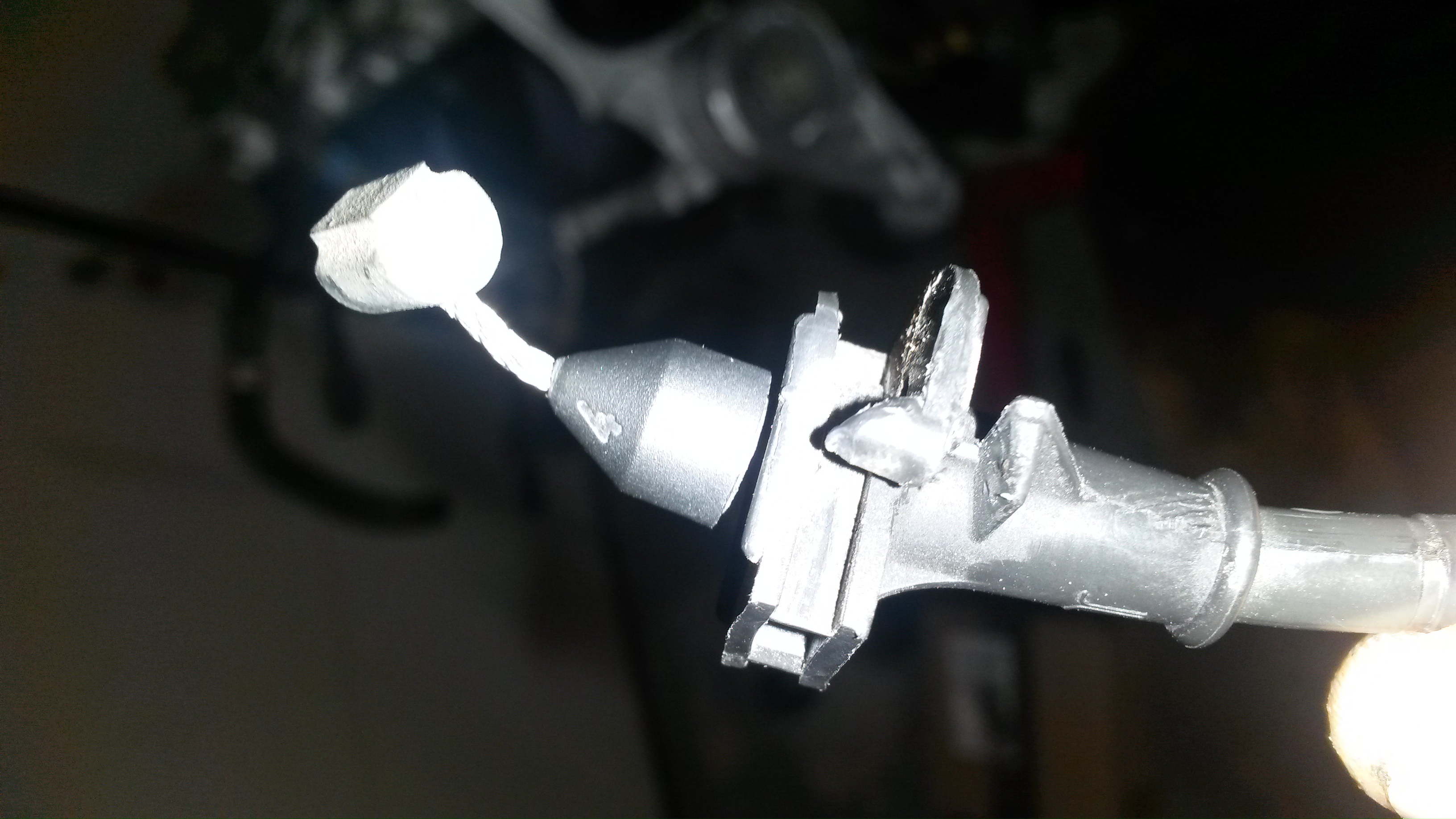

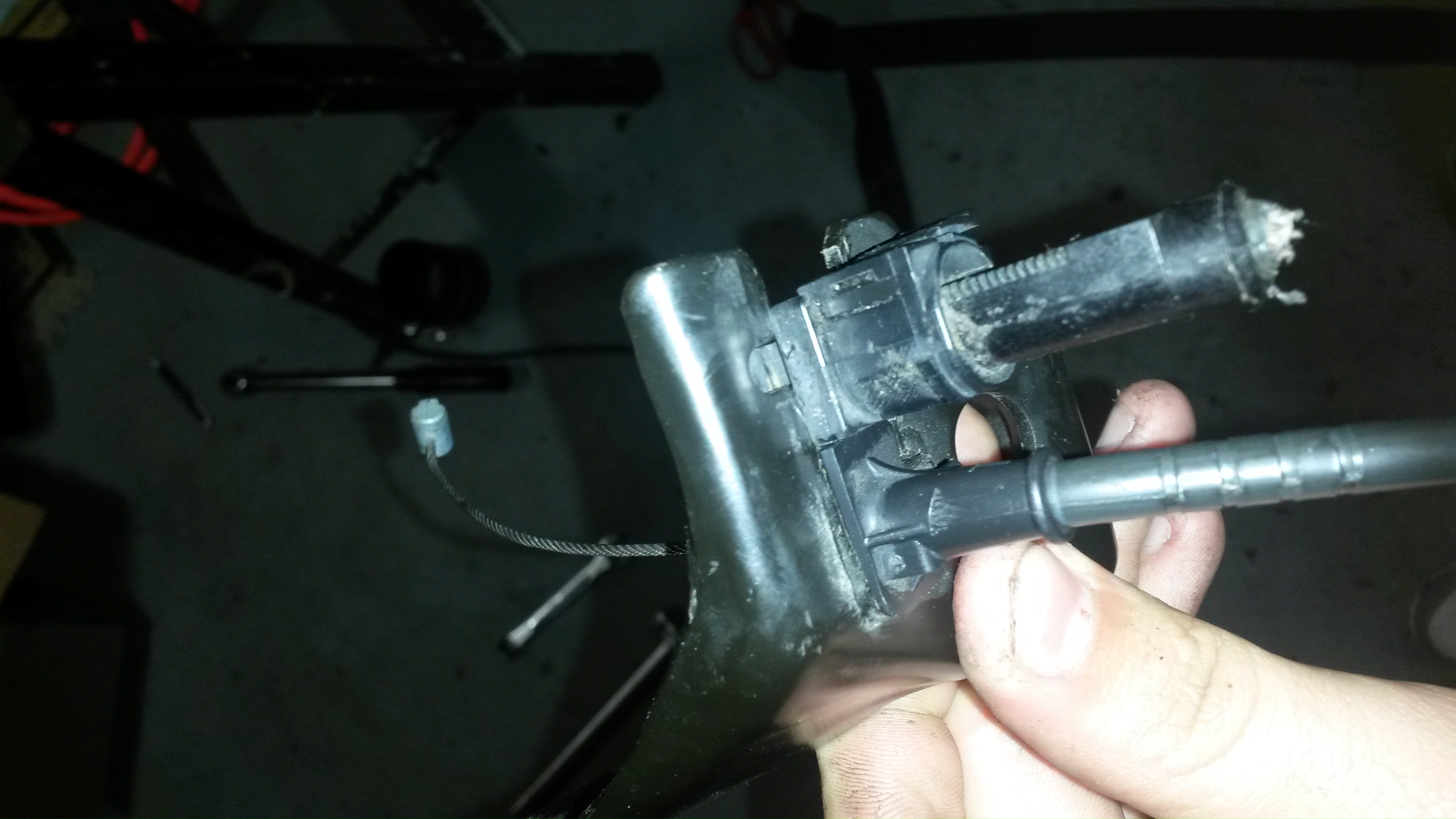

The cable may still work though, you'd have to post a pic of the end.
3100 Corsica/Beretta cables are a perfect fit if you can find one.

it had a 3100 but it did have the motor mounts like the GAGT right on the rad support. looked like it belonged in there lol. i think the end is different it looks like one from a bike brake cable. and superdave i did mean to tell you i plan on deleting the EGR assembly, seems like a waste of time to adapt it its already a QQ in newjersey next year! lol i also bought a spec stage 2+ clutch ive read good things but id like to hear it from the master. and i cheaped out and bought an oem replacement flywheel. it should be alright tho. my thing is is i joined the marines and im leaving for bootcamp in october. the clutch will be here at the end of the month and i still need to buy the chip and make an egr delete. i want to get this swap done before all of my friends leave for college so im not on my own, roughly the end of august. i hate to be pesty and needy but im on a time restriction. as for the egr i plan on just buying a piece of metal and drilling the bolt holes to cover the intake, i also read to buy a bolt to go into the manifold. does that sound like it would work? im pretty good with a wrench. but im a little shakey on my own car i like to hear from other people that it does work. any information again is greatly appreciated guys thanks!

Cable looks right, and that's the right bracket as well.Last edited by Superdave; 07-12-2013, 11:12 AM.
