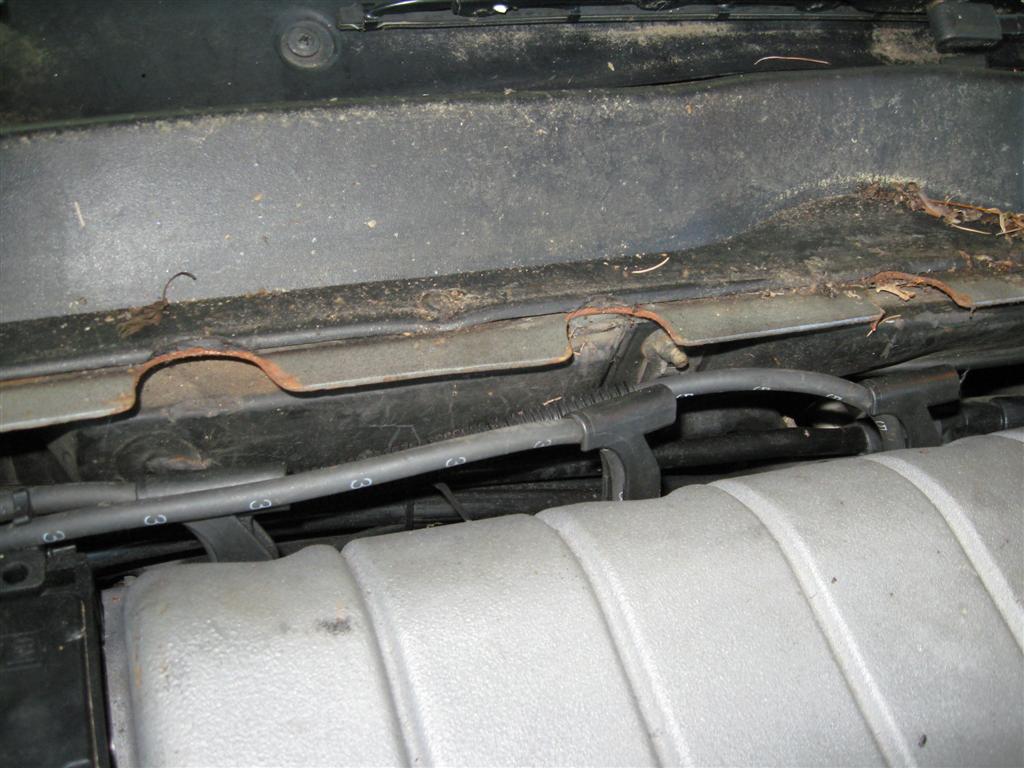

      As for the plugs,,, I used to pull the DogBone mount and use a small come-along to rotate the engine forward. Later I got wise and used a hole-saw to make cutouts. I can do the plugs in about 5 minutes,,, literally....

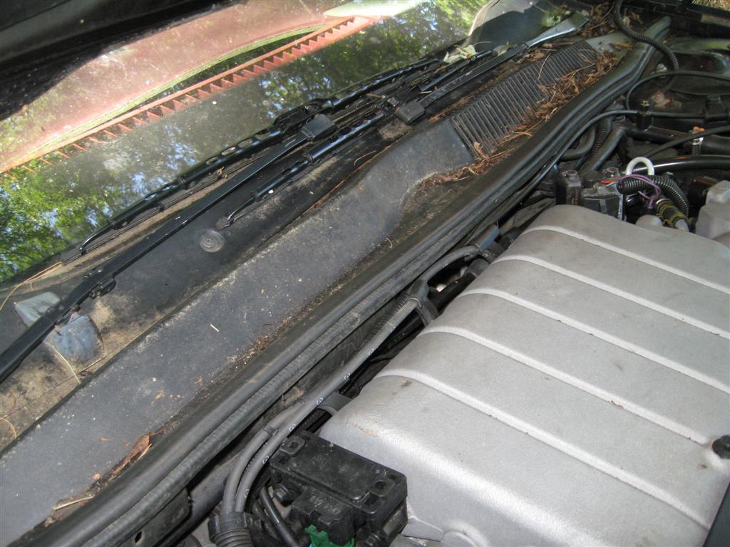

            3.4 tDC to be fair, other than the timing belt, alternator and any thing else in the lower rear or the motor, the rest of it is straight forward with the spark plugs being rather easy. the Body does get in the way of the rears but there are ways to get around it, as shown.

                I used the same idea as yours except i didnt cut,I just bend the the steel up and just bend it back after doin the rear plugs.
