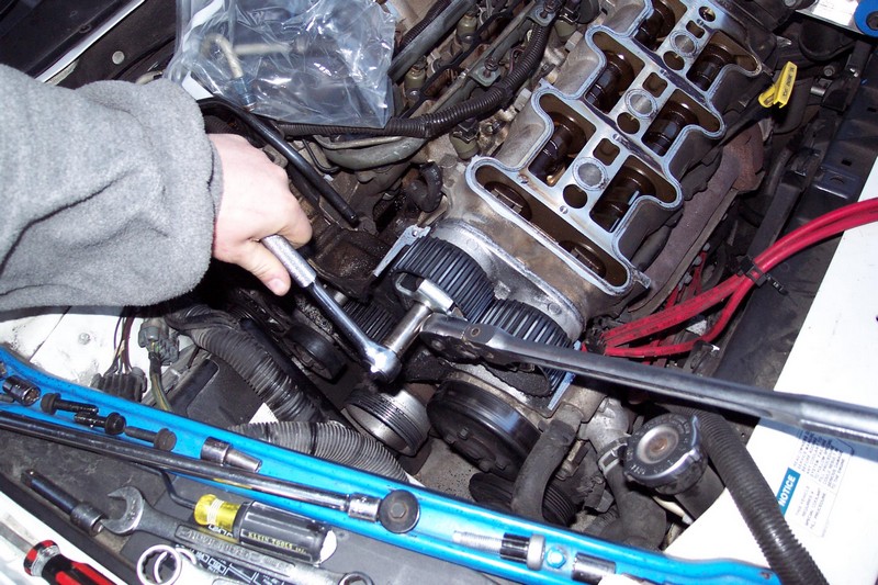

My apologies if this is a stupid question, but after reading the Sticky, I was left wondering the exact order in which to tighten down the CAM gears.
I'm working on a 95 3.4...I get the flats up hold downs front and rear to start, but then there is mention of rear exhaust timing after turning the crank 360 degrees, all after reinstalling the idlers and tension pulleys.
So the question, is when do I tighten the front intake and exhaust? The rear exhaust is apparently after 360 degree crank turn for timing, but what about the rear intake?
This car would be fine with stock timing, I don't plan on keeping it, so when would I tighten down the CAM gears for stock timing?
It was a long day, maybe tomorrow I'll think I'm a dumb a$$, but better to ask twice and fix it once then the other way around. I'm old school small block chevy, 18436572, I don't have a lot of wrench time on OHCs.
Thanks for your patience.
Kihl
Alright, a little more research....so If I understand correctly, TDC with front flats up, lock down front CAM gears. 360 degrees with rear CAM gears loose, rear flats down, tighten rear CAM gears. Is that correct? Thanks again
