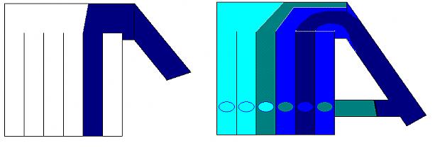

                            Ok here is a pic of what im talking about... on the left is the simplified air flow on a normal 96-97 intake... air comes from the TB down the arm and into the runer to get to the port.
                            in the dual runer.... if you dont have butterflys at the runers, the port will not only suck air from its runer and thru the arm, but it will pull air from the nieboring runners thru the hole even if the second TB/or cutoff is open or closed. this effect will supply the port with more air flow and be as if you had a much larger runner.... this will hurt Tq.
                            The SHO and all the variable runer intake manifolds i know of have the butterfly at the runner to stop flow from jumping to other runners.
                              sweet thanx. i suppose i will have to ponder on it for a while.
