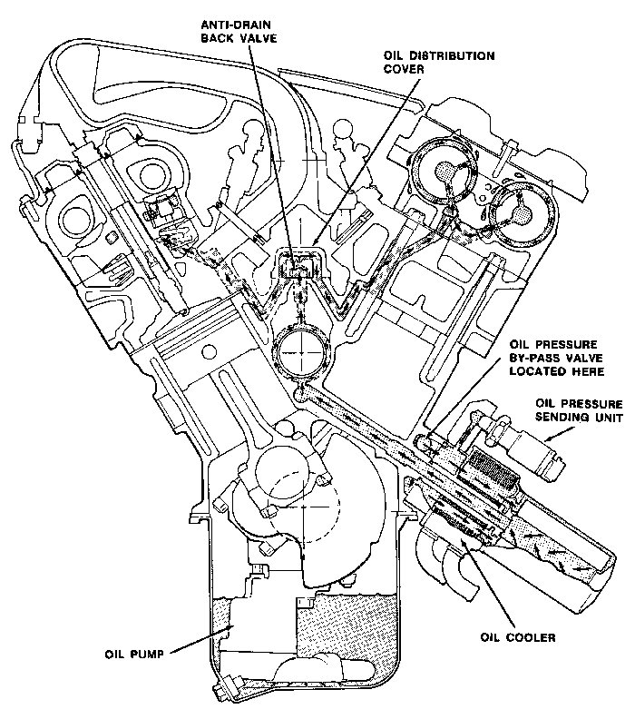

The bypass works by a pressure differential accross the filter. Therefore, if the filter flows enough to prevent a 15psi drop across the bypass, the bypass will never open. This is fine. The engine will operate as you intend it to: no bypass.
If the filter is a restriction, there will be a pressure drop across the filter. The pressure drop across the filter is proportional to the reduction in flow. If the pressure drop reaches ~15 psi, the bypass begins to divert oil around the filter to ensure that the filter does not prevent full oil flow to the engine oiling passages.
Therefore, if you block off the bypass doing so only has an effect if the filter was restricting flow, and therefore you are forcing restriction of flow by the filter by blocking it off. Leave the bypass alone! It only helps.
And consider this. The oil pressure sensor on the oil cooler comes AFTER the filter, not before.
You can also look at the factory service manual oiling diagrams I have attached to this post. The location of the oil pressure sender is clearly pre-filter. I have confirmed this by inspection of my own oil cooler. If anyone has one removed from their vehicle, they could take pics for you as well.
