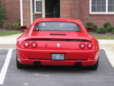

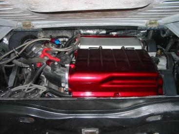

I was planning on doing a turbo install on my 97 dohc (87 rebodied Fiero) and am thinking about ways to beef up the engine before putting the squeeze on it.
I've already got the ARP rod end bolts and main cap bolts but would also like to replace the head bolts with ARP studs.
Other items on the wish list would be lower compression forged pistons, stronger rods, forged steel crank, four bolt end caps, girdle etc.
I've seen posts about trying different forged cranks and 3100 main caps but has anyone actually done it?
Is there a proven list of parts that interchange from other engines that results in a stronger bottom end?
I may have to pull my engine to repair a bad head gasket so it would be a perfect time for a highperf rebuild.
