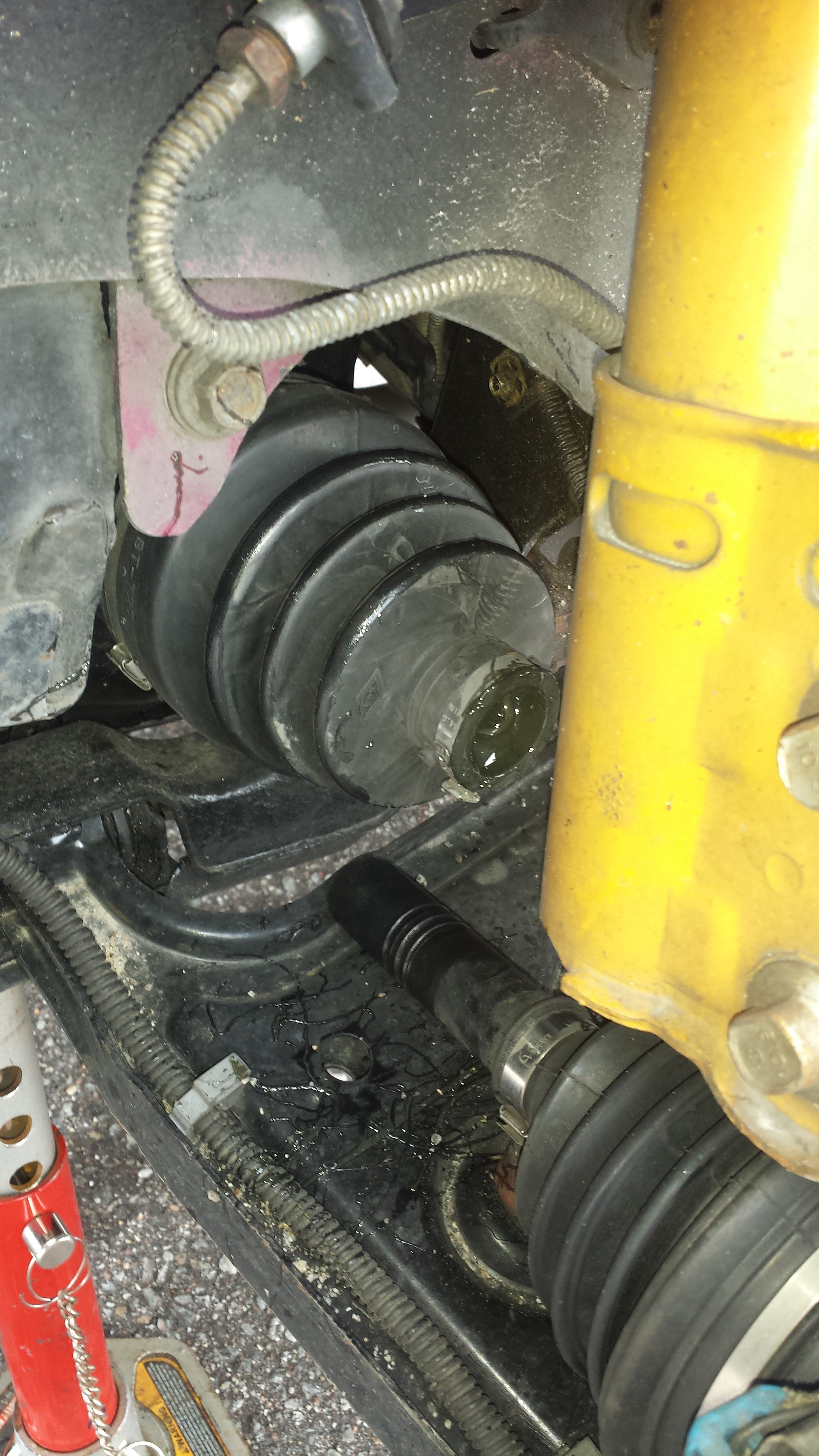

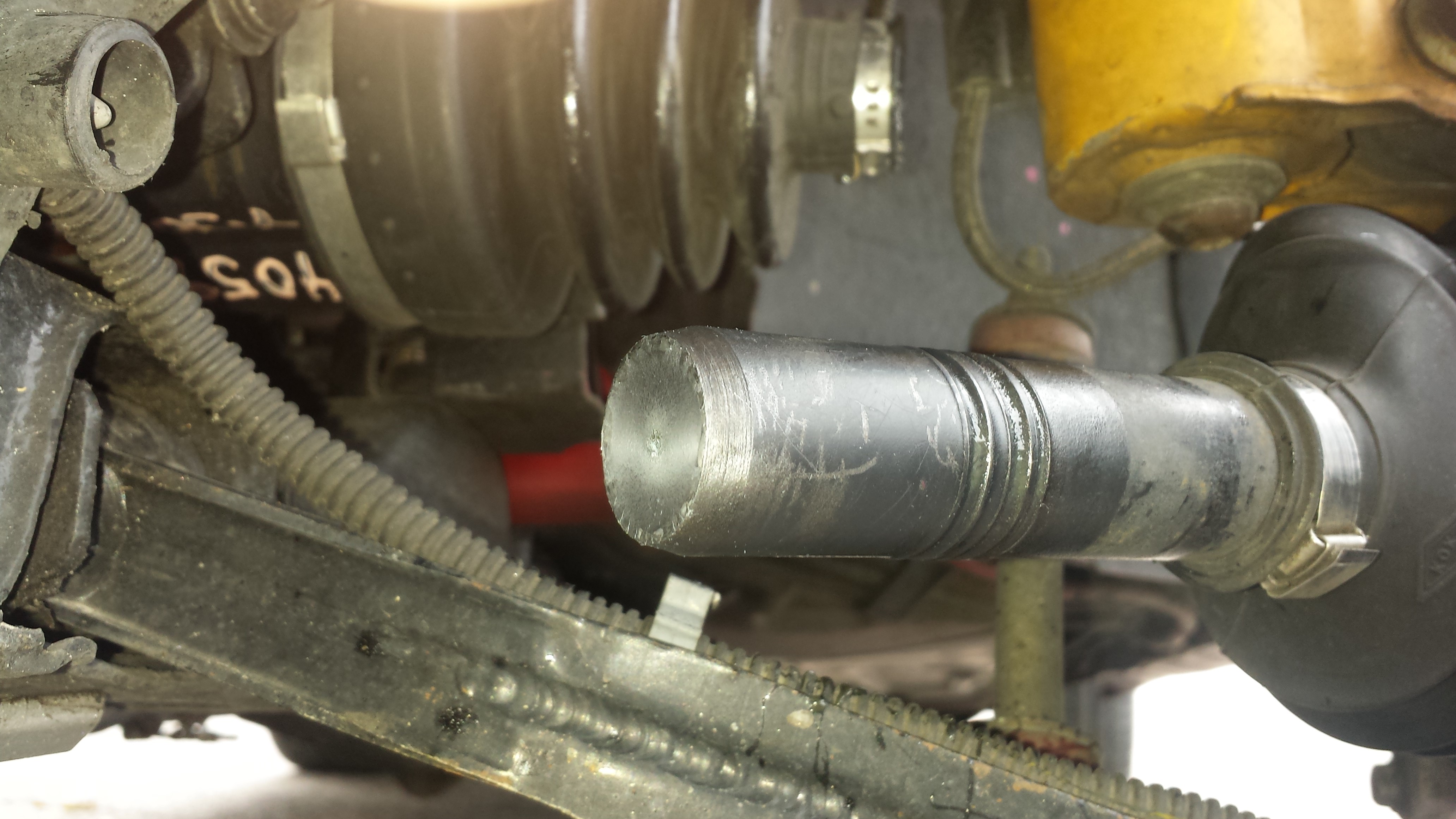

A few issues on the way is my passenger axle boot hit or rubbed something at some point which then ripped a hole in it so it sprayed grease everywhere... Axle grease is now on my list of hated car fluids... I just pulled that axle out last night tore it all down and replace the outer boot... man I hate that grease. Other action items were to replace the temporary fuel pump I put in down in TN for the one I ran last year. I'm trying to keep the bucket in tact this year to see if that works and can flow enough into it to prevent the pump from starving itself but that would also give the pump better cooling when the tank does get low since it stays submerged. The last issue I had were the rear spring bump stops were dead and on every bump on my way home I would bottom out and due to the Neon rear disc swap my tires would rub the quarter panels. I need to do something with that configuration that will tuck the tire in just a bit more so I don't have to worry about rolling the rear quarters or something like that. SO I pulled the upper spring mounts and ripped out the bad bump stops and installed some universal poly ones so hopefully that will prevent against future bottom out's and protect the shocks better.
