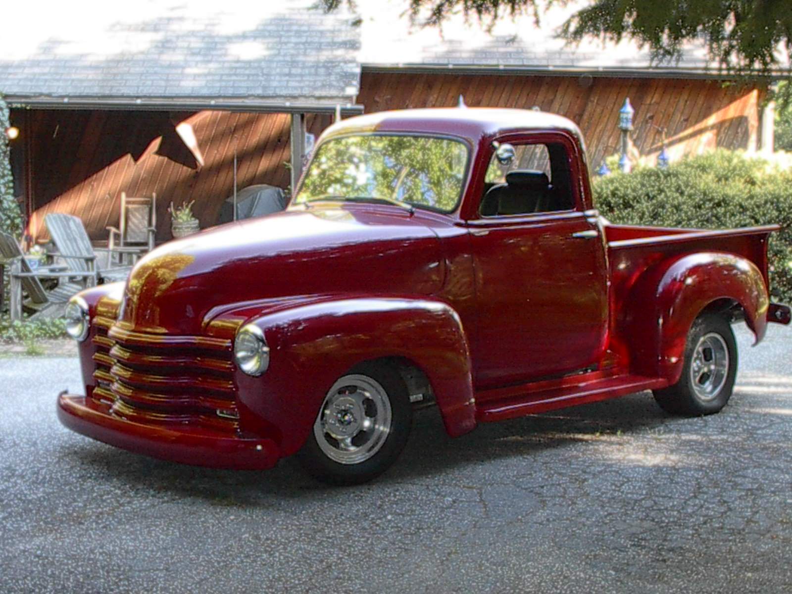

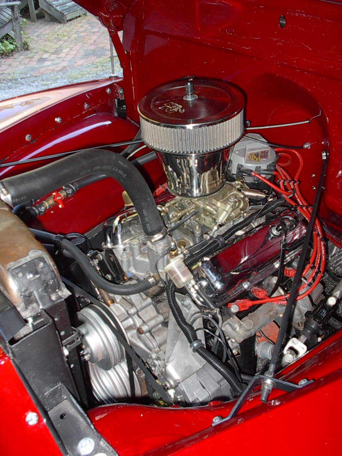

    I have a '49 Chevy pick-up with an '82 Camaro 2.8 V-6, T-5 tranny, Mustang II front suspension and Corvette rear. I uploaded a couple pictures.
    My engine has spun a rod bearing, so I am looking at swapping it out for a '93-'95 3.4. I understand that I can use my carburator manifold, HEI Citation distributor, starter, front cover, water pump, etc. from the 2.8, but I need to keep the new internally balanced 3.4 engine flywheel. I would like to keep the engine swap as simple as possible.
