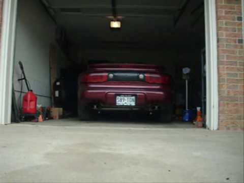

I've lurked over here a little bit, even if I don't have a supported platform so to speak. Figured I'd showcase some work from John at 60°Inclusive that he did on my 90°V6
I'll post the rest of the stuff later.
My car:
The goods:
A vid:
The list:
