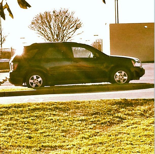

So I've got a 2005 Chevy Equinox with as many mods as I can muster with the lack of support for Theta Platform.
Suspension:
Front-
Monroe struts for a Saturn Vue ( Part# 72217/72218 )
Monroe strut mounts
Sprint 2.25" drop springs
Moog end links
Energy Suspension poly sway bar bushings
Special Products camber bolts
Rear-
Monroe shocks for a Saturn Vue ( Part# 911258 )
Sprint 2" drop springs
Special Products camber nuts
Performance Mods:
Gibson Catback exhaust ( Part# 315589 )
Spectre Cone filter w/ 3" inlet
eBay special intake arm with silicone adapters
Exterior Mods:
GM Black Housing Headlights (Part# 17801273 )
GM Black Housing Taillights ( Part# 19159625 )
Automax Black Billet Grill Insert
Power Stop drilled/slotted front brake rotors ( Part# AR8271XPR )
Interior Mods:
Iggee synthetic leather front/rear seat covers (black with tan centers)
Pontiac Torrent black dash pieces and vents w/ chrome pulls
Saturn Vue white gauge face on stock Equinox cluster
Nifty Catch-All tan carpeted floor mats front and rear
I'm hoping to get some info on performance mods from the site. I'd like to get some more info on the Cams/LSX springs available for this thing.
