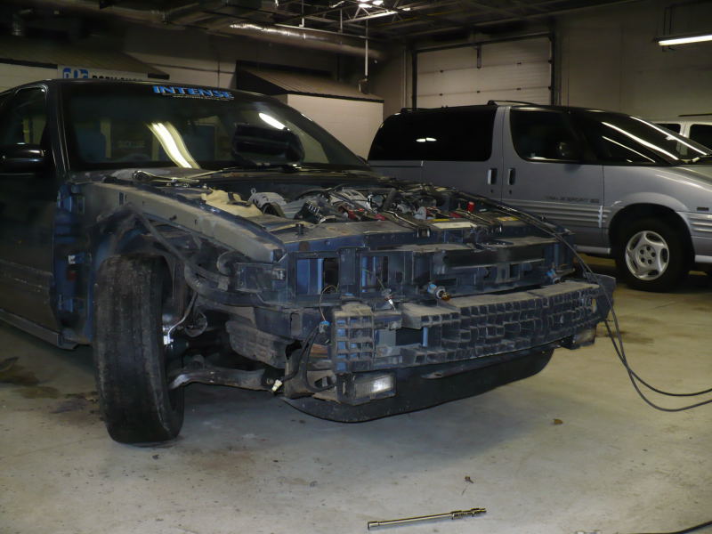

Well, all my parts, except the hood, and fender skirts are here. Everything except the header panel is off. Car sure does look naked. We do the oil changes for the local P.D., and they had two cars in there, and the car was outside, and got inquired on, and some interesting looks. This may go quicker than anticipated, but will probably cost a little more than anticipated. I've got about $500 in this so far, and have another $100 or so. I'll end up about $300 over budget on this, so the intercooler radiator will have to wait, most likely.

This job has turned in to an incredible nightmare. This is ANYTHING but a bolt up procedure. Heavy modifications to the front fenders are necessary to even open the doors. As a highlight, I will end up using my sedan lower fender mouldings, and the wheel well should hopefully break up the difference in the pattern between the front bumper and the doors. That's the hope anyways.

I never realized just how off those fenders would be. I always thought that they were the same, and the only difference would be where the cornering lights mount up.
I am glad you are doing this, despite the nightmare. This will help other people in the future if they decide to go this route.

We didn't either, but they've got a body line in them that the pictures kind of show. Of course, my car just doesn't have it. Thankfully, it took us all of two minutes to figure out how to fix that problem, and another three to figure out the mouldings.\"NASCAR is an integral part of my life. A part of me died when Dale Earnhardt died.\"
