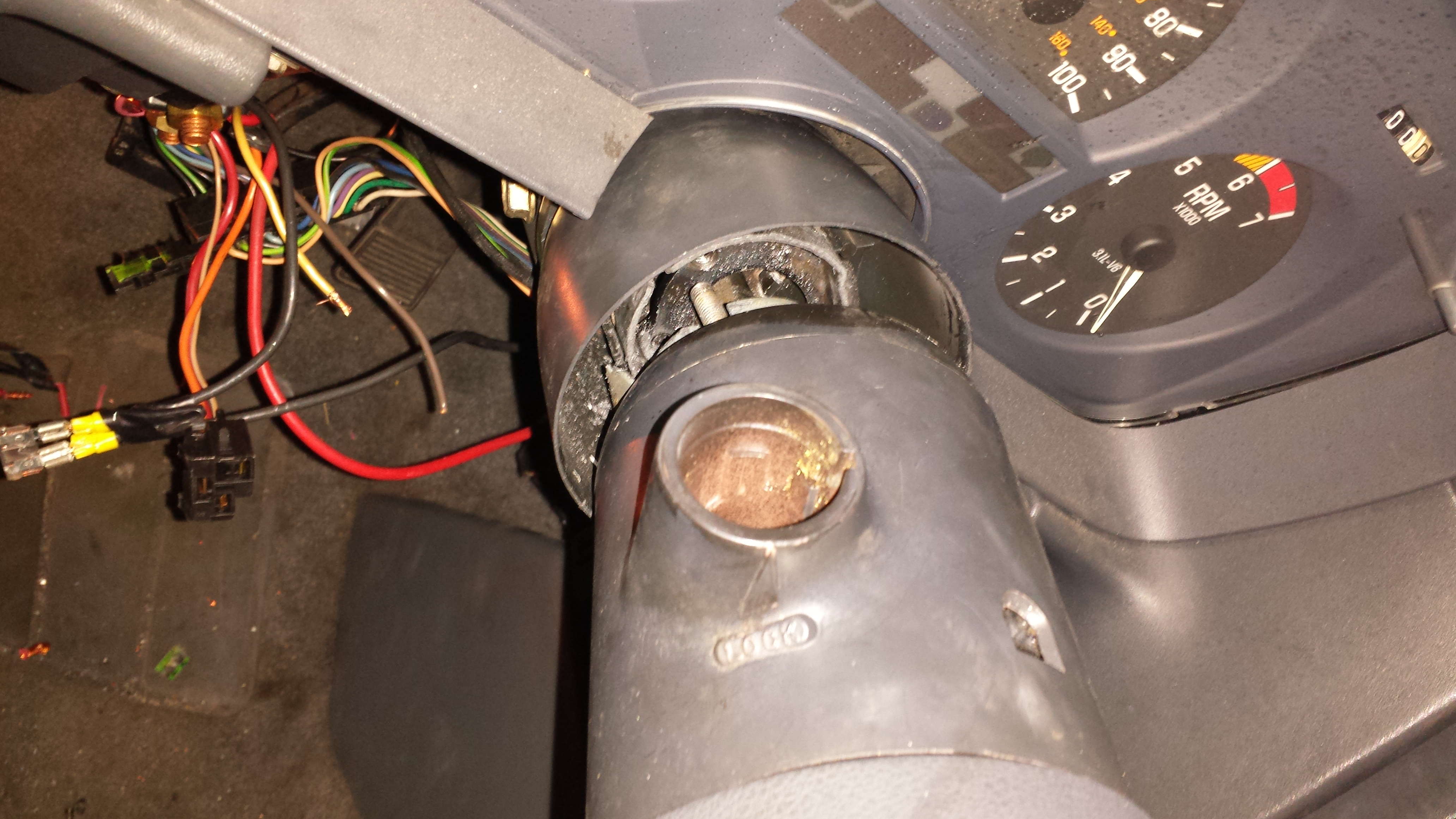

How to remove cover off of the steering column?
Heh... good ol Saginaw column... you have to take the whole damn thing apart to do anything with it.
Have fun!

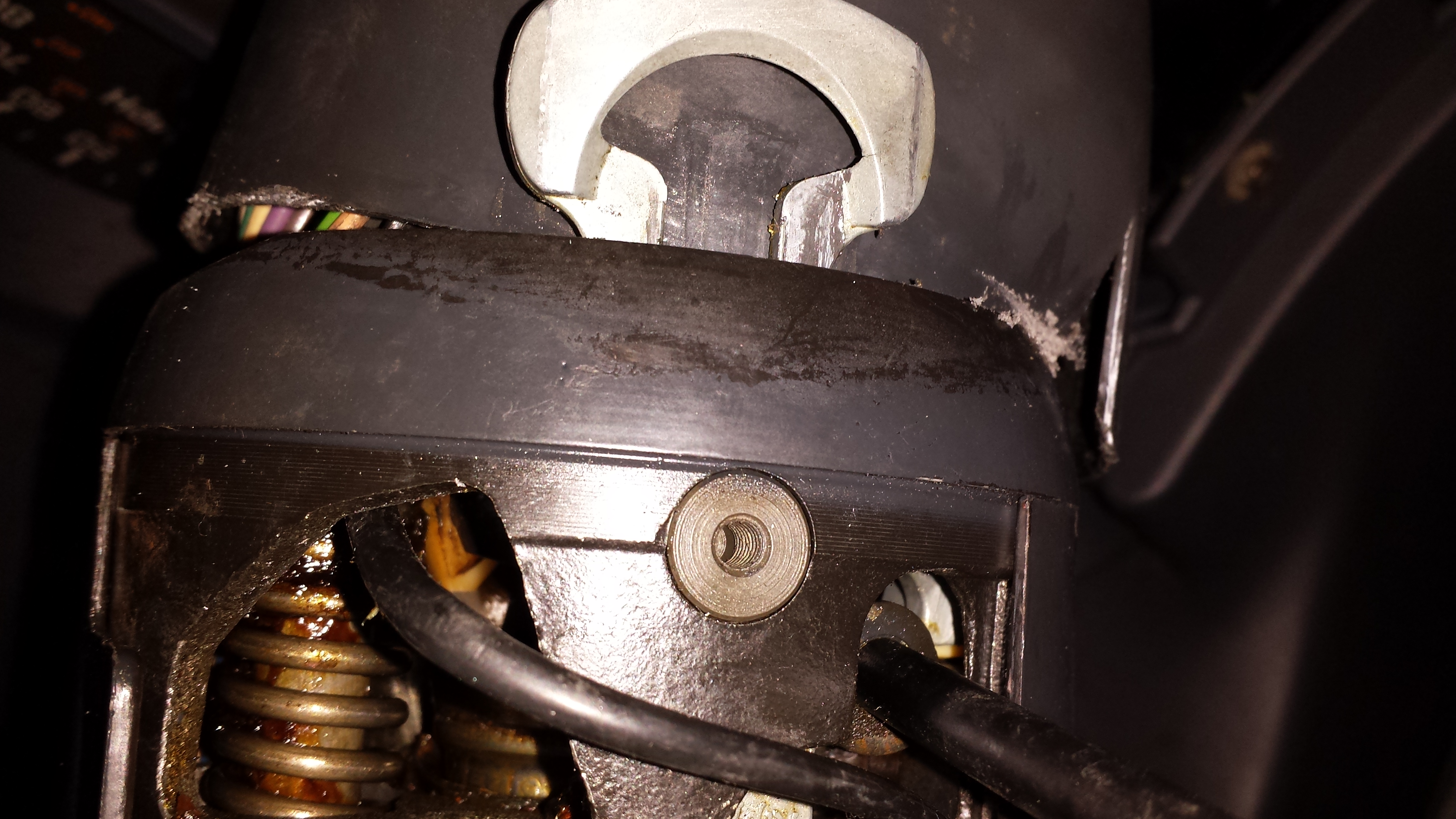

Making good progress on the bench, I never thought I'd even get this far so I'm thrilled!
