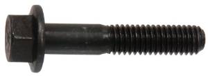

    (6) The Hillman Group 44079 M10-1.50 x 70 Metric Flange Bolt, 4-Pack for bolting the hoist to the Base/Wheels @ Amazon $13.60

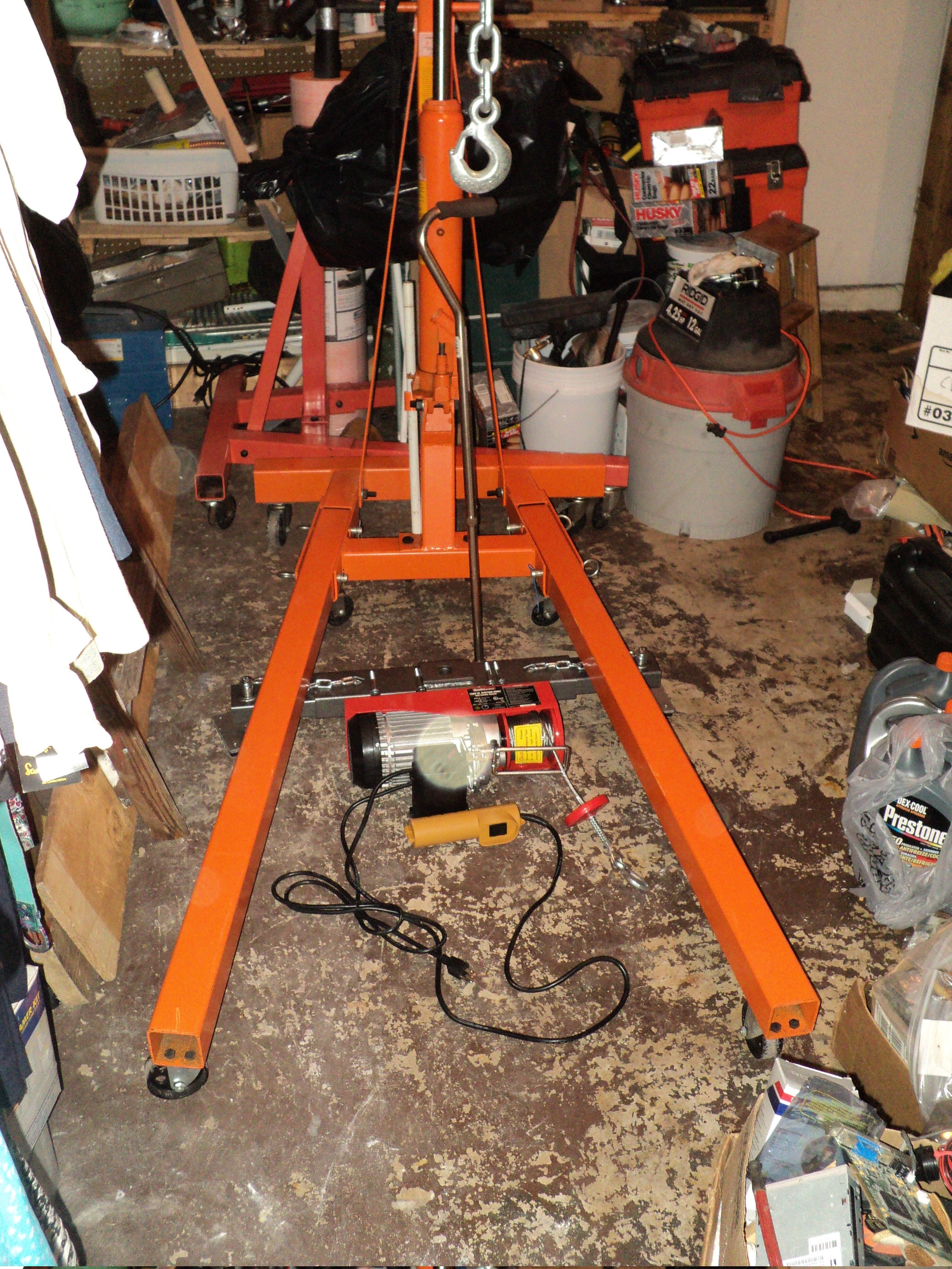

    Ladies and Gentleman... Without Further Ado... I give you... "The FrankenLifter" ....LOL
    COMPONENTS:
    All from Harbor Freight Tools in Largo, Florida
    2 Ton Hydraulic Lift (This the Primary Lift and it Remains UN-MODIFIED)

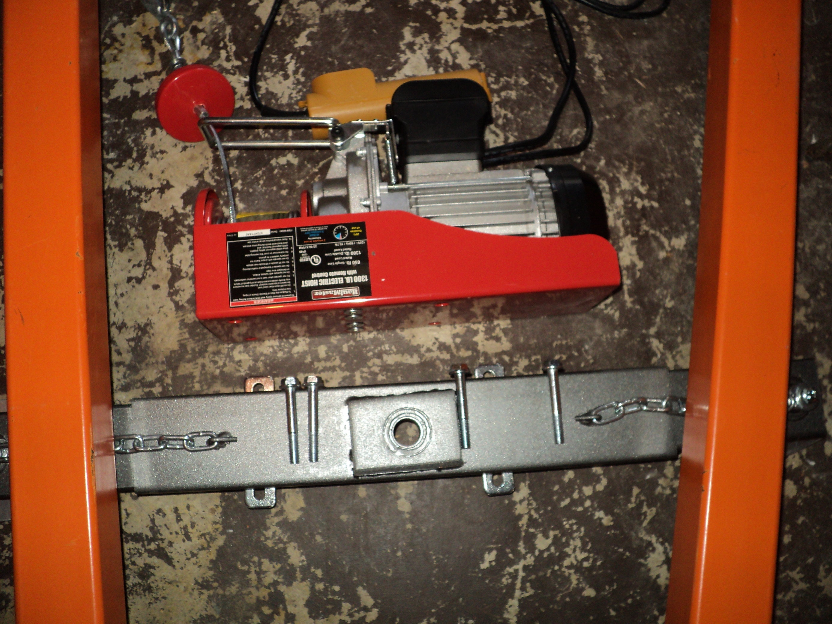

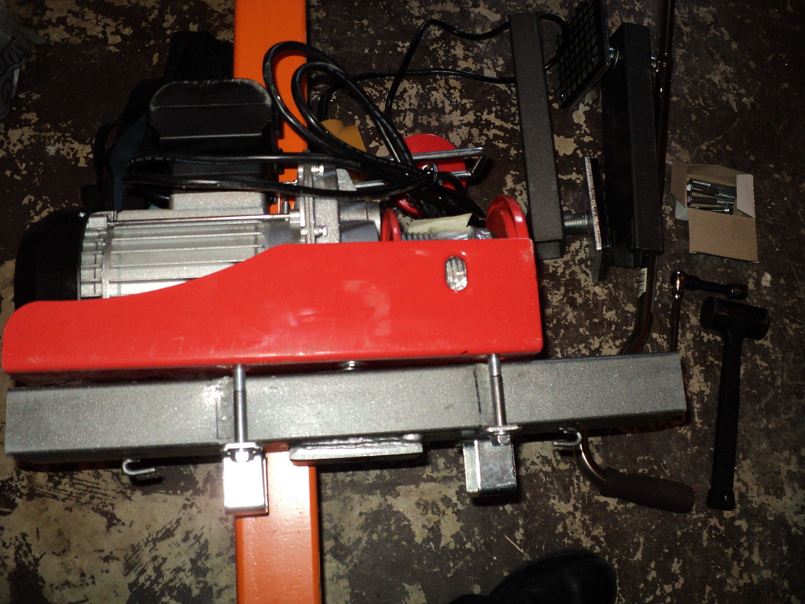

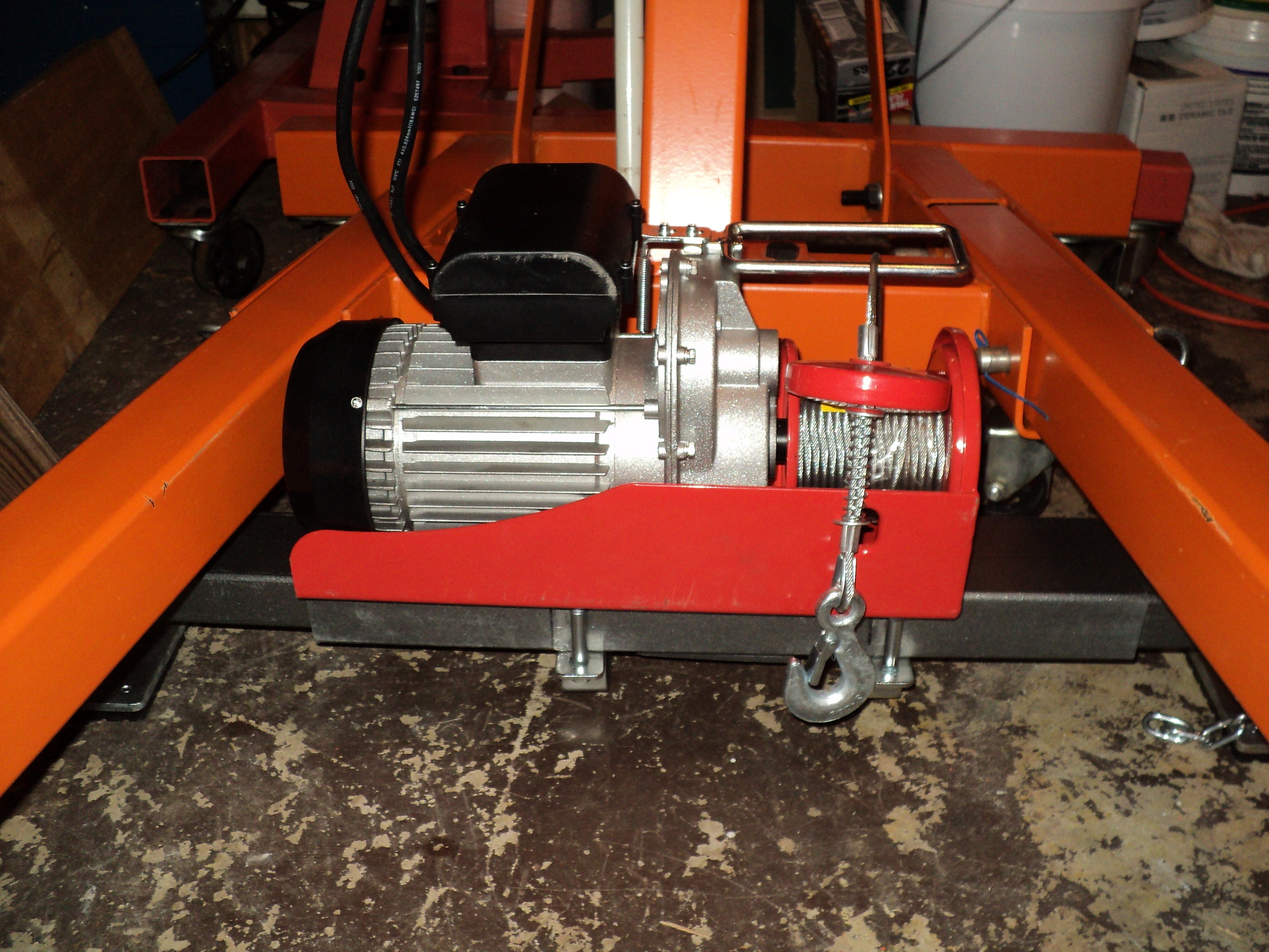

    1,300 LB Electric Garage Hoist (Bolted over the 2 ton Cross-Beam with adapted HW-4-Longer M10 X 70 Bolts and 2 factory brackets)
    2 Ton Pittsburgh Floor Jack Cross-Beam ( The beam is disassembled with the center square tube inverted and then all 3 parts combined)

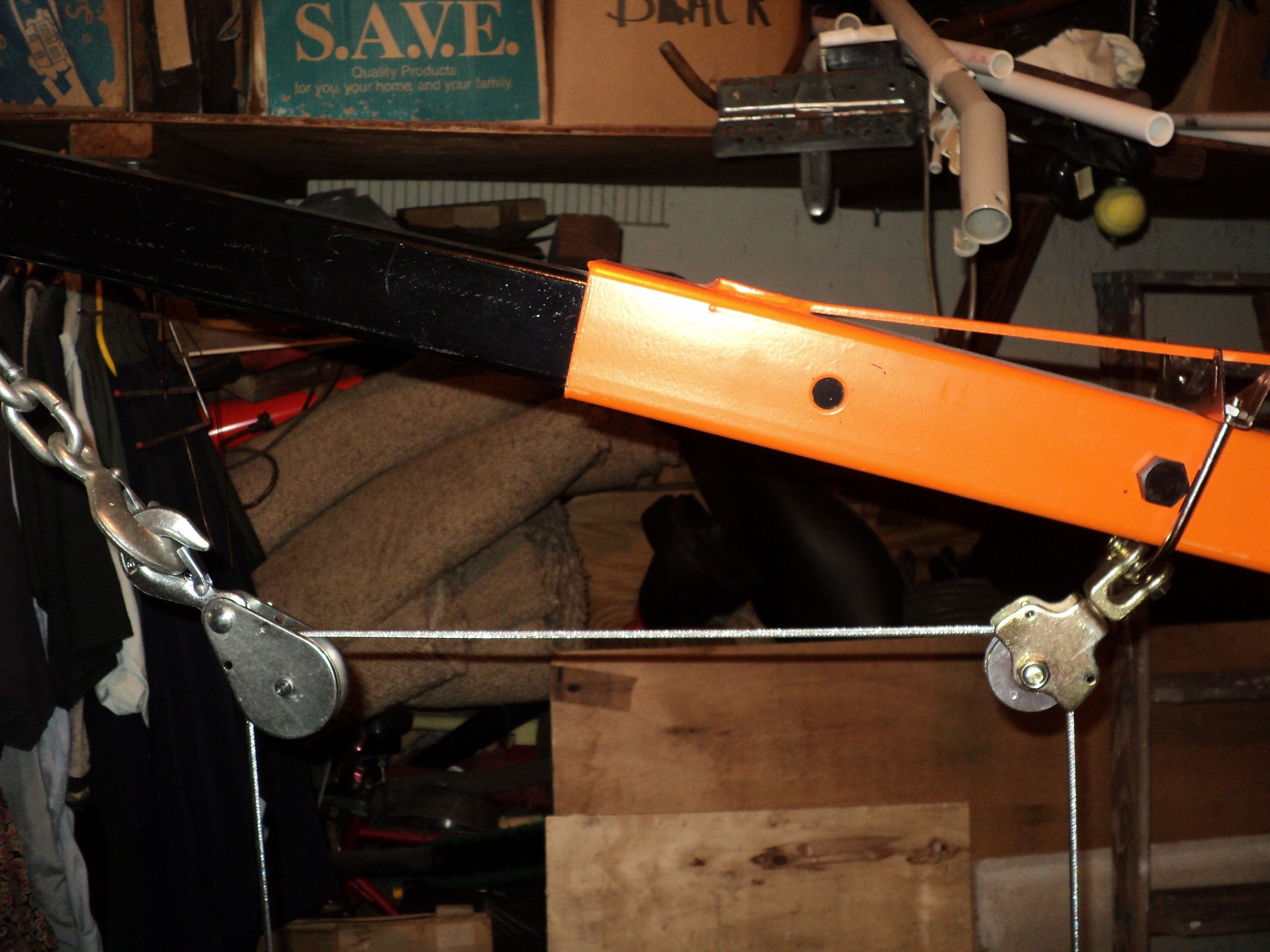

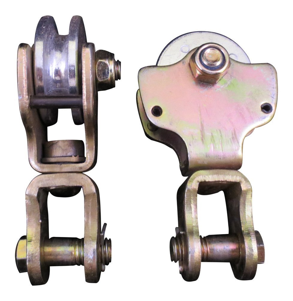

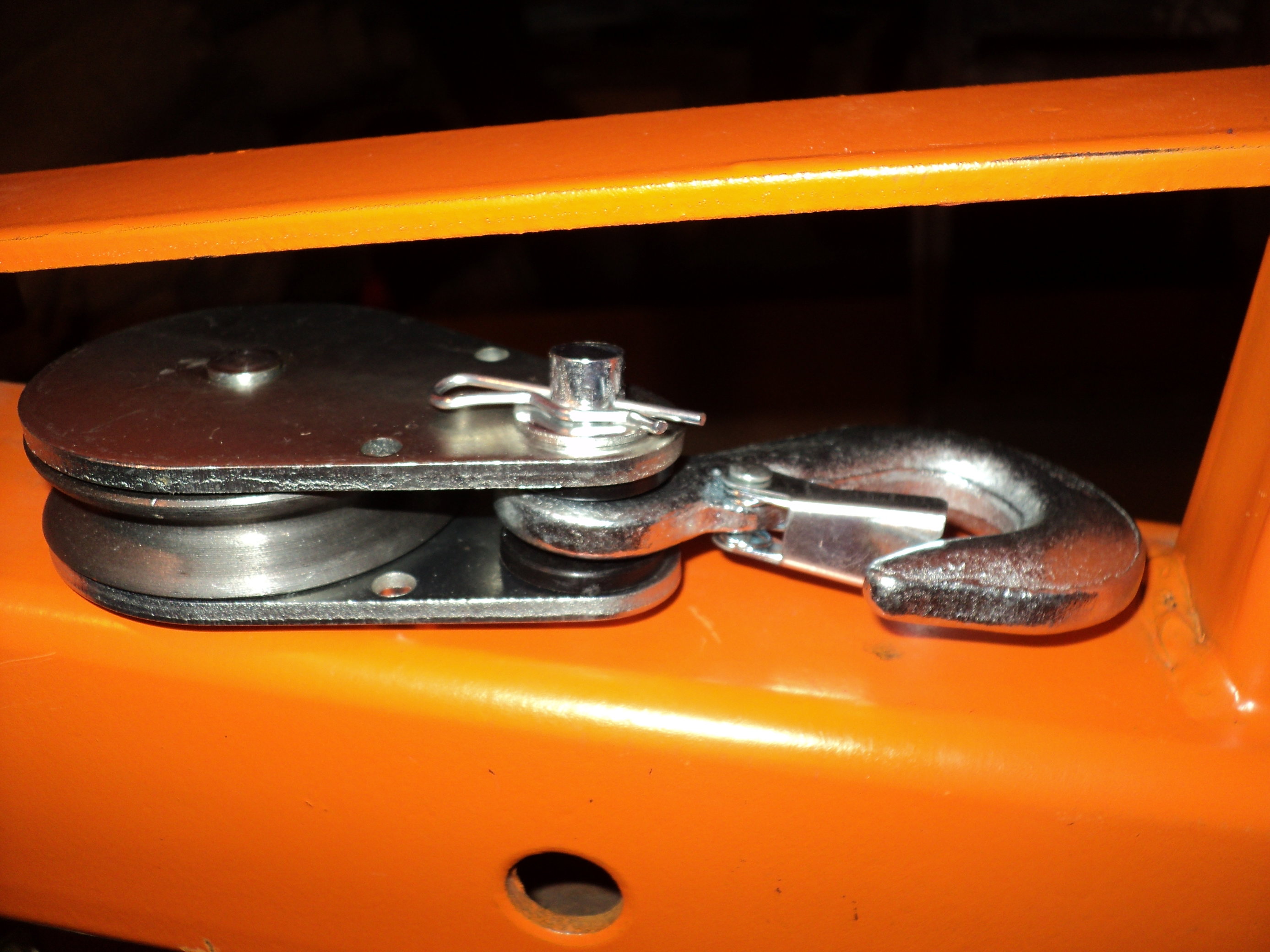

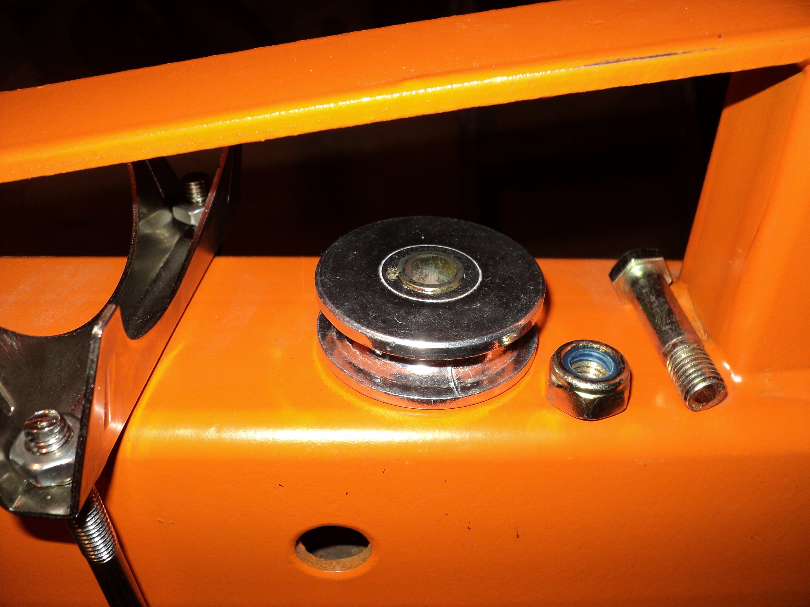

    2 High Quality Pulleys with hardware allowance for dis-assembly to introduce the steel cable
    Some Basic Tools

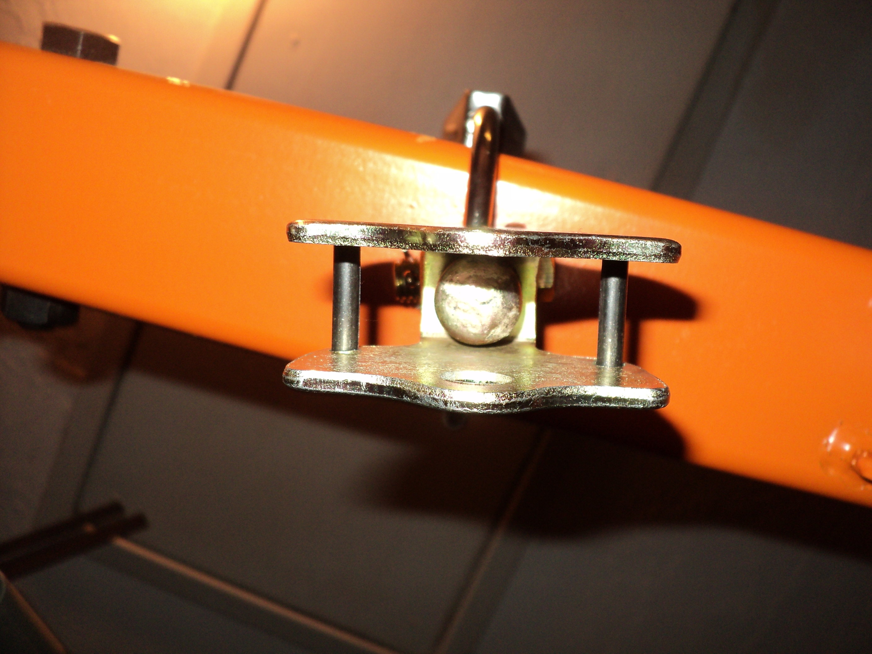

    Stainless Steel Large U-bolt t(To provide a pivot point at a Right Angle to the Electric Motor and fitted in front of a Large Cross Bolt)
    Now I can pull the Trailblazer 4.2L Engine Head with micro-control and support items like the heavy cast iron exhaust manifold or... lift the front of the engine with ease long enough to pull out the motor mounts and drop in new ones... and NOT wind up getting injured again.

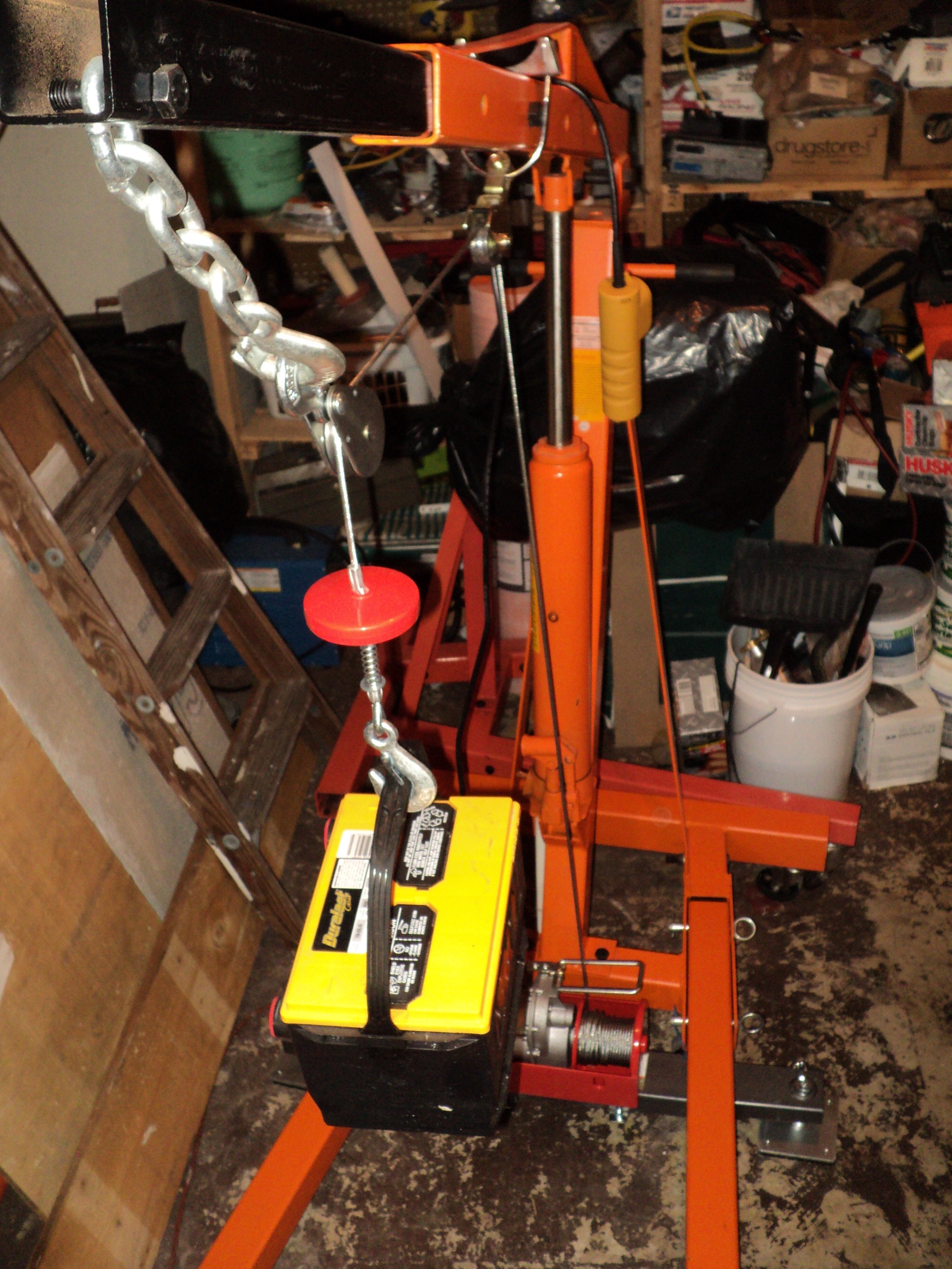

        Okay... I finally was able to play Garage Rubik's Cube well enough to make the necessary room I needed to finally test out "The FrankenLifter". I conducted a pretty good series of very successful tests and I observed some issues regarding Common Sense Safety that I will address below. I posted the 42 additional images on my Photobucket at this link:

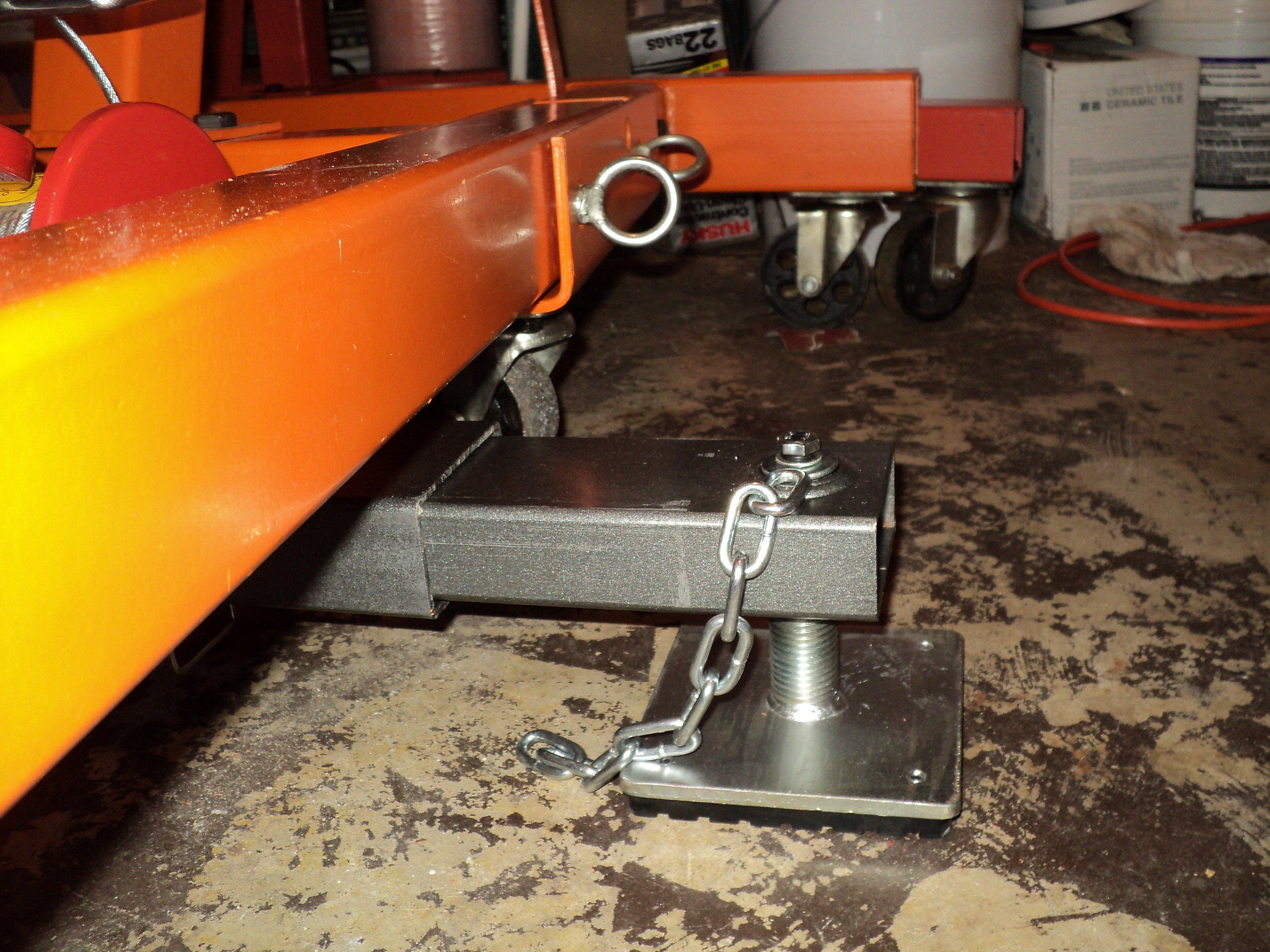

          I have made some additional modifications to "The FrankenLifter Hoist" since its original design.and posted more complete demonstration images of it in action while being used to lift a bare GM 1995 Lt-1 350 Engine Block. My investigation of its performance under a variety of lifting conditions requires that I post this Important Safety Warning mentioned here for anyone contemplating using this or any similar design and hardware they can build as follows:
          When using the Electric Cable Hoist Portion for Hoisting... Should it become necessary to Elevate the Lift Arm Hydraulically to an Increased Angle... it is imperative to LOWER THE LENGTH OF THE HOIST CABLE BEFORE JACKING UP THE HYDRAULIC LIFT ARM...and the safest way of doing this is to lower the Hoist Cable Hook DOWN to a Minimum Distance from the underside of the Pulley attached below the Lift Arm by at LEAST ONE FOOT (12")...!
          The Reason for this Precaution is that without adding in AND MAINTAINING the additional Minimum Length of 12" of Hoist Cable... it is possible to raise the arm with sufficient Hydraulic Force to actually PULL THE HOIST CABLE HOOK OFF OF THE CABLE...! As the Lift Arm is Raised... the Cable distance is DECREASED UNTIL THE HOOK BOTTOMS UP AGAINST THE LIFT ARM PULLEY. The Lifting Force of the Hydraulic Arm is 2.5 Tons...and could easily Rip the Cable Hook from the Electric Hoist Cable if it is allowed to do so with Catastrophic Consequences...!
          If this were to occur when there is any weight attached to the Hook... if the Cable Hook-to-Cable connection was to separate, the object would fall suddenly and there is the obvious risk of being crushed or injured if a person or parts of their body are under the weighted object during such an event. In another scenario...even if no injuries or death occurred... the elevated object would certainly suffer damage or destruction.
          Some astute observers among us may note that a few of the latest images displaying the L-Support Arm on the 1,000 Lb Engine Stand show that it appears to have been installed BACKWARDS. You should know that as soon as I observed this, I employed the ease of using "The FrankenLifter" to lift and hold the bare V8 Engine Block with the attached Engine Stand Bracket... while I immediately corrected and rectified this problem.
          I AM ALSO RECOMMENDING THAT A SECONDARY LOAD SECURITY CHAIN BE USED TO SECURE THE OBJECT BEING LIFTED AT ITS FINAL ELEVATION DIRECTLY TO THE STEEL SUPPORT ARM AND COMPLETELY ELIMINATE ANY CHANCE OF THE OBJECT FALLING DUE TO EITHER A FAILURE OF THE HOIST CABLE/HOOK... OR A LOSS OF HYDRAULIC LIFTING FORCE ON THE SUPPORT ARM.
