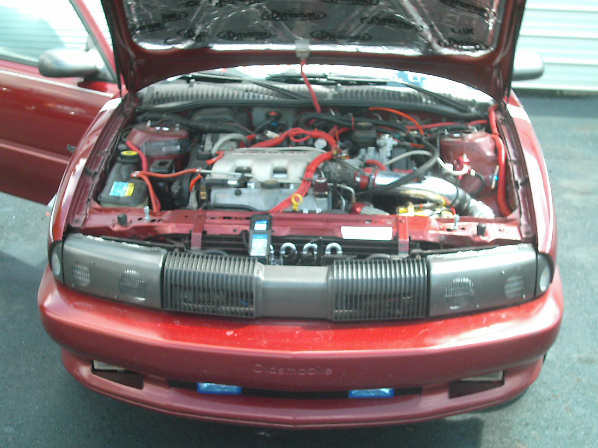

hey fellas.. ?? is there anyway possible that i can get detailed instructions and/or set-up for remote mount turbo..i have and olds acheiva with nitrous on a 3400 swap i did , runs great other than planning to upgrade heads, bad valve..help will be highly appreciated... my baby runs 14.6 now on 86 shot nitro dry kit but changing to wet kit after heads are replaced and possibly remove entirely if i get all the info i need for the turbo..thx...
possibility of remote mount turbo

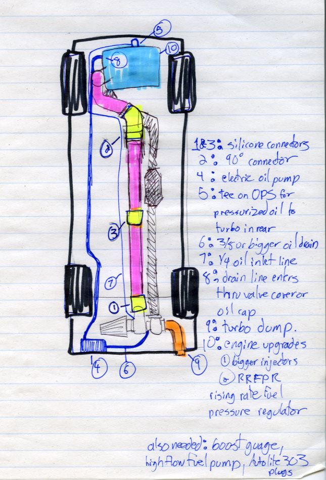

this site is one of the 1st to do the rear mounted turbo. noting out of the ordenary for turboing the car. just where its placed and it also requires a OIL return pump to push the oil back from the turbo back to the engine. hope this helps. pretty simple setup just allot of piping and oil lines.

see www.khturbo.net for info on how to do it yourself. I fabbed a system just like his using a slightly larger turbo
i agree..i just put one on my corsica about 2months ago and go alot of my info and design for that siteOriginally posted by gboogie99 View Postsee www.khturbo.net for info on how to do it yourself. I fabbed a system just like his using a slightly larger turbo1994 Chevy Corsica. Parted out. Just a rotting shell now

Rear Mounted Turbo
I have a 3400 rear mounted t3/t4 50 trim set up on my 94 5 speed cavalier. I have only ran the car a coulple days after i completed the setup. I ran a 13.8@104. I was running 6psi boost stock fuel pump stock everything including computer etc... when the boost came on the car was hitching then getting up and going again so i was running 2.4 60ft's.
Since then i'm running the stock computer at 8 psi non intercooled. with an adj. rrfpr with 255 ml/hr. fuel pump 2 bar map sensor 36 lb/hr. injectors wideband and boost controller. The car now walks c5 vettes on the highway. The car is probably good for a high 12 to a low 13 sec. quarter. If the car doesn't sell i'll be intercooling it and tuning it a little better along with a bully clutch because the centerforce dual friction can not take it. I turned it up to 10 psi the other day and it burnt the clutch all the way through 3rd gear.
The car hauls! for a cavalier you can NOT complain! Follow KHTURBOFAB 100% and i promise you will not have ANY problems what so ever. If you have an issue he kenton can be found on v6z24.com and he'll answer any and all questions you have he's a great guy!

i got alot of my info from kentons site
alot of the cavy guys are also turboing 3400s
