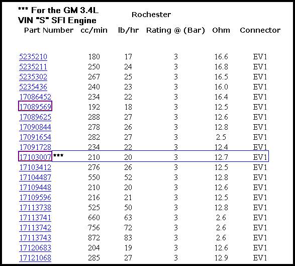

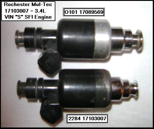

I have a 3.4 pushrod Firebird. It is bored .020, cammed (specs on site), with a forged bottom end. When I did the motor work, I upgraded to 19lb injectors. I had the car tuned last winter (mailed it out).
I found a Force Fed Fab turbo kit for my car. Running at 6 - 7 PSI, will my injectors be enough?
Will my tune be good enough for light boost?
The kit comes with an FMU and I am augmenting the kit with a wideband sensor. Will my tune be good enough?
