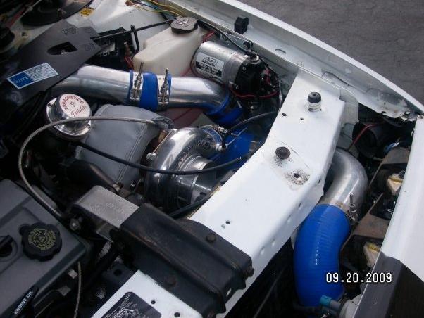

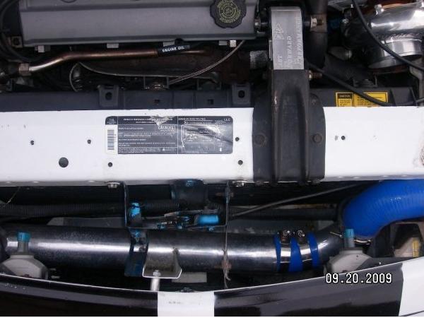

I saw in your list you had an intercooler pipe. Where did you put the intercooler, I didn't see any of the components in the picture... I am guessing you have one anyway with 11psi

Congrats Jake, you are one of 4 that I know of on the forum now with a 3.4 DOHC boosted in a W. Tim, Shane and I are all running boosted 3.4 Auto's, its great to hear a 5 speed. I know on mine it spools around 3k and man it pulls hard. I am looking into more power here shortly, well see though.
Mark-OEM
Thanks, ya these motors just love boost, i think im gonna turn mine to 14psi, max out the 2 bar lol fine tune it and then ill be done with it, the car already has absoulutly zero traction as it is, and with no traction its still getting 13.8 in the 1/4 @ 107mph. i know if it can get it to hook and get my 60 ft down i can get it into the 12's . ill have to scan the slip, but for now ill just type the numbers out from the last time i was at the track just before i exploded my axle:
